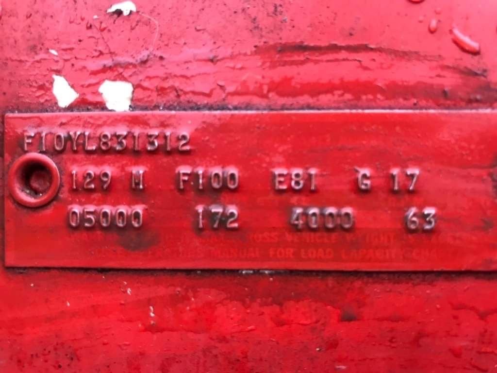

I’m not sure if he still does it but I remember a while ago seeing number dummy helping folks on here to decode their warranty plates. I have 2 ‘66 f100’s I’d like decoded but have had some trouble finding the information myself. Can anyone help? Thanks!

The only ones I can't figure out are the body codes and dso codes. If you could help that would be great
1966 / 381: 3 = Medium Green Crush Vinyl & Medium Green Wicker Pattern Vinyl / 81 = 81A Standard Cab
36 = Louisville KY Ford District Sales Office, where the original selling dealer ordered the truck from.
1966 / E81: E = Red Crush Vinyl & Red Cody Pattern Woven Plastic / 81 = 81B Custom Cab.
63 = Memphis TN Ford District Sales Office, where the original selling dealer ordered the truck from.
