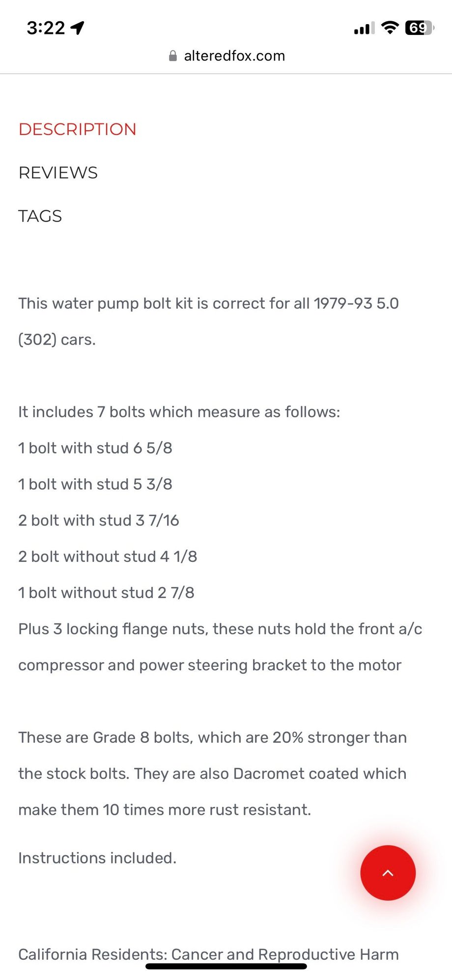

Some company called alteredfox posted these dimensions for their kit. It’s for a 302 not sure what you have. And then there’s the dimensions from the photo blazerman posted. Whatever bolts are in good shape you have, try putting them in diesel to clean

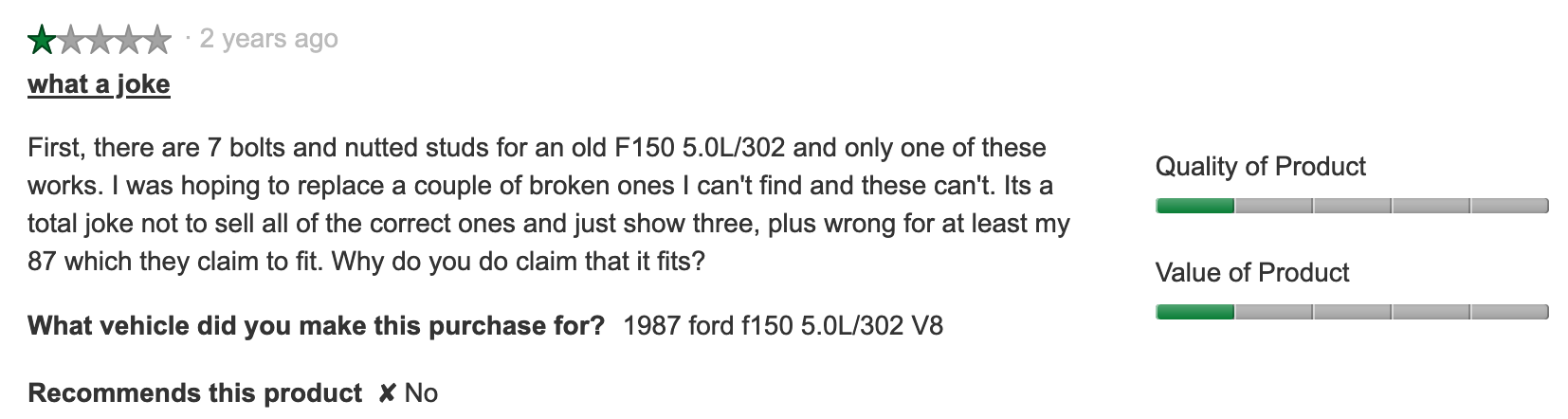

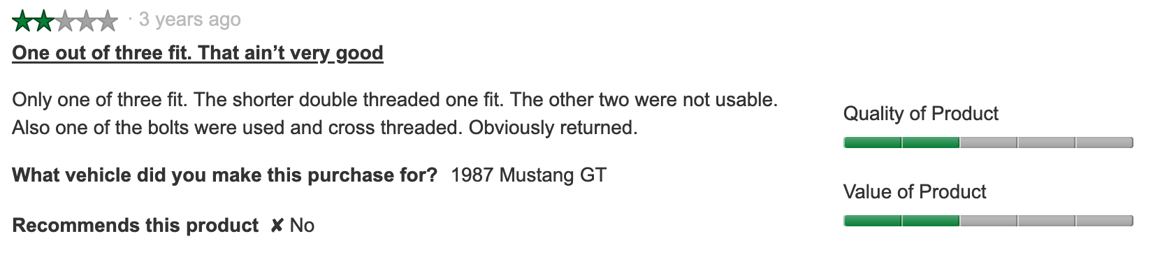

Thanks for sharing but those seem to be the Dorman HELP! 23744, which I've also found at AutoZone, O'Reilly, NAPA, ... but they get consistently bad reviews and seem to not fit:
Thank you for the pointer though, maybe I'll give them a try since it's not that expensive.
