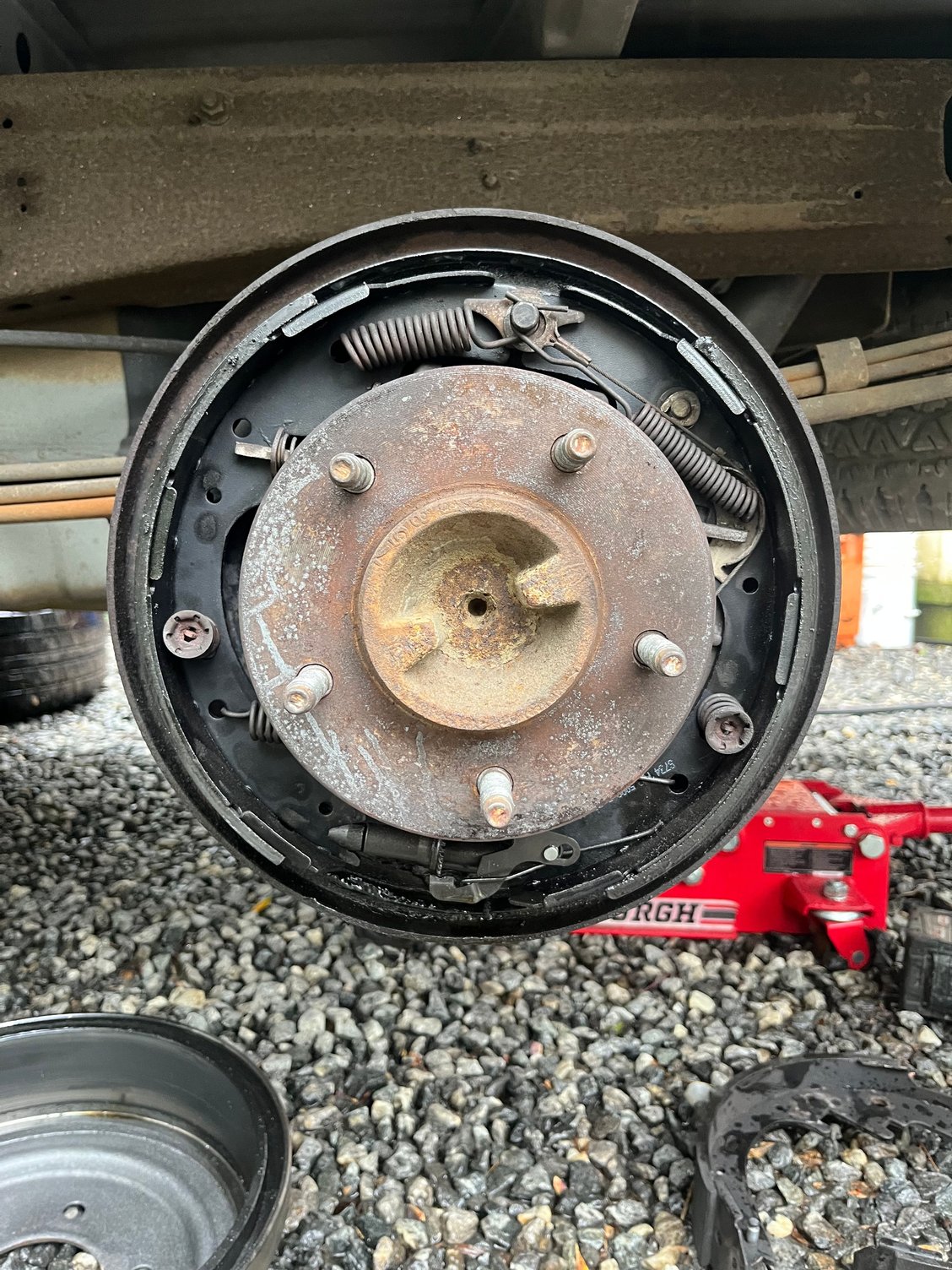

Okay so I have it apart. It’s really hard for me to tell a difference between the shoes.. the one that I currently have towards the front look like they could be a little longer. I also notice a thickness difference but that’s it. To flip them around the opposite way I’d have to flip everything- the side the adjusters are on, the way the adjuster cable is routed, stuff like that.. am I okay to do that? Will it work fine? Do I somehow have the wrong shoes? Here’s a pic from the driver side with how I currently have it.

Update to add I found the old shoes and compared them to what I have now and they are oriented the exact same way the old ones were. Customer never had an issue out of the rear brakes (until they went metal to metal obviously) but it’s been a few years since he last had them done so obviously they weren’t locking up before hand. So my thought is maybe the wheel cylinder is sticking just enough to keep pressure on the shoes and slowly adjusting out which is why he only has this problem every after about a week of regular driving. It’s definitely adjusting it out, last week when I messed with it I ran the adjuster all the way in and left it, and today when i pulled it apart the adjuster was ran out probably 5-6 turns. I can’t think of any other reason why the adjuster would be turning.

Another update.. found a forum with a similar issue.. one wheel locking up after driving it and adjusting, and his adjusting arm was tweaked.. turns out it looks like the adjusting arm is tweaked on both sides so just gonna put new hardware in it and see what it does

Sorry it took me so long to reply.. I can't find it now because it was just suggested under my forum. The adjuster arms did end up fixing my issue though.
