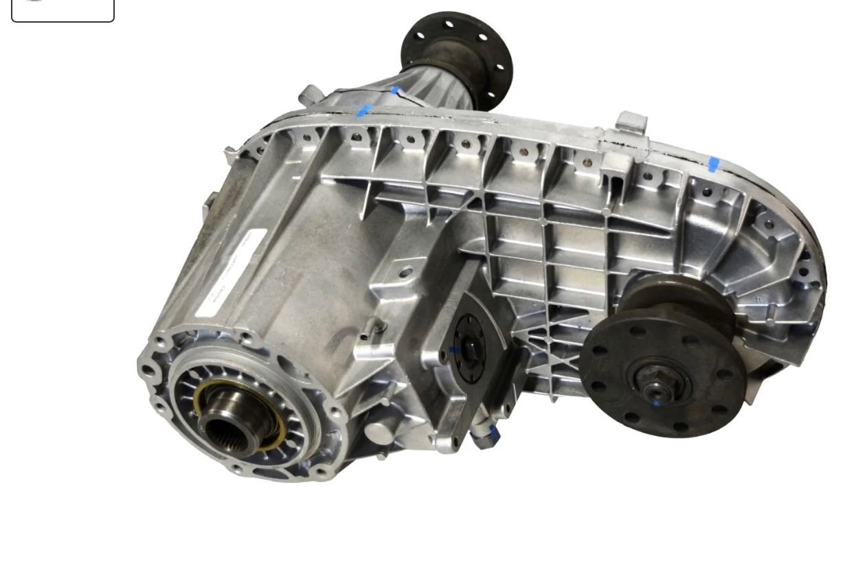

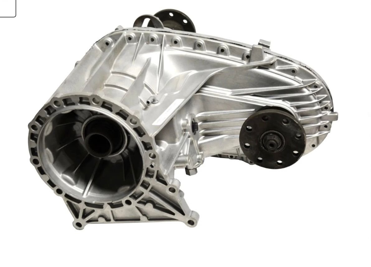

Thanks guys, but I think I phrased my question wrong. I’m trying to figure out if the 6R140 ever bolted up to the old 6 round bolt pattern or does it just bolt up to the later stlye 11? bolt
