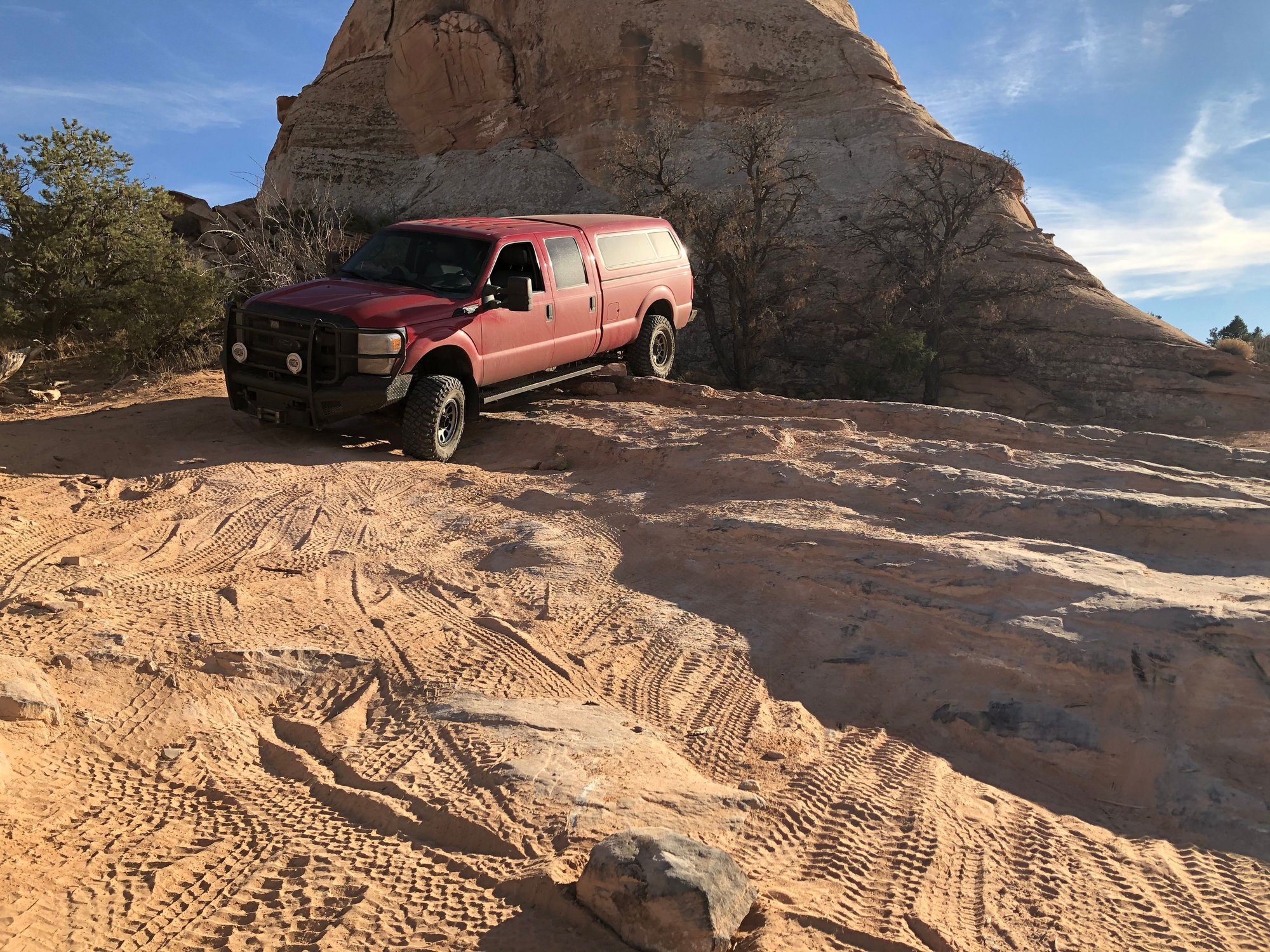

spotted the op. sorry he cant go far at all in that setup
