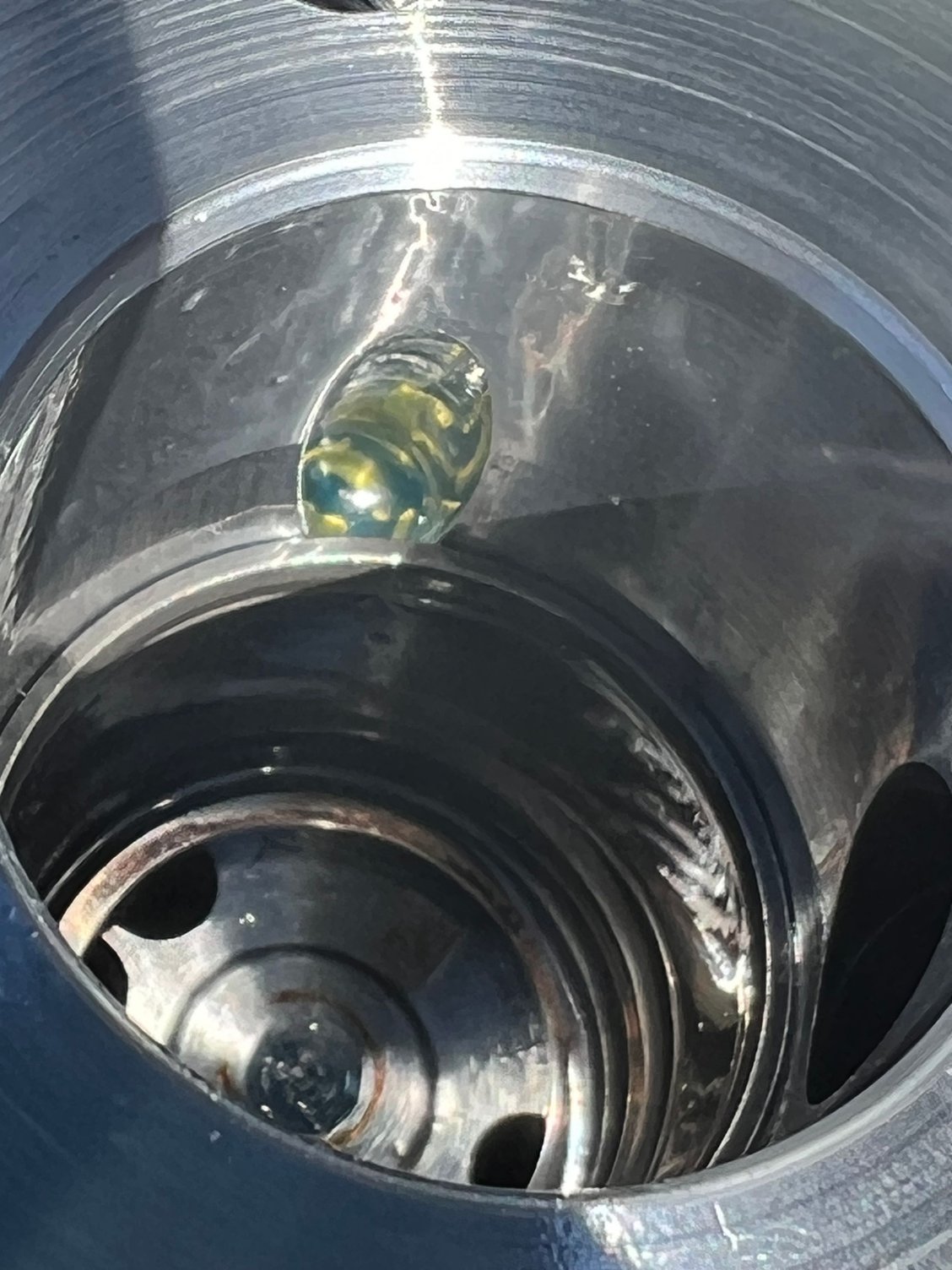

Originally Posted by speakerfritz
Bosh did build it, and ford is using it in 2020 and later for 6.7’s
i just took one apart and it is definitely pinned.
so if you have a 2020 or later…don’t buy this…you already have it.
Bosch pinned the lifter buckets but they didn't do the feed port mod like RCD did...

So if it has a built in DPK as the website says…then it has to be a gen1 type of DPK and not a gen2 type. Which means…it will quickly clog up and cuase the fuel to take the original serial path..if it’s modeled after gen1 type dpk’s.

I'm not saying I agree with the concept of the CPX CP4, because I don't, I was just pointing out they had internally changed the feed port... I agree with you.
