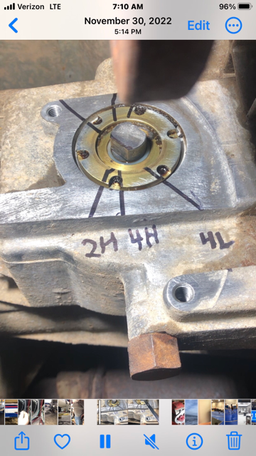

If you have the ESOF, it is possible the transfer case has slipped in between the 2h and 4h into a "neutral" spot. Happened to me on my 2000 7.3. no codes, no nothing, but will grind on the park dog leg if you dont shut it off first before placing in park. Theres plastic guides in the transfer case that wear out and allow this to happen. The transfer case sensors wont pick that small of a movement up, so no 4H light. Youll need to remove the shifting motor and base , then put the truck solidly into 2h with a 9/16 wrench. I ended up just going to a manual shift t-case....Trying to keep it simple. Good luck!

So, you can find the plastic guides on ebay/amazon but youre going to have to entirely disassemble the tcase to replace them. Not a bad idea to keep a 10mm socket and ratchet and a 9/16 wrench handy, just in case the 2H-4H-2H routine gives out on you. If you look on the shifting fork you can see the plastic guides. Be safe out there!
