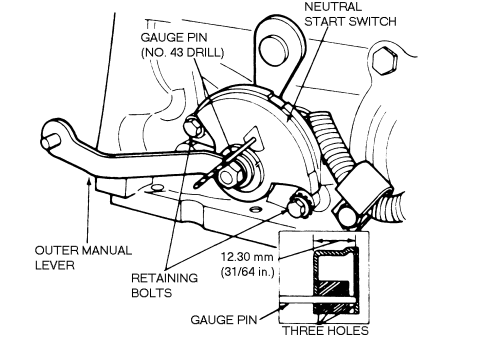

Start with a new column bell, and see what that does for tightening it up. The neutral safety switch may need some adjustment, as well.

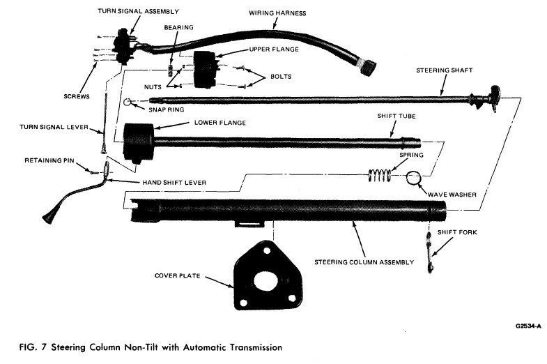

X2 on order the parts to rebuild it. Get a new lower steering column bearing. https://shop.broncograveyard.com/197...EaArBLEALw_wcB
Or the DRB Fab bearing: https://www.ford-trucks.com/forums/1...rovements.html
I bet the lack of starting in only neutral or not at all is because the steering column internals are worn out and that translated down to the NSS switch on the side of the trans.
NSS on the dvrs side of the trans. Your NSS IS NOT ON TOP OF THE COLUMN.
Yes this is for a tilt wheel, but gets you in the ball bark with fairly good seats.
