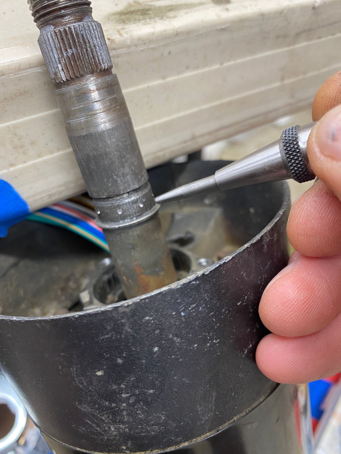

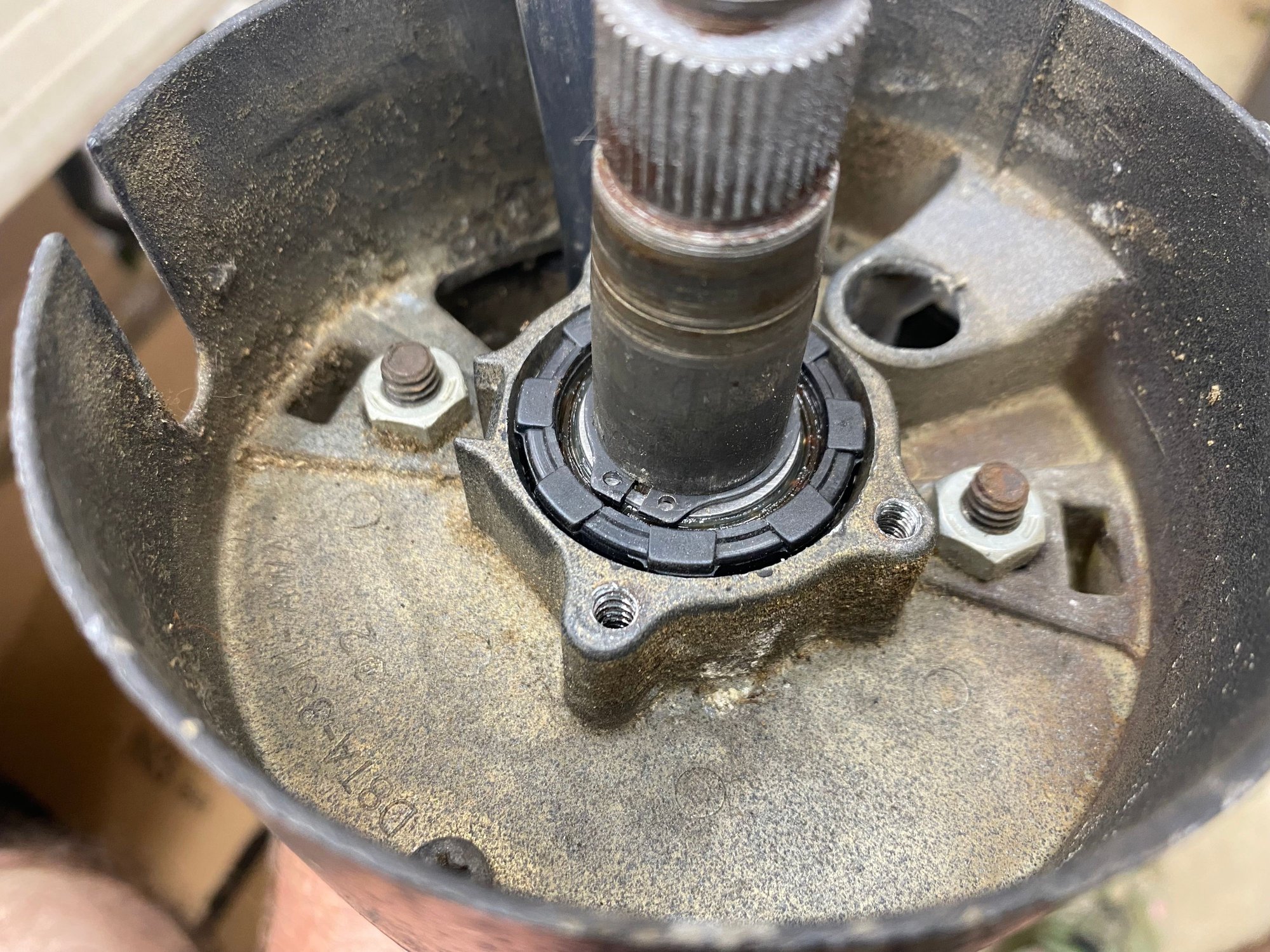

A few weeks ago while I was installing hydroboost, I installed a new DRB Fab lower steering column bearing. My old factory bearing was shot, so this was a big improvement. But I still had a bit of slop at the upper bearing which is just below the turn signal switch. I anticipated this, and already had a new OEM type upper bearing. I installed it, but the little bit of slop was still there. It wasn't much, but definitely enough to feel it.
The gap was between the inner bearing race and the steering shaft. Since my steering column is removed for the wiring harness installation, I thought about machining the upper shaft down, and pressing on a collar to machine down to better fit the bearing. Then I had an idiot light bulb moment. I used an automatic center punch to make eight evenly spaced marks around the shaft, at the bearing register. Then I slipped the bearing over it to check the fit. Pulled the bearing off, made the marks a little more pronounced, and checked fit again. I repeated this a few times until there was no bearing slop. You could do this with a regular center punch and hammer, but an automatic center punch is nice because you can adjust it as you go. Can't wait to feel the difference while I'm driving the truck.

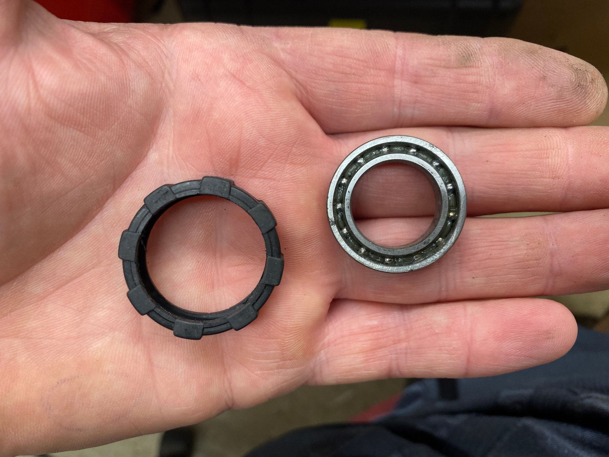

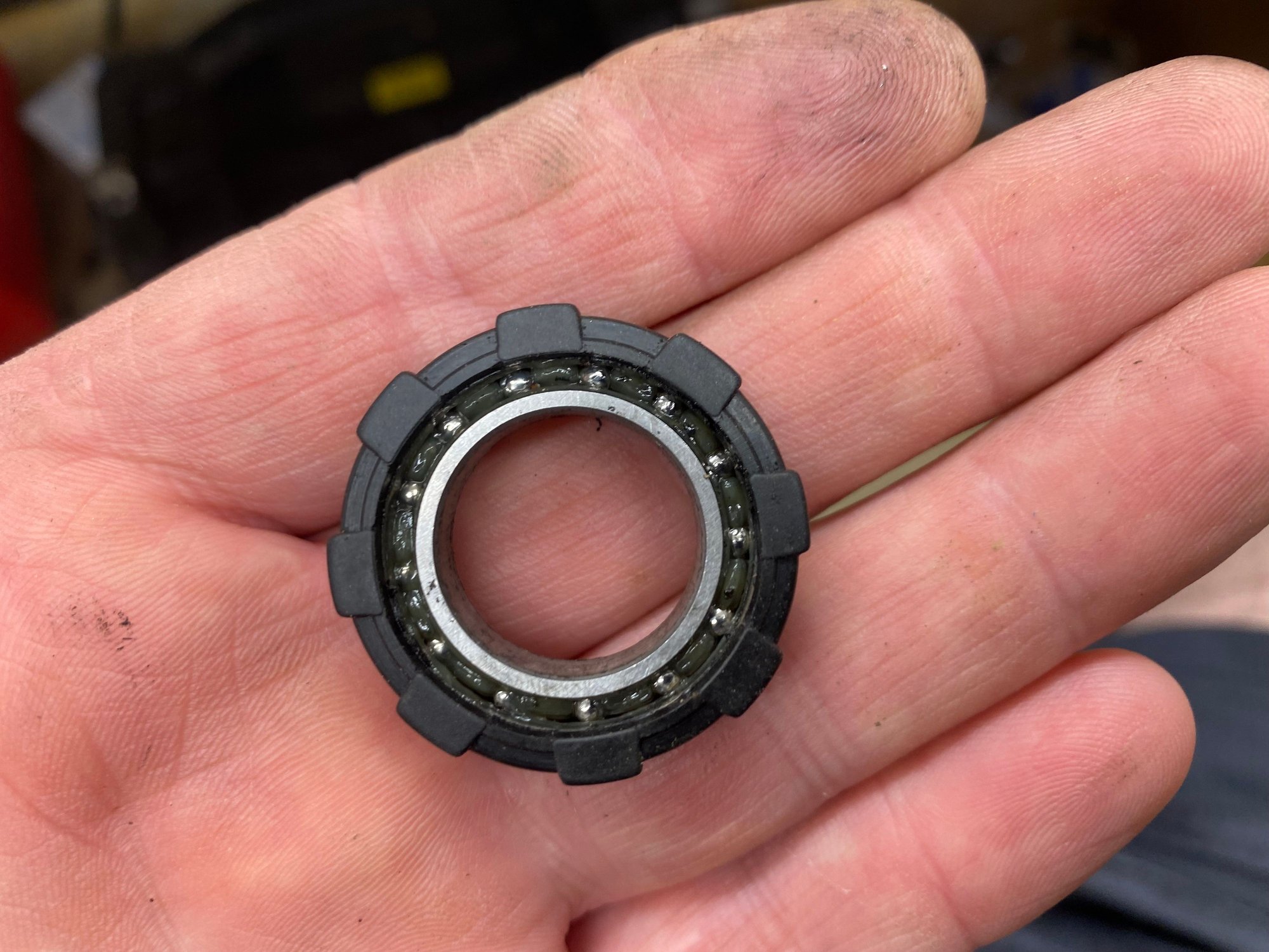

I am considering machining a delrin cup to replace that silly rubber thing that goes around the circumference of the bearing.
This is the DRB Fab lower bearing. Mine fit snug, but if it was loose, it could get the same center punch fix.
