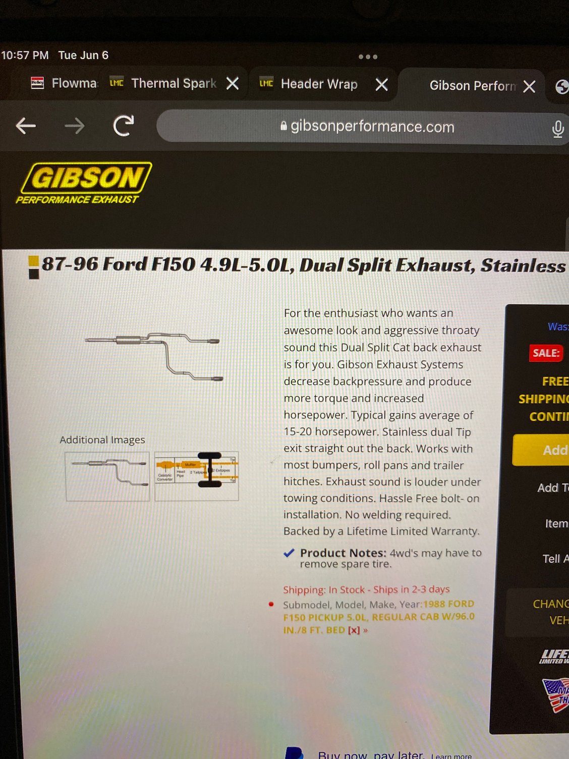

Someone I know said they might be able to get a Gibson half off, how would this sound/perform? I know I’d have to figure everything out from the cat forward I was gonna get shorty headers with 2.50” collector with this exhaust if they can get it half off. And in ca you can’t have bolt on cats I don’t think. How can I get this exhaust system with those shorty headers, and be able to remove and install cat to smog easily?

I wouldn't buy any of that Blowmaster stuff. Also, headers aren't really needed for a stock 190 hp engine and there is no way I'd fool with them on an original motor. I'd just keep the manifolds and have less headaches. If the engine has better heads and a cam etc, my suggestion may change.
The Gibson stuff sounds nice with a mellow burble and some growl when stepping on the throttle, but with both stock cats it will not be all that loud.
