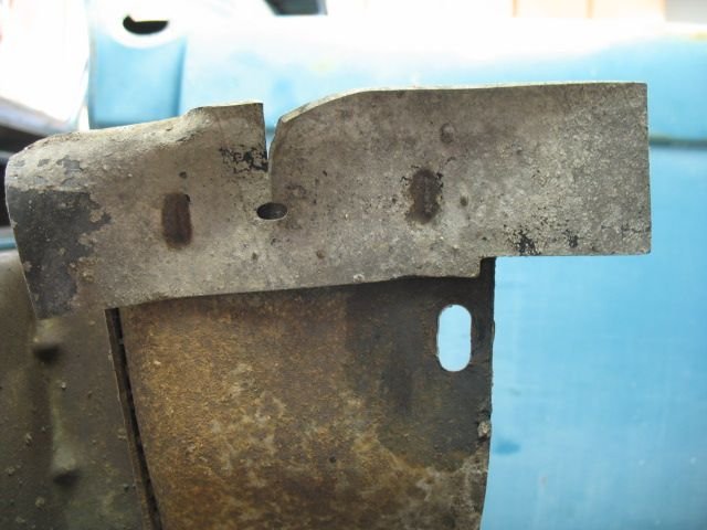

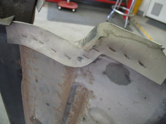

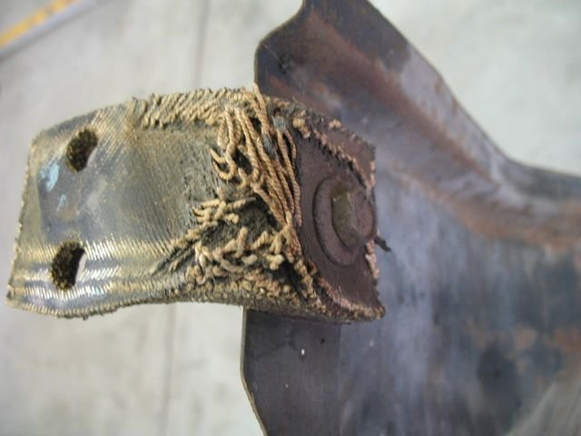

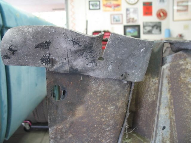

...not hard to make. Just find some neoprene sheet about 1/16 to 1/8" thickness. Cut your own using photos and the existing staple holes as a template. I think I have some photos of my originals that I'll post. Those should help you make a template....all straight lines, some slots and a hole punch. I just make staples from construction staples or heave stainless wire. You can glue the seals to the fender liner and/or clamp them on, drill a pilot hole and fasten with your hand-made staples. I wouldn't use inner tube. It's too thin and you'll suffer the curve molded into it. Use flat sheet neoprene.

Old Mar 17, 2023 | 04:55 PM
resonateur's Avatar
resonateur
Joined: Jan 2014
Posts: 1,946
Likes: 118
Don't forget, there's also a sponge seal that goes between the fender and the cowl. Those are reproduced. If I had been smart, I would have made a couple sets when I was cutting my replacement seals. It would have taken very little time then. I guess I'm not that smart.

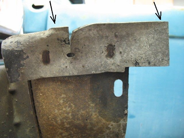

Little known - file this one under minutiae - Ford actually used inner tubes for those pieces that @resonateur shows attached to his fenders. Here's the evidence from one his pictures, but also visible in some of the others. I've downloaded the one and drawn black arrows pointing to the lines in the rubber. Obviously not a perfectly flat sheet, but what are those lines?

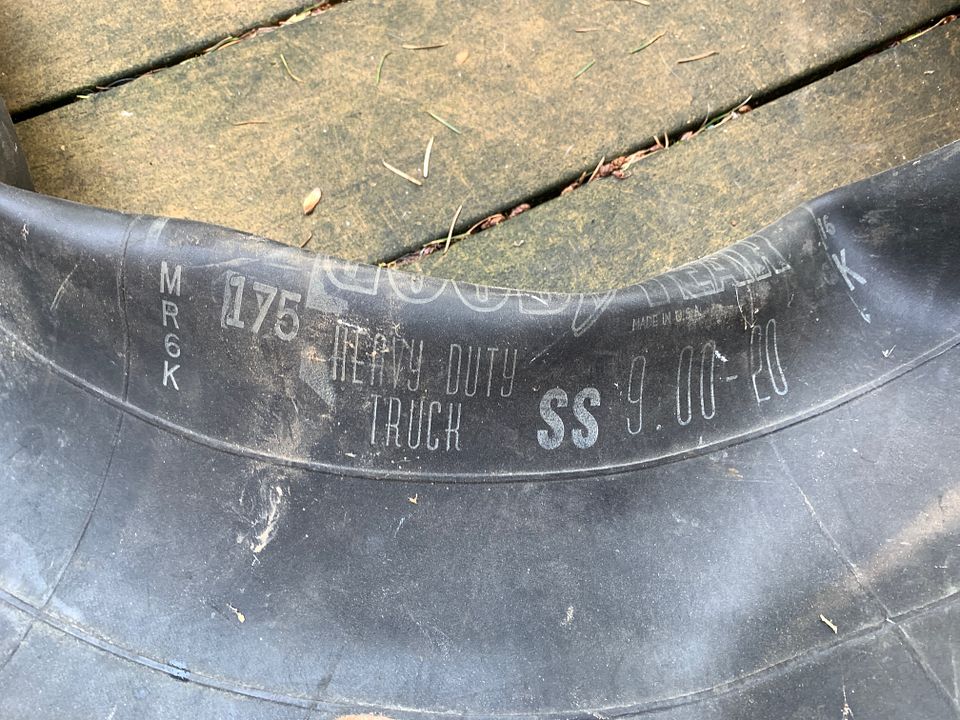

When they say to improvise from inner tubes they aren't talking about bicycle, motorcycle, car or even light truck tires. What they used was heavy truck tire inner tubes. Much thicker rubber and in a size like this Goodyear 9.00 x 20.0 you can definitely cut large sections from it without getting any curve involved. Notice the raised lines in the rubber just like in the pictures posted above.
Ford was just being frugal as was often the case.

Dude....that makes sense now that you show the photos. I only imagined bicycle tubes....I don't know why that was the first thing that popped into my mind. Of course the ones you show would eliminate curvature. I still think, though, that neoprene sheet will be more durable and rigid. Perhaps we don't have to save the pennies that Ford did!!
