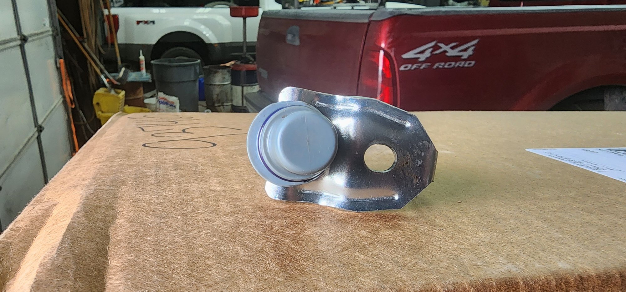

Does the old sensor have the bumps left on its face?
If it does not have bump left then its getting hit by cam gear

here is the motorcraft sensor that almost lasted a day, no cam gear hit.
