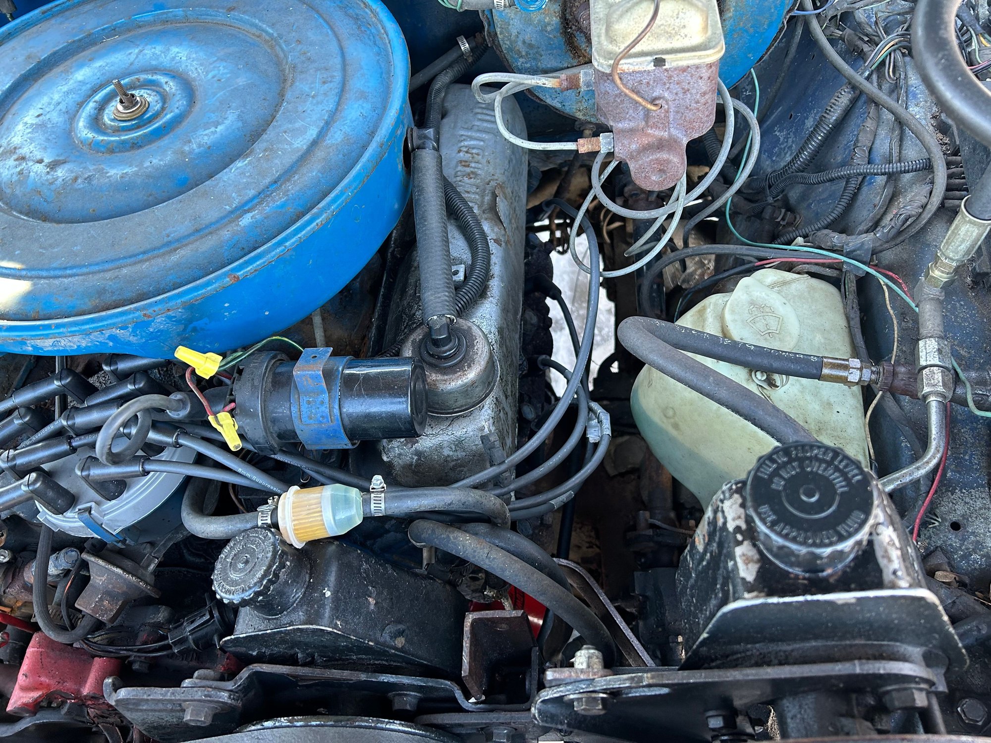

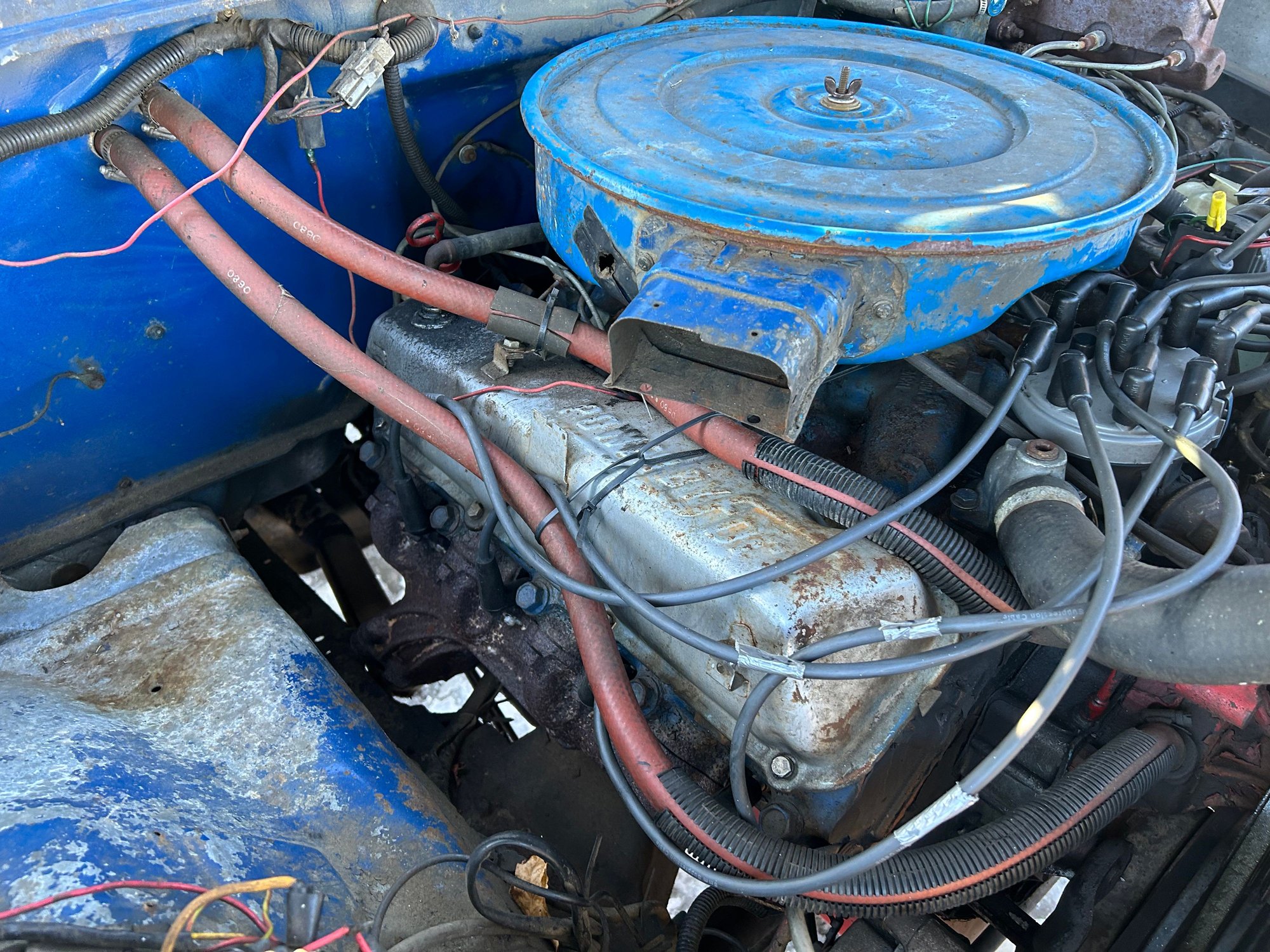

Hey everyone, looking for some help identifying the engine in this 78 F150. Owner says a 429 was swapped in a while back but didn’t have much more information on that.
Check out some of the photos, have a picture of the stamping on the heads.
Any help is appreciated, thank you.

To help ID the engine.
351C/M/400 335 series: 8 bolts in rectangular valve covers. Timing chain housing is part of block. Thermostat housing on block. Exhaust bolt holes diagonal.
351M/400 335 series: intake is 12.7" wide the 351C is narrow. The 351M and 400 are identical externally, only internal parts examination can tell them apart.
351W/302/5.0L 6 bolts on trapezoidal valve covers. Thermostat housing on intake. Exhaust bolt holes horizontal.
429/460 385 series: 7 bolts in rectangular valve cover
352/360/390/427/428 FE series: Intake goes under valve covers.
At least is has the Saginaw power steering box AND it has a 2nd one? Very interesting was it a snow plow truck? What is the valve on the dvrs side inner fenderwell with the lines and the lever handle connected to? Was this a logging truck and does it have a big winch on the front?
Yes it was a plow truck, still has it on the front but I am removing it and the accessories shortly. Needs a new starter and it’s harder to get parts up here, don’t wanna be sending it back if she doesn’t fit.
Will have to go and look at what you mentioned before, any idea on the part’s compatibility between the 429 and the 460?

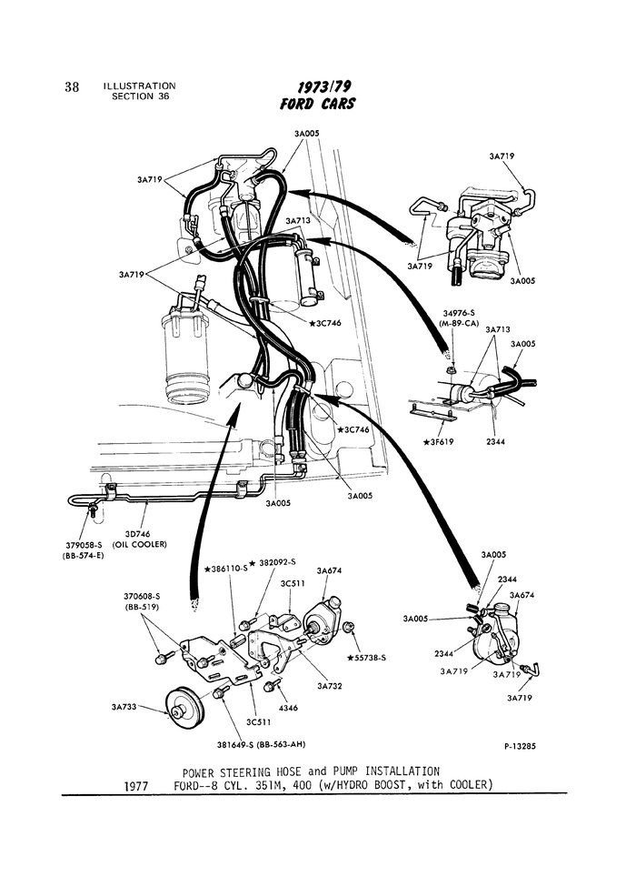

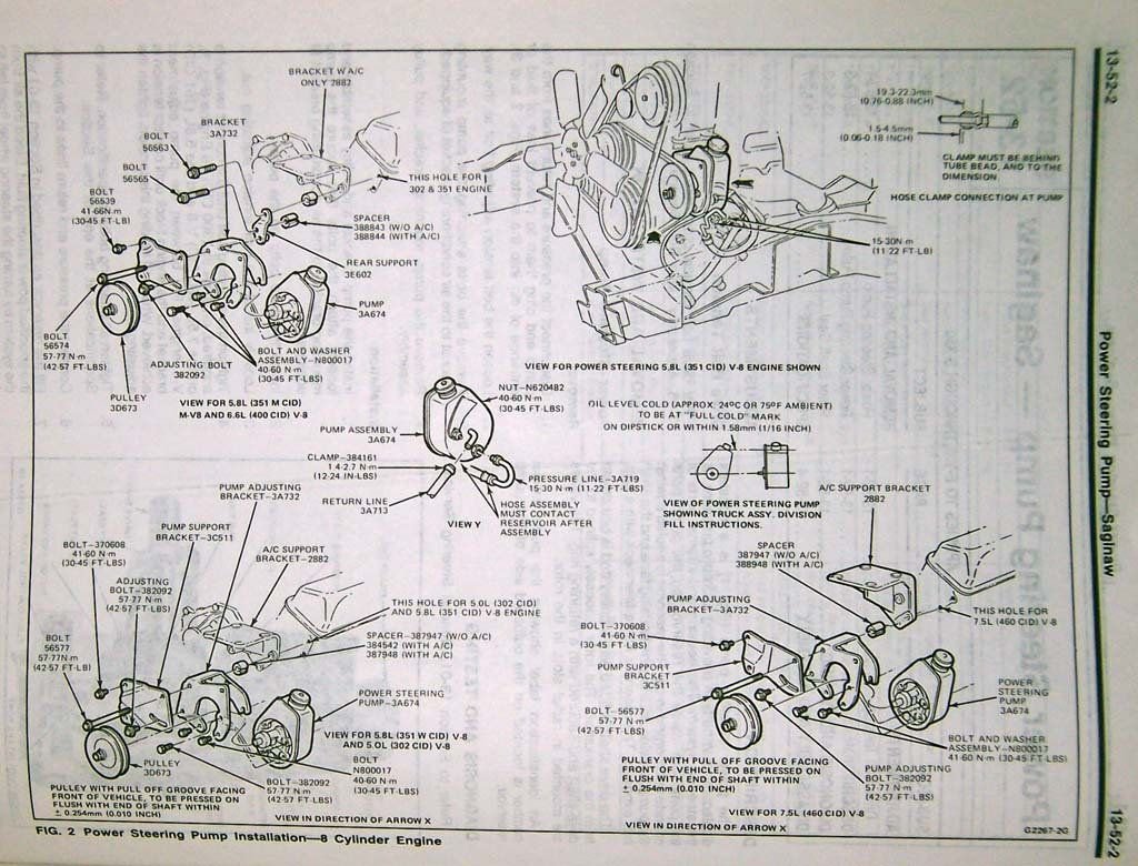

And some diagrams just in case.
I know you do not have this set up, but a good diagram of the Sag p/s pump.

It is a 429 or 460.

If it hasn't been taken off the 429's had an engine tag under the bolt that holds the coil to intake.

From: Reed Point, MT
Originally Posted by tbear853
It is a 429 or 460.
This is the answer you're looking for.
As for yor parts interchange between 429/460 question, they're just like 351M/400s....everything is the same except pistons and crankshaft through 1978-ish (well, 1973-ish on 429s anyway). I say "-ish" due to model year cutoff dates.
After 79, the blocks and cranks changed on the 460 to an external balance so the flywheels, flexplates, and harmonic balancer spacers from those 460s won't work on a 429. I do not know if a 429 crankshaft will physically fit in a 79 and later block due to the cylinder bore protrusion into the crankcase for use with the externally-balanced crankshafts.
Good luck!
