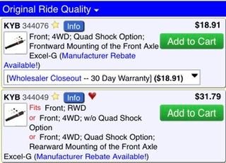

My 95 F150 has the factory dual shocks up front. I'm looking into replacements and the information is lacking. Are the dual shocks the same as the singles and I just order four,
or are the dual shocks valved differently than the singles? Not much info on the parts sites addressing this.
On the rears, my truck has the factory trailer towing package. Are those shocks any different than the F150 without the package?

The front dual shocks are different lengths. The front, front shocks are longer than the front, rearward shocks. Parts store websites I've looked at differentiate between the two. I don't know about rear axle heavy duty or towing package shocks. This picture is my '88.

As was already covered by Soup Bean, the before axle and after axle shocks have different part numbers for the front shocks because they are, well, different shocks.
