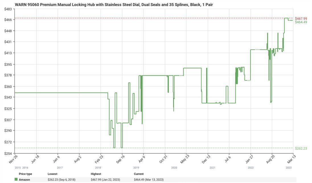

Bite the bullet and get the Warns. Luckily I found them on sale for under $300
$457 on Amazon right now. If you have their card, you get 5% (or $23) back...so $434.
Set up an email alert at Camelcamelcamel, and they will email you when the price drops below the threshold you set...
