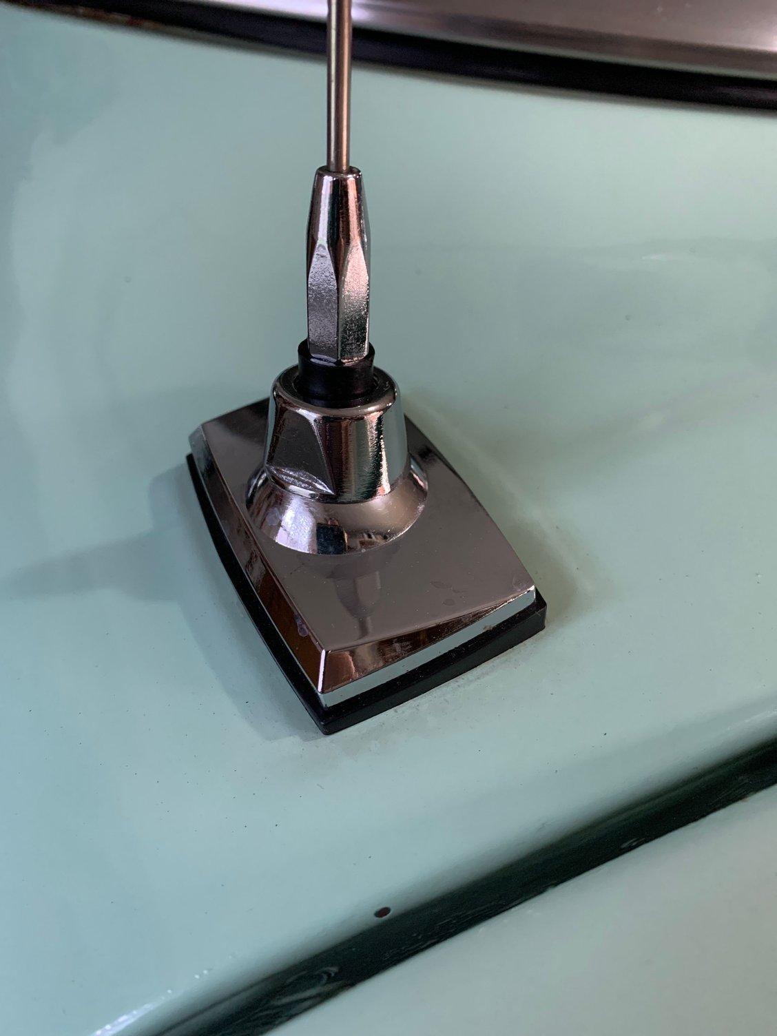

How about this one. I used one similar. Worked great.
https://www.retromanufacturing.com/products/1980-96-ford-f-series-truck-replacement-antenna?variant=21339688534098&currency=USD&utm_me dium=product_sync&utm_source=google&utm_content=sa g_organic&utm_campaign=sag_organic
here’s a picture of mine installed.
The angle of the base is important on your 78. Whichever when you track down, make sure it has that angled base or reuse the one you currently have. I may have an extra somewhere in the parts box.
