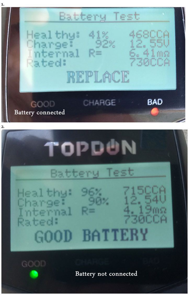

Just receive a battery tester. First test is top image below.
OK I. ll remove and bring back to autozone.
Remove vehicle cables and take out truck to bring in morning.
Decide to test again ( 2nd image below )
Help please

my first guess would be corroded battery cables. Try reconnecting the battery and try putting the tester leads directly on the top of the posts (bypassing the battery cables on the truck)...then retest with the tester connected to + post and - cable (then reverse) to see if there are any variances between the three tests...

Truck is parked under carport .... only 5 years old and cables look pretty clean.
My voltmeter gives the same readings whether I check battery post or the connector.
Also checking positive battery post to vehicle ground gives same reading .
I don't think I can try what you explained as the cable connector covers the entire battery post.

measuring voltage with the voltmeter doesn't force any current across the battery cable connections like the load tester does. you might wire brush the posts and the inside of the cables and try again.

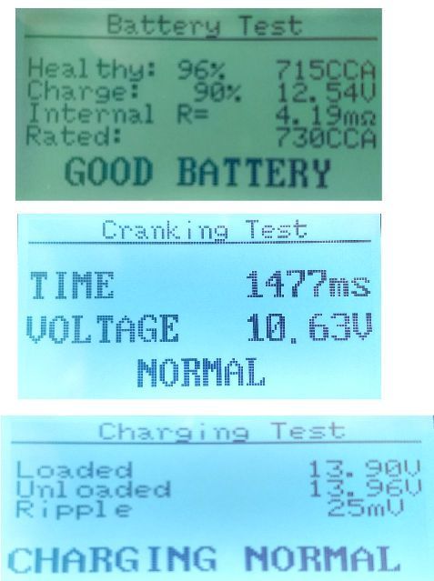

I thought about bringing it to Oreillys or Advance Auto to have them check it.
But the tester shows it to be good ... not only above, but the cranking test and ripple test for alternator both show good.
That first image above that showed bad may have been my error in not getting a good connection to begin with.

Well I've had the BMS disabled for week or so and it has started up pretty good, maybe 1 hesitation (turning on ignition not immediate)
Decided to let Ford have a look, so yesterday I hooked the BMS sensor connection back up,
Sat approx 20 hrs untouched and locked. This morning 4 tries to start.
First 3 tries ... dead ... like I did not have a battery connected. Error message comes up Charging System Service Now
