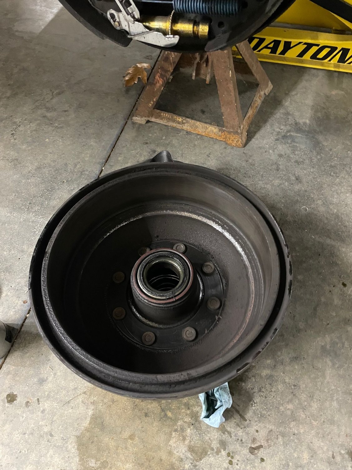

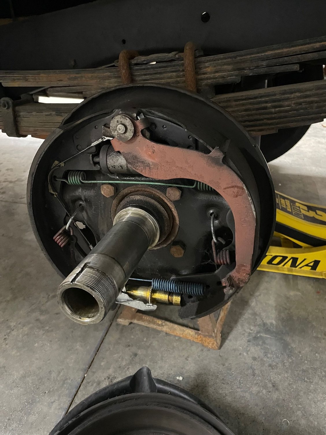

I forgot to update this thread. Having to remove the axle sucks. Not difficult just annoying.
I pulled the drum and all looked good, there was brake dust so I cleaned everything up well and put it together. No more squeaking. I was also happy to see that there was zero brake fluid. Glad to see all is holding together well.

Is your e-brake arm rubbing on the drum? It looks like it.
