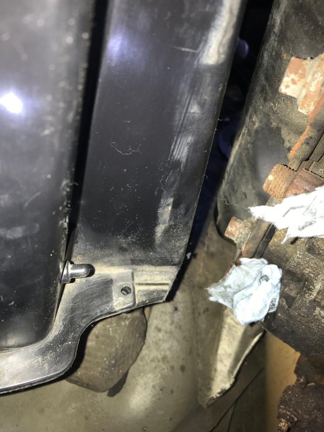

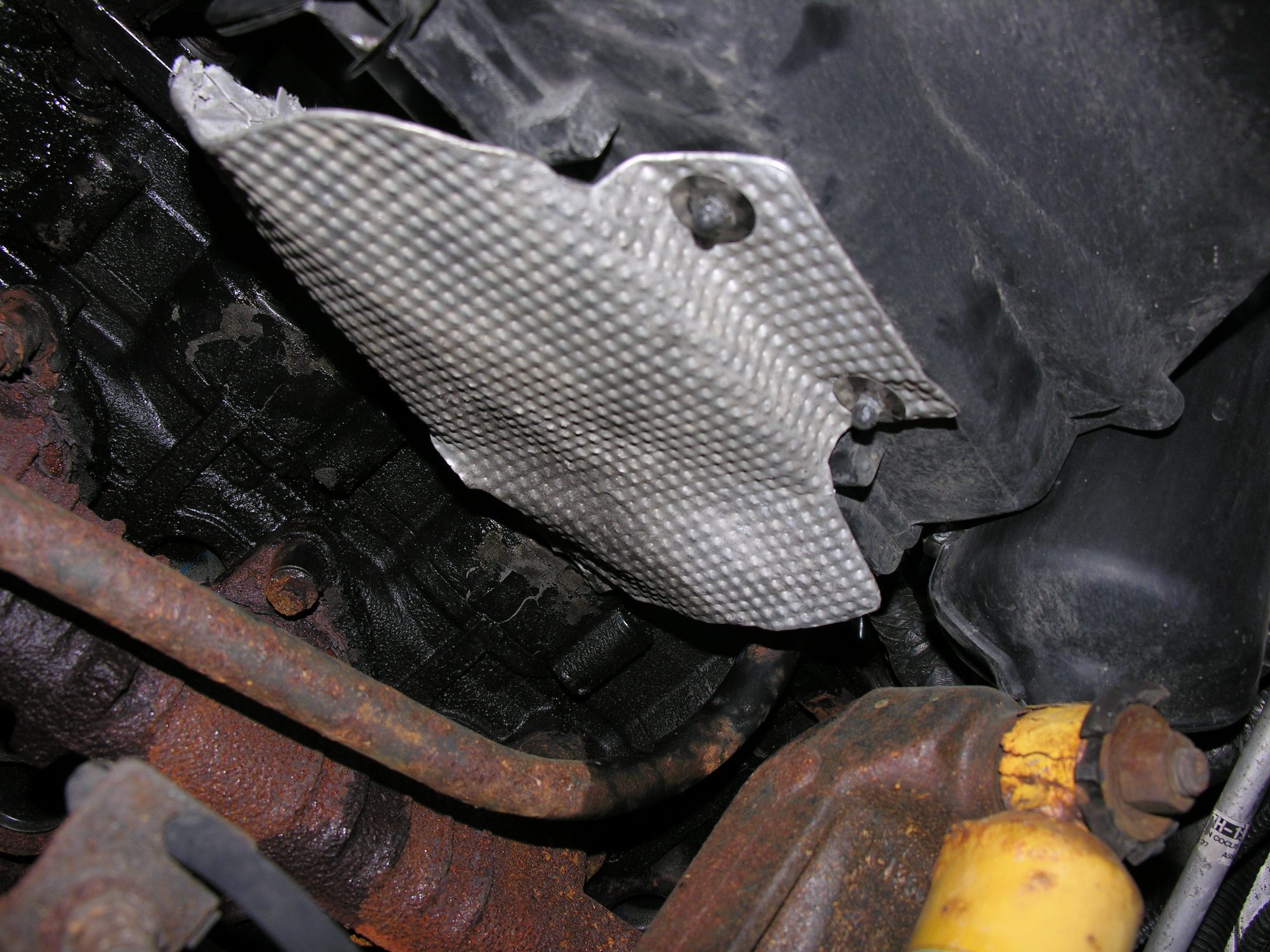

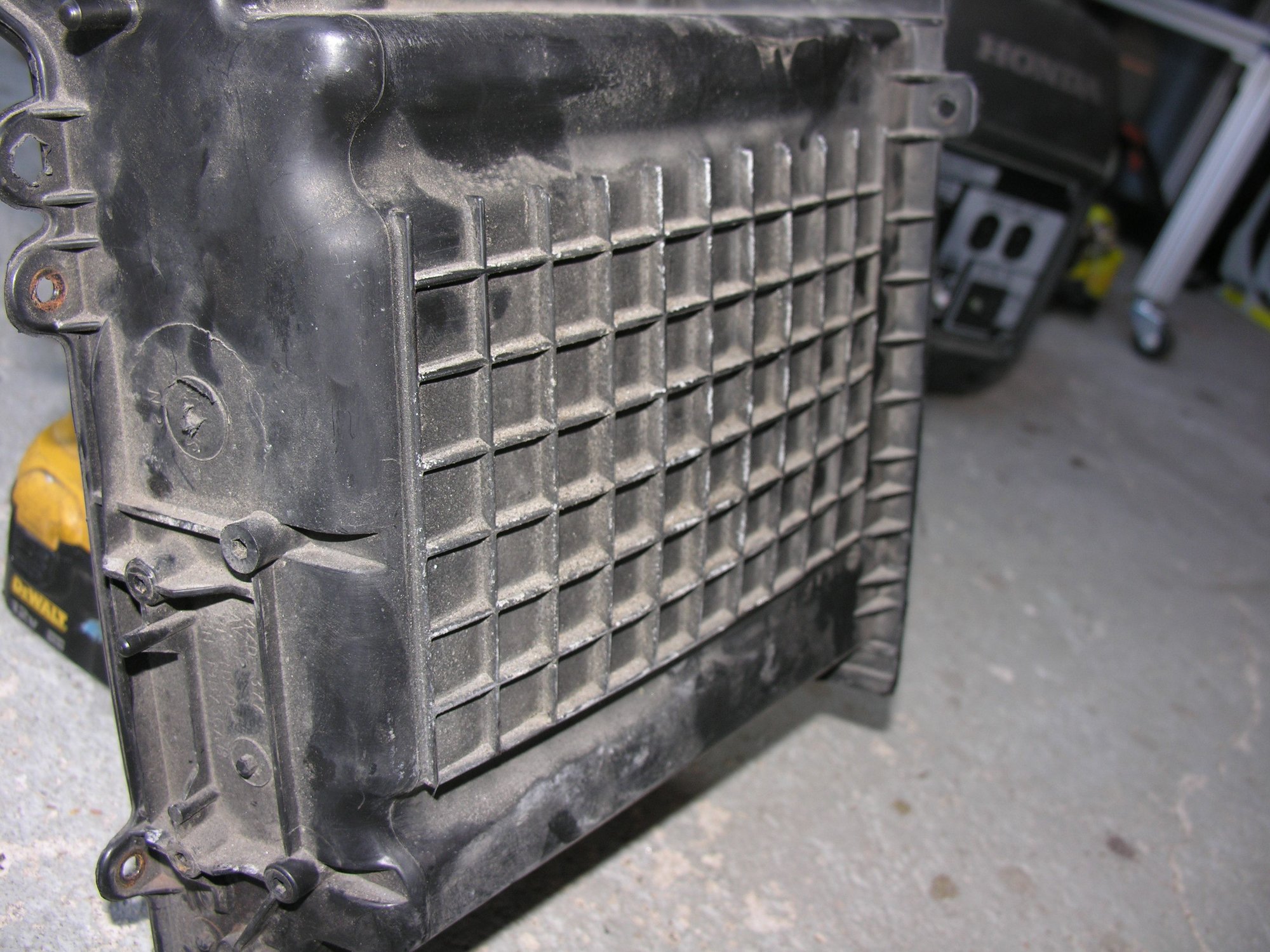

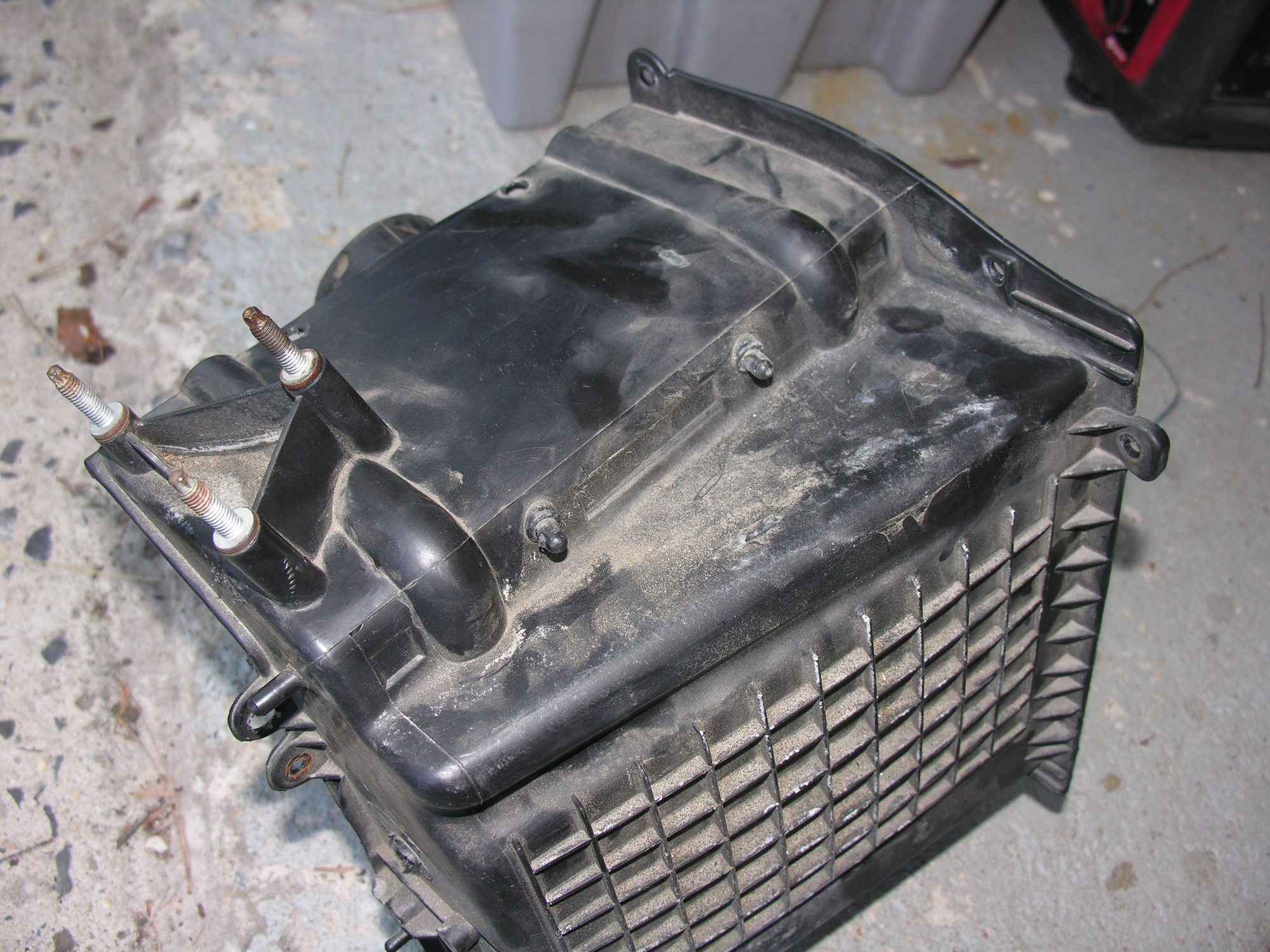

Yes the heat shield comes off. What is a pain in the tail is getting it from under the box.
Here are some images I had from a long time ago when I had to replace #5 injector. I have others that may take a little while to find.
It's not the easiest thing to get out of the way. Which is why I cut it in half for the second reinstall.

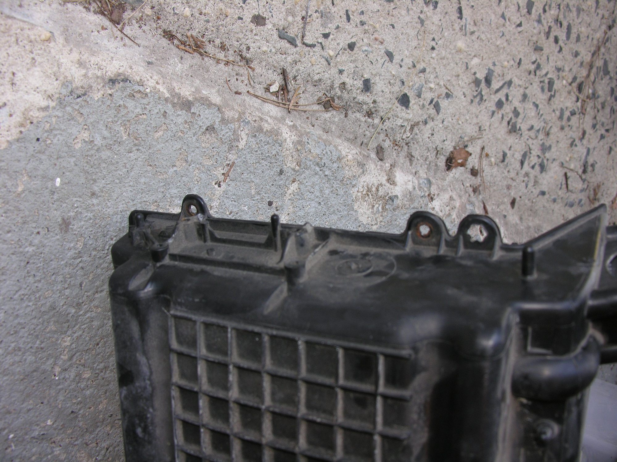

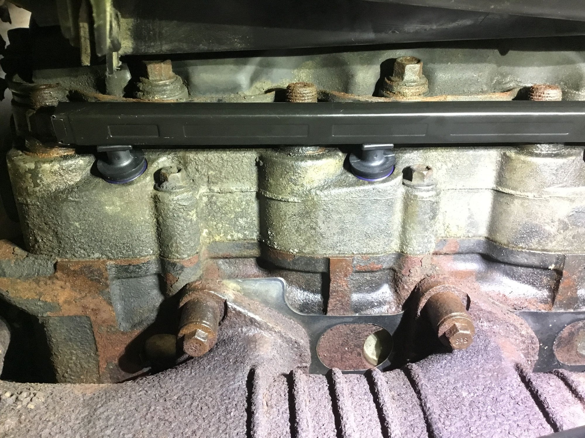

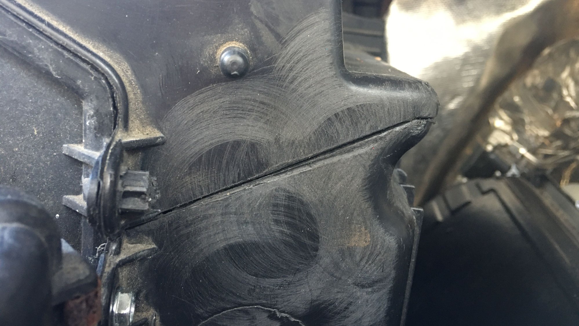

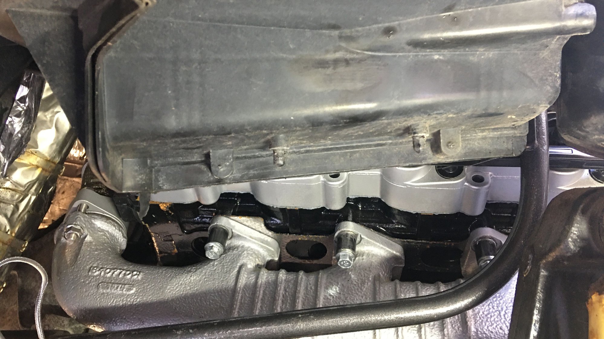

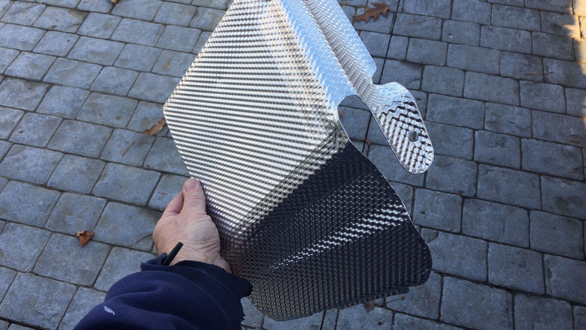

Found them. When I was doing the last part of my engine build and the engine install, my other MAC had a hard drive issue and I've lost a lot of videos and some images. Which is why I have two MACs.
This is what I have, so it might help show where all the screws are to remove this. I believe I also opened up the plastic surround of the A/C drier. And bought a new heat shield. This was all done in dec 2021, and so far the HVAC aluminum tape has held up fine.
The last image gives you some idea of the clearance given for glow plugs and injectors.

I should have noted this in the one image. All screw heads are 8mm.

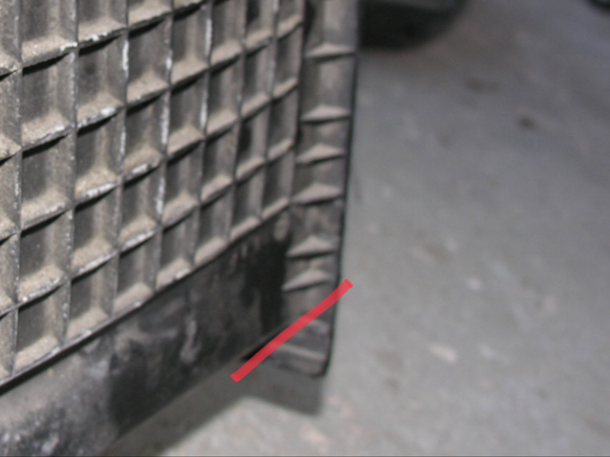

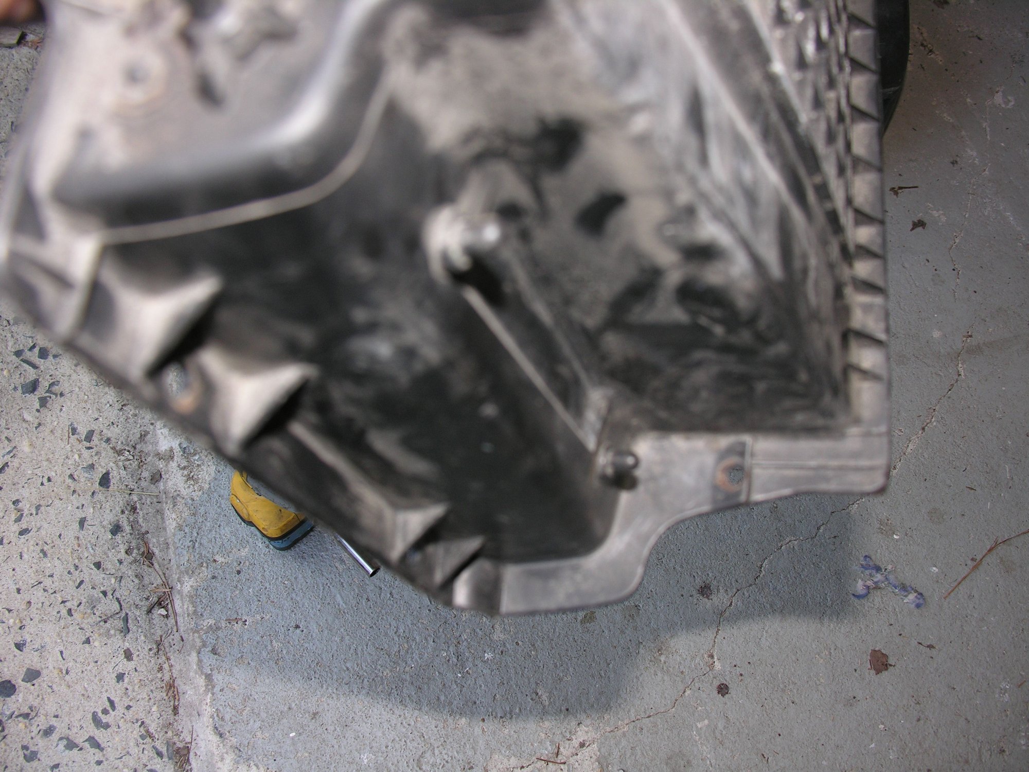

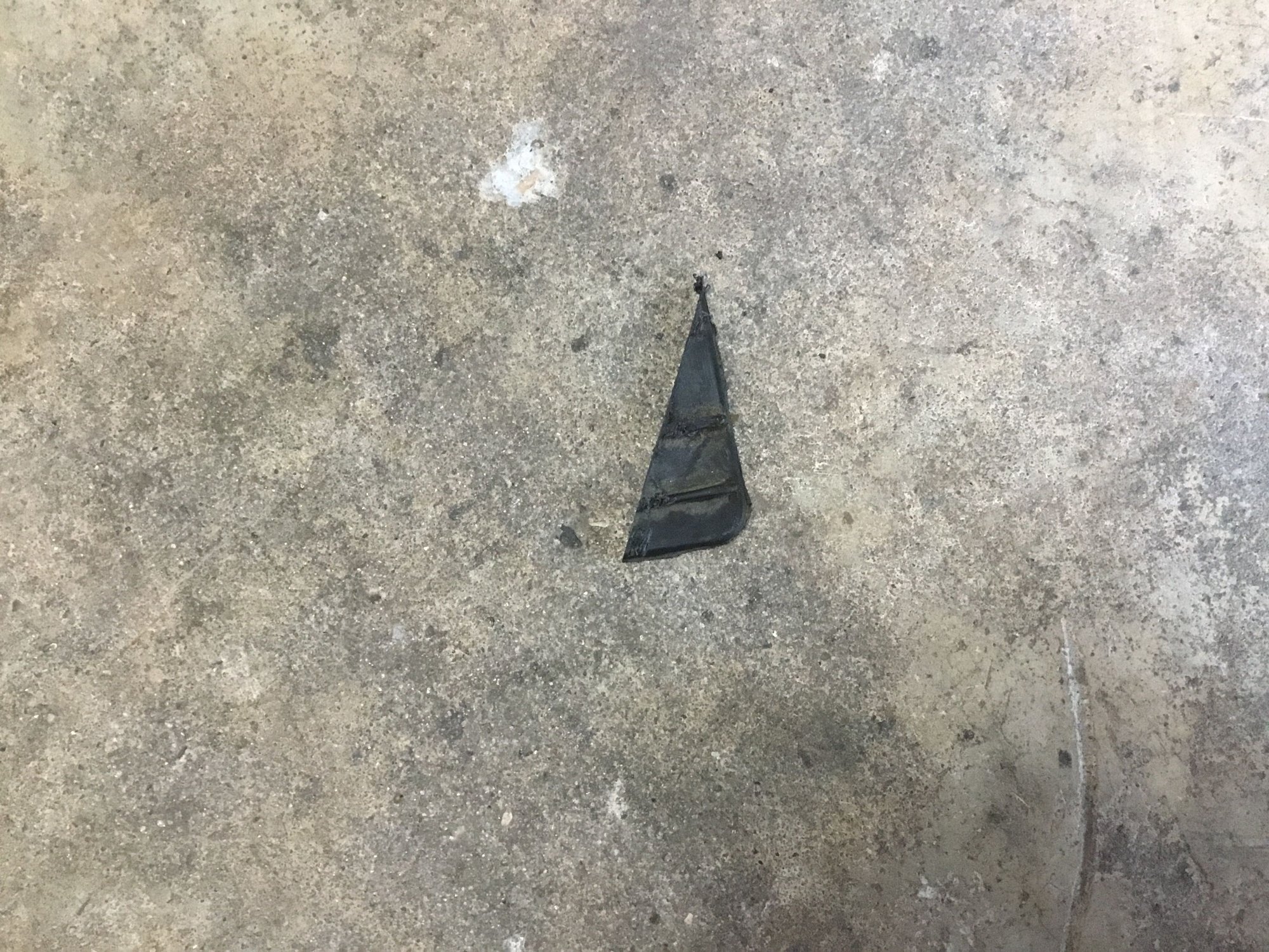

I don't really mind the tinnermans, I'm used to cutting them and replacing with new. But if you wanted to you could cut the posts, drill holes, and nut down probably some 6mm screws there, leaving enough thread for the heat shield and another nut.
Had to go back to the Sony XP computer to find that one. Not well focused, the bottom third.
Taped up.
