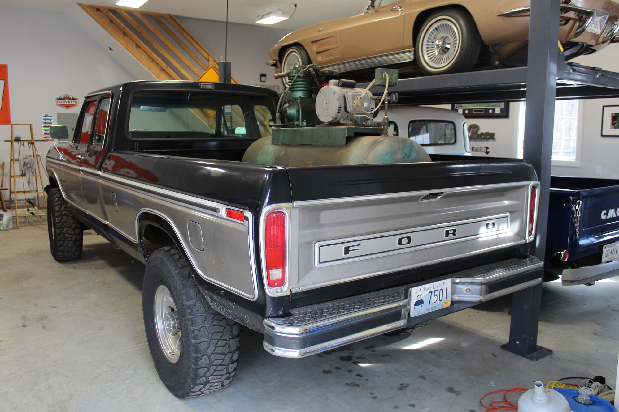

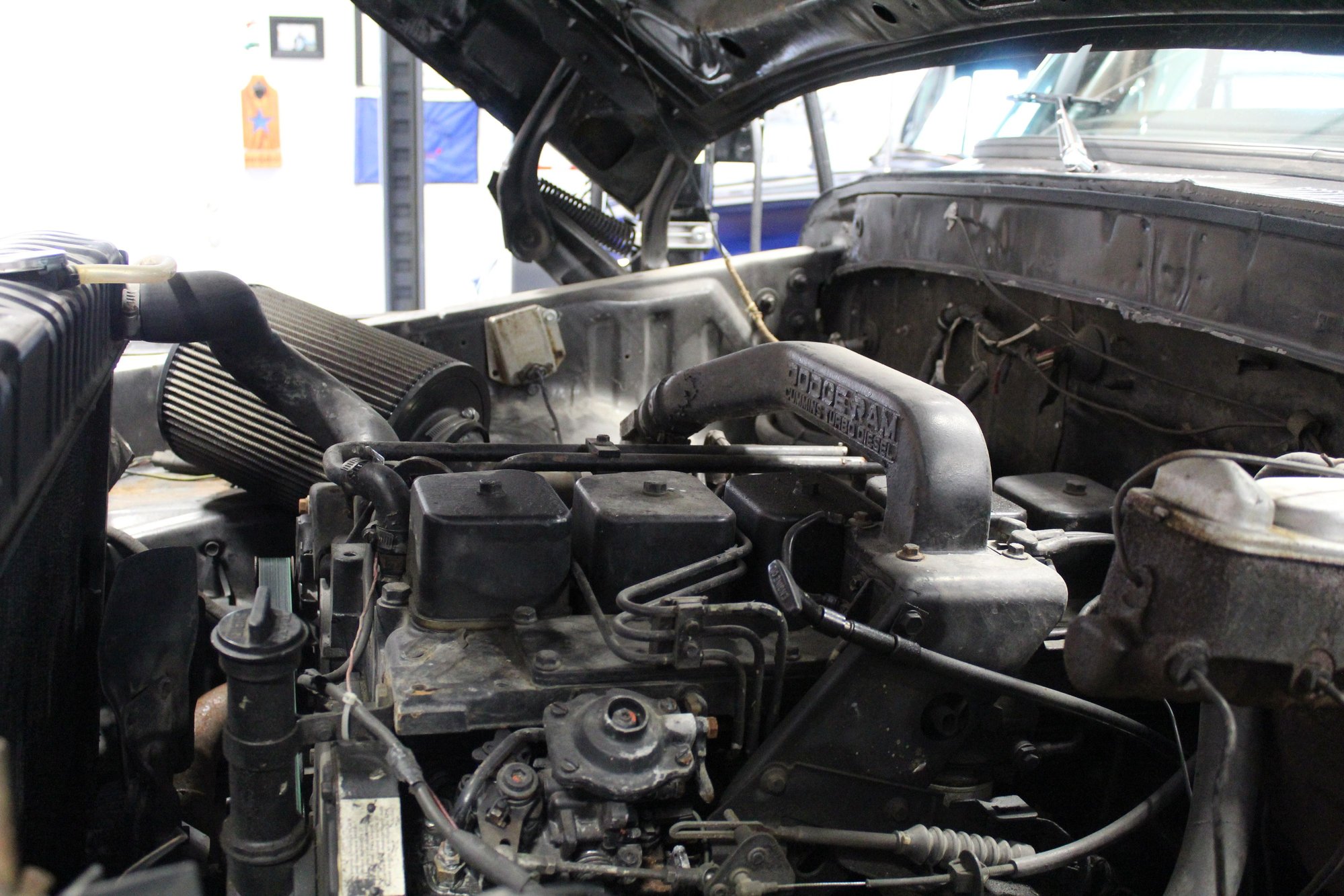

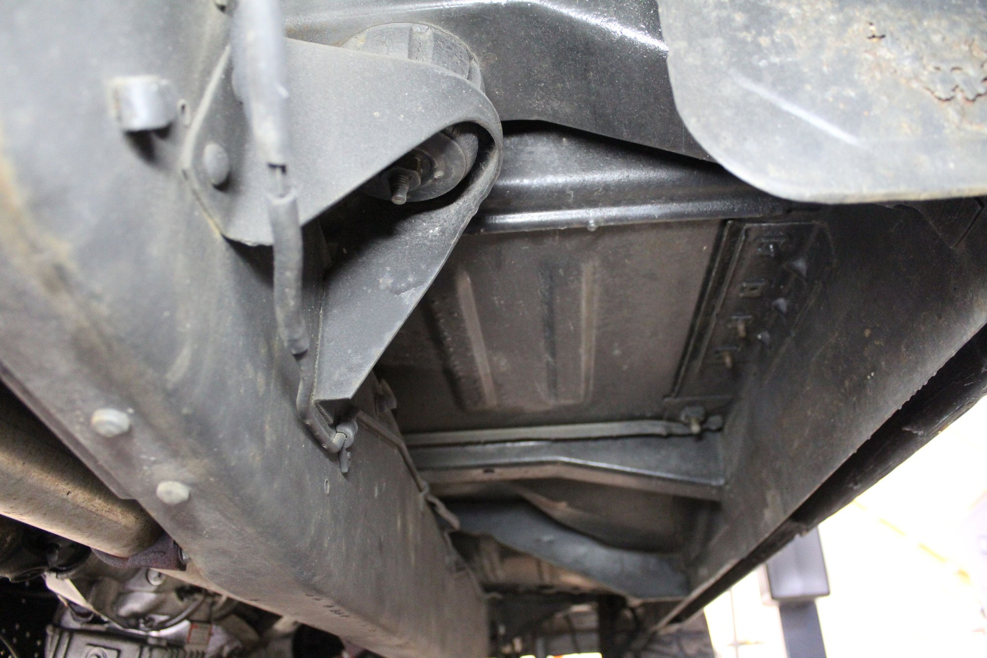

Thanks for your perspective "Old Guy"...I feel the same way, but there comes a time when you need to thin the herd so you can find your next challenge. That's where I'm at now. I have driven it now as my daily for about 6 years as long as the salt wasn't out and I guess the only thing I have had any success keeping is my wife?!?!? Not sure the truck is gonna go, but having it in the garage this winter has had me thinking?
Here are a few pics I just took. Sorry for the quality, but it was the best I could do given the fact that it is stuffed inside for the remainder of the winter. It will give everyone an idea of what it is tho.
I should have given it a good cleaning before the photo shoot, but it is my D/D?!?!?!

Very Very NICE CLEAN job.....

Based on those pics, I would say low 20’s as it sits.
what kind of fuel mileage have you been getting?
is that a gear vendors hanging off the transfer case?

Yes it is...I have been getting around 18mpg's running around town and hiway combined. It's really Smiles per Gallon!!!

That's fantastic fuel economy.
80% better than gassers with more tq runing on fuel that costs 25-30% more...so money ahead indeed.
Does that trans have a lock-up tq converter?

Nope, it's the old school 727 Torque Flight out of the Dodge. No computers on this one!!! That was the reason for the GV O/D unit. I really put some thought into this before I started cuttin it up and am really pleased with the outcome. It is a really nice/reliable piece that you couldn't build for half of what I expect to get from a sale.

x2. BaT is a great resource for researching historical sales before you decide to sell. You can see what similar trucks were going for pre, during and post COVID. It's a great looking truck. Cheers

Not a detraction, but just curious. Was the truck originally A/C or did you just use an A/C dash. Reason I asked, looks like maybe a filler on the passenger side firewall ... and then I wonder what the heater is? Again, not a detraction, as I've been thinking I might remove compressor and condenser on my '77. I never use the A/C or even think about it ... I only ever put it in because we had some trips in mind, camping, etc ... but I don't see any road trips being taken in it now.

What would you like to see as far as fab work?? I can get it on the lift in the background, just gonna take some shuffling. I really didn't document it as I went along. It was an A/C truck when it had the gasser in it. I have a Vintage Air heating unit tucked up under the dash, no A/C. The turbo was in the way of the HVAC box on the firewall. Hindsight, I wish I had looked for a different exhaust manifold that relocated the turbo, but live and learn I suppose. That is the one thing I would do differently, but didn't even know they existed at the time.
