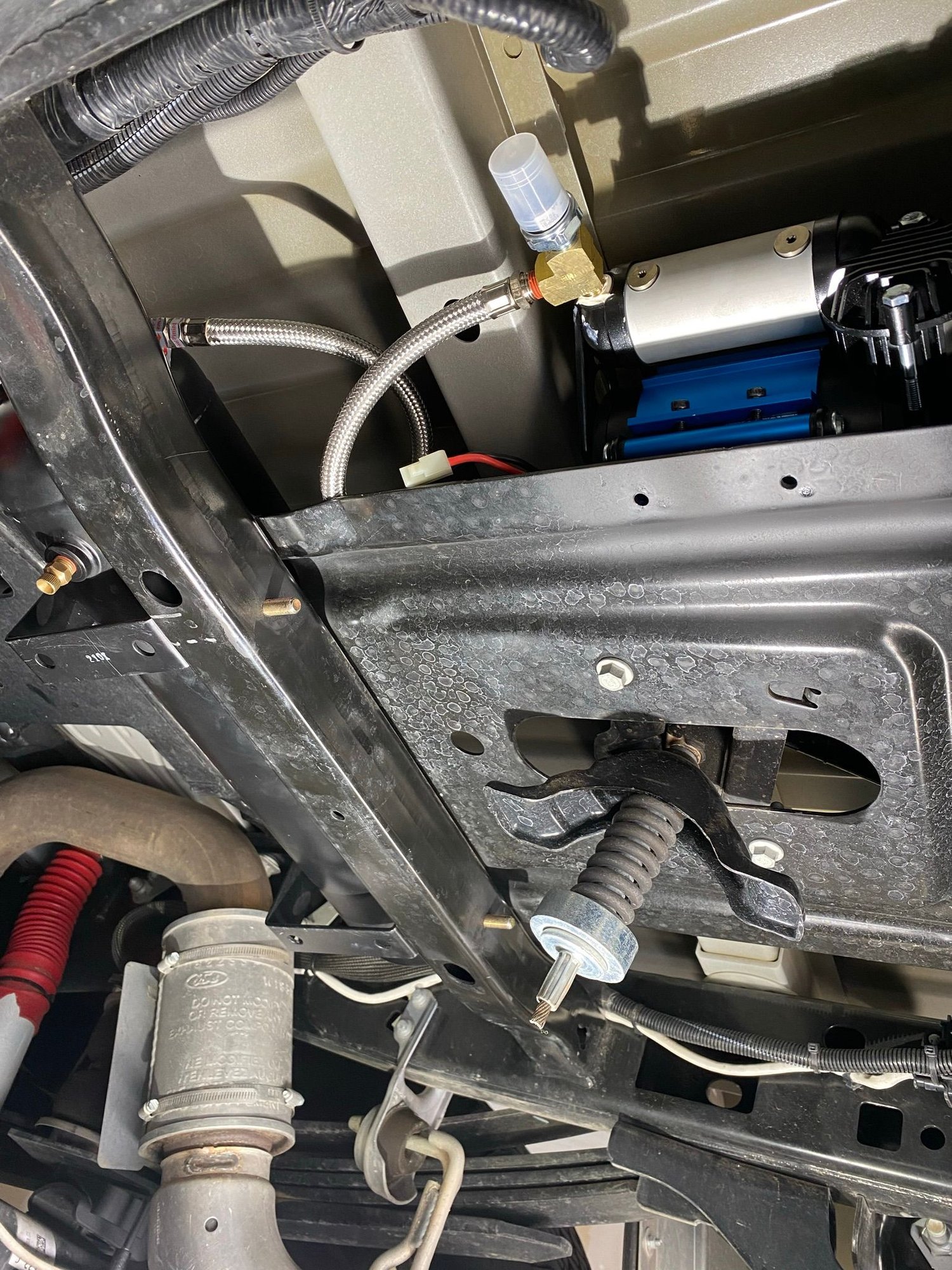

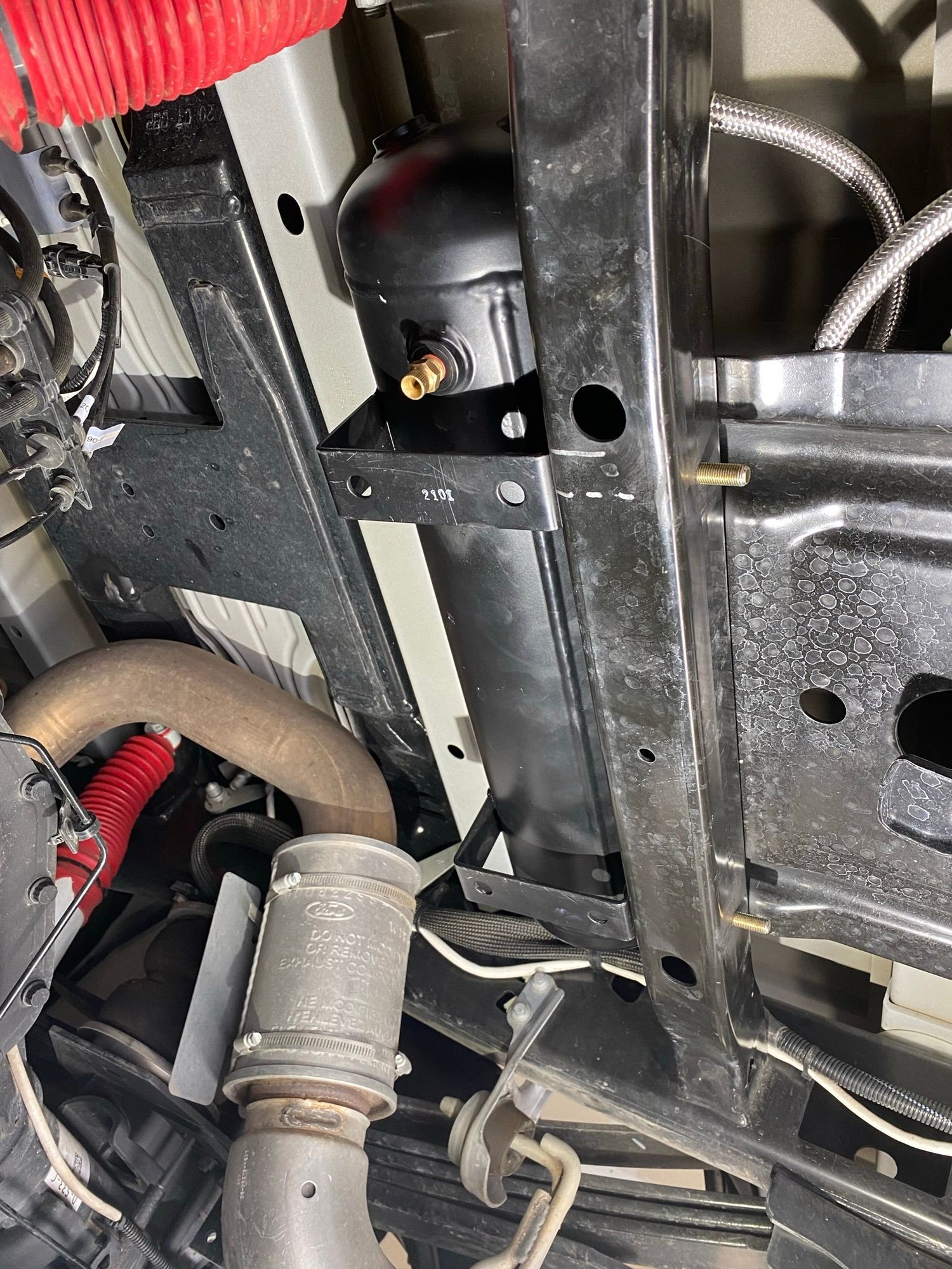

Arb single above spare, 1.5g tank behind it

I replicated Squirrels install to a T! He was very helpful when I hit him up with questions too. The single did not interfere with the spare mount at all. I can’t say for sure if a dual will fit but I think it would.

Spare is not impacted in any way. Still goes up and down lime OEM

few reasons I chose the single ARB. Price, amp draw and size. If I had to fill 37” tires from 8 psi sure get a twin.
