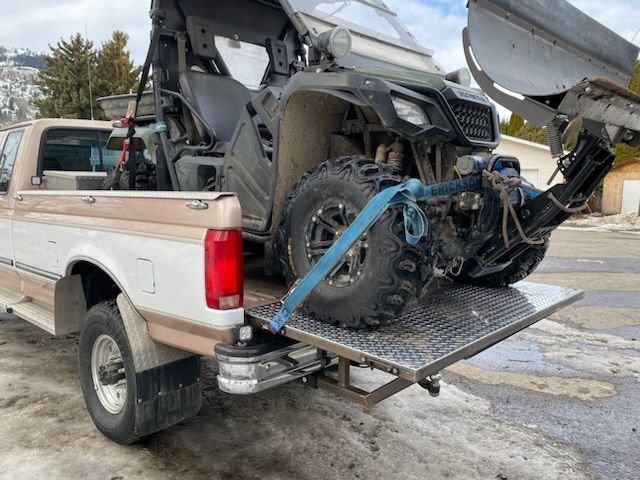

I know perhaps not a solution, but above is what I’ve done. Saves tailgate from significant abuse. Above slides into 2” receivers on class 5 hitch. This was made to haul the Pioneer 500 which weighs about 1100lbs, without the snow plough.
cheers,
j

This is a wicked design! I might potentially go for a in-bed camper for traveling, and if I do, I might look into something like this! As I sit currently, I just pull a trailer whenever I load up something that heavy haha
