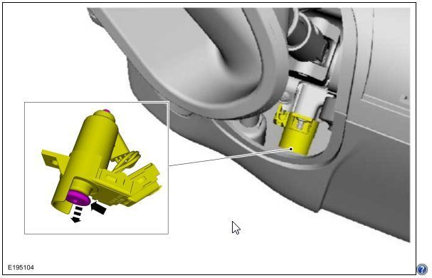

Do you hear your column "click" when you press on the brake with the truck on? If you don't the plunger isn't moving and allowing the shifter to move. Sounds to me like your brake switch is bad or has a loose connection etc.. It's attached to your brake pedal at the top of the arm. It would explain your brake light issue too I believe.
Thats what I'm going to be looking at today. It was late and had winds blowing last night repeatedly slamming the door on my legs as I was trying to look up under there. For verification you can hear the audible "click" of the plunger when you put your foot on the brake correct?

Yes with the truck running when you press the brake pedal you should hear a faint "click"
