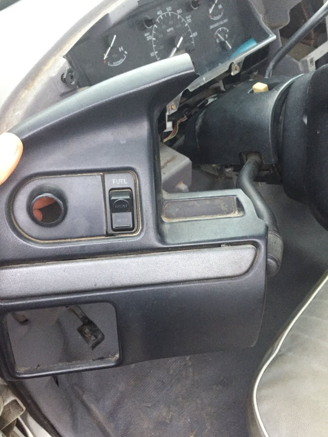

The left side of mine looks like this as opposed to a new one.

There are 2 different styles for the left. Every right side is same, 4x4, low, right turn.
- One has Left Indicator, Fuel Reset and AMP
-The other has Left Indicator, Theft, and Air Bag
