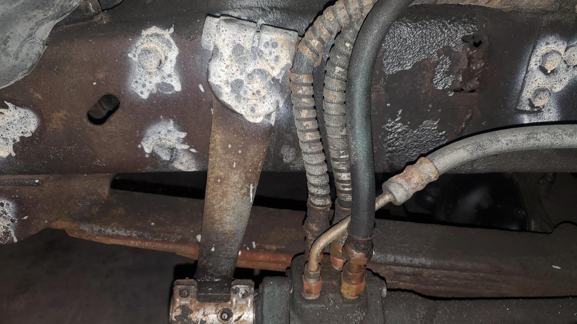

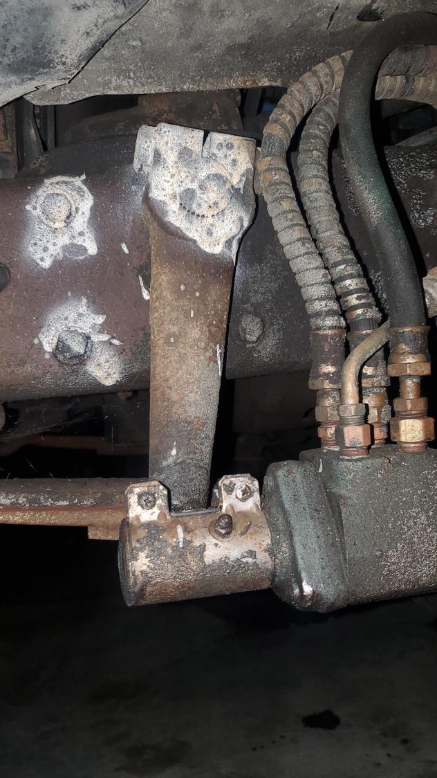

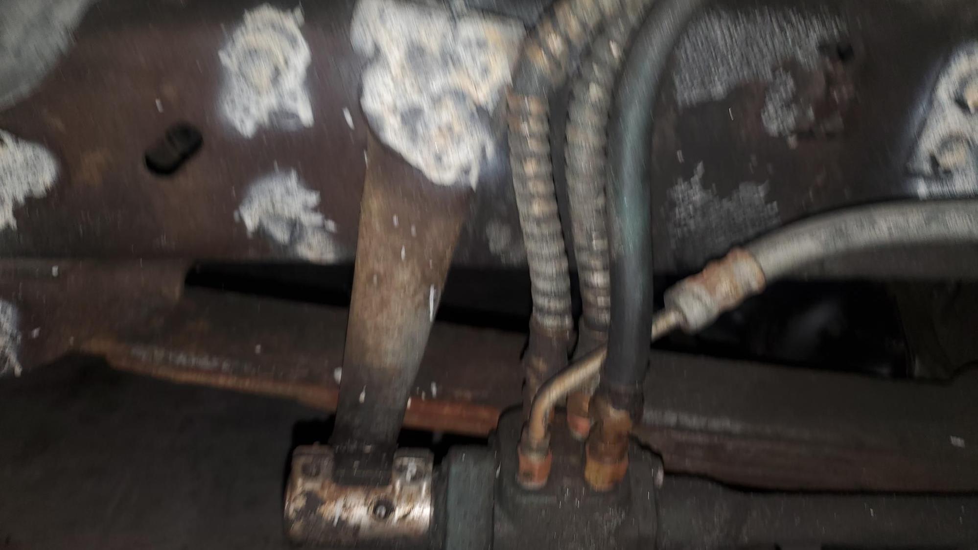

Good morning ford community. I am considering upgrading the steering box of my ruck that correctly have a power assist. I reach out to Redhead company, and if I do not have a core, I need to come up with $1000 to get a steering box.
What I am looking to get from you all is advice from those who have already done the upgrade to their trucks. Also, besides the steering box, what else will I need to purchase in order to make the upgrade?
I am not too excited to cut the frame of my truck, but from the videos I have watched, it seems that it is needed to attach the 78 -79 steering box to the frame.
I have attached pictures of the correctly set up.
Thank you all.

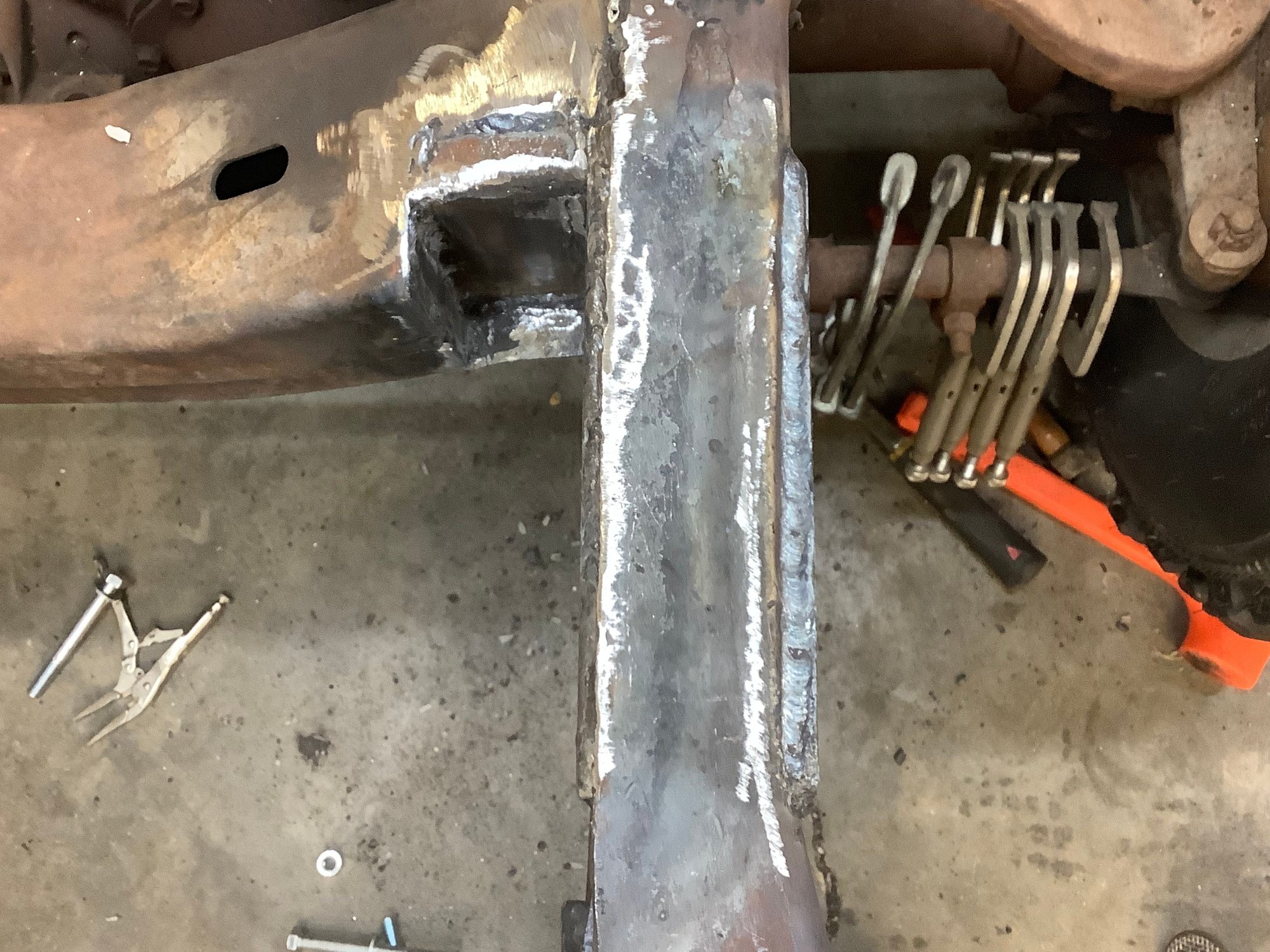

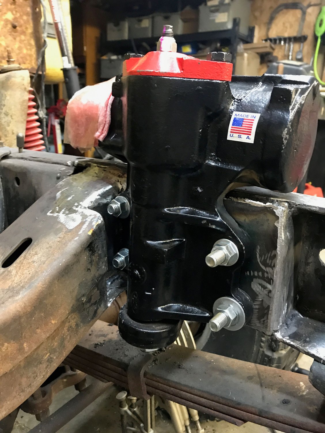

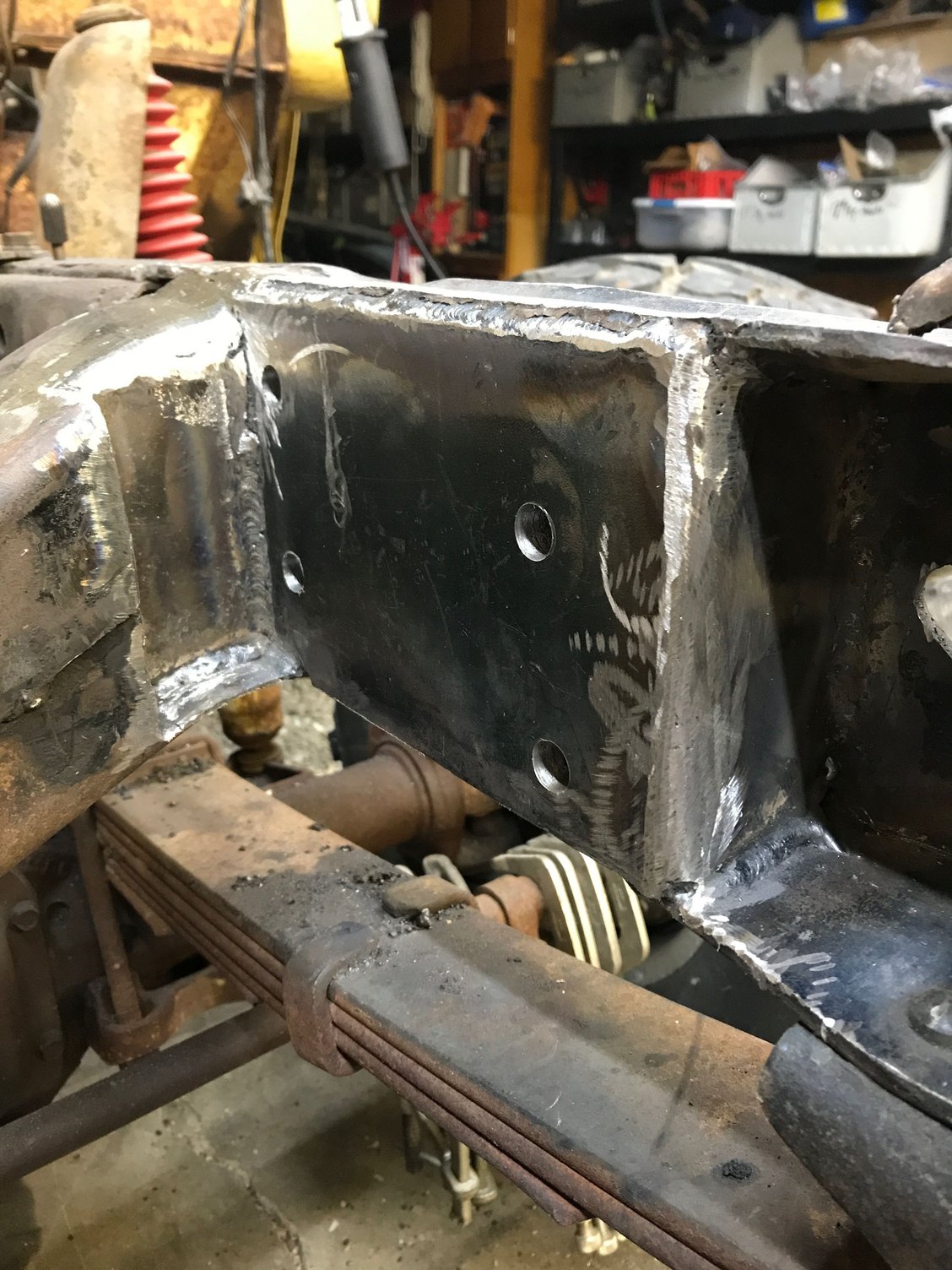

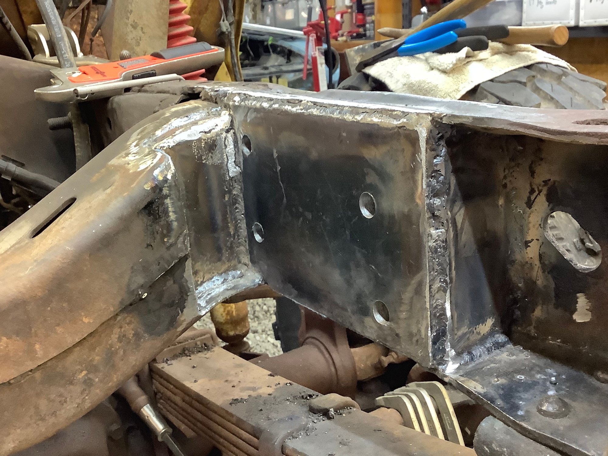

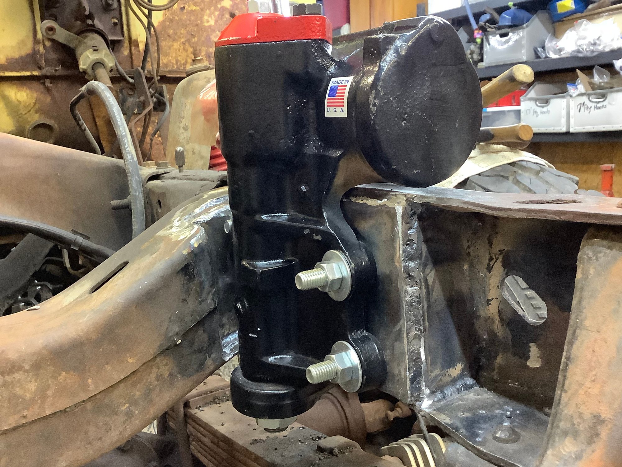

I did this mod and it is far from cobbled up mess. I guess if you hurry through it with out taking the time to think it through from start to end you could very well end up with a HUGE mess. First thing the wife said after driving it since the mod was “I can’t believe how much better this thing drives. So easy to steer now”. Then she says the brakes are a close second behind for the way it stopped compared to before. I added the hydro boost. It wasn’t really that hard to do just take your time especially with all the measuring. Don’t want to go through this and still have to cut the radiator support or hit the frame on a full clock of the steering. It is all super tight but works and works great and in my book looks like it belongs.
Oh, FYI. I traded my old power assets set up to them in place of the core charge. All of it (steering box, ram and cylinder). One of the best decisions on the build.

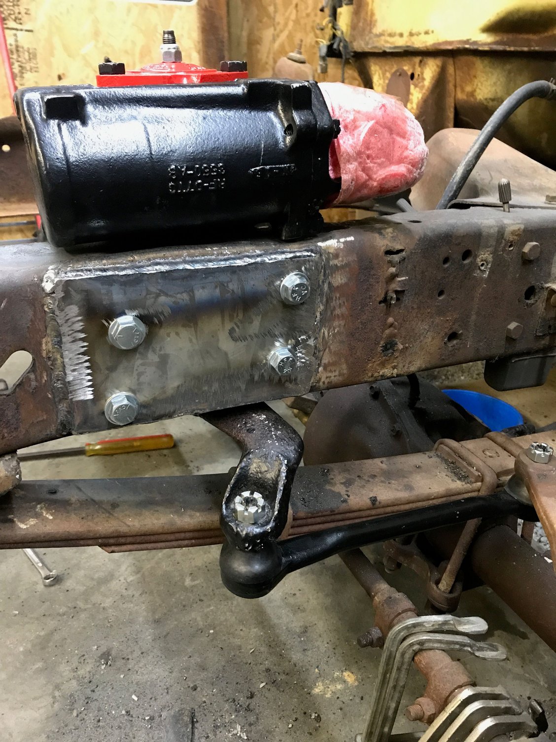

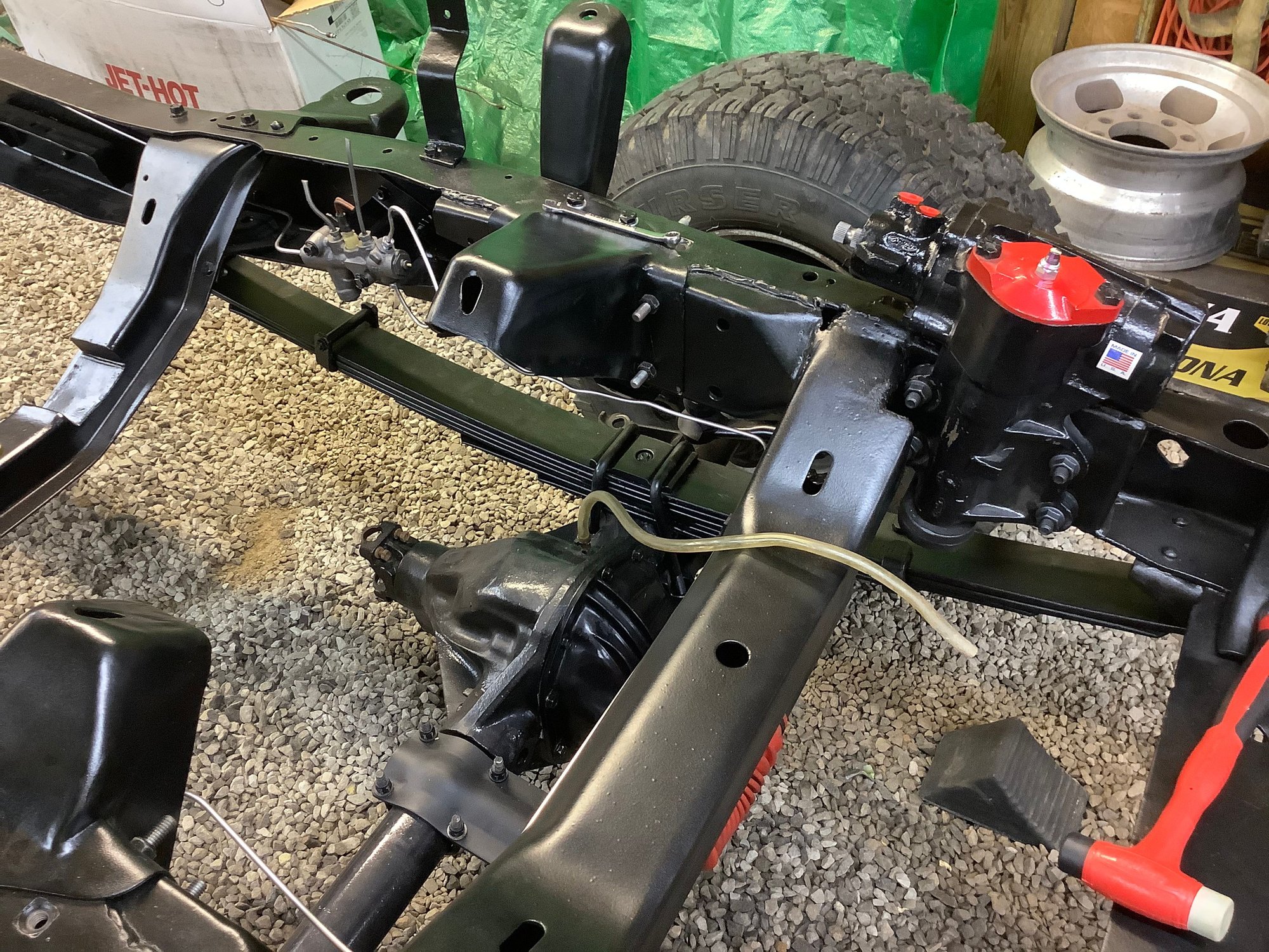

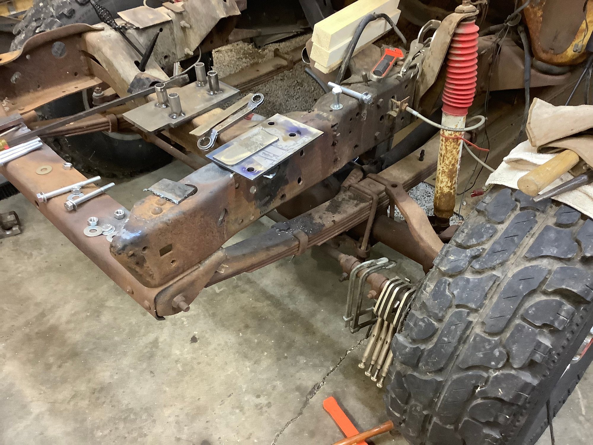

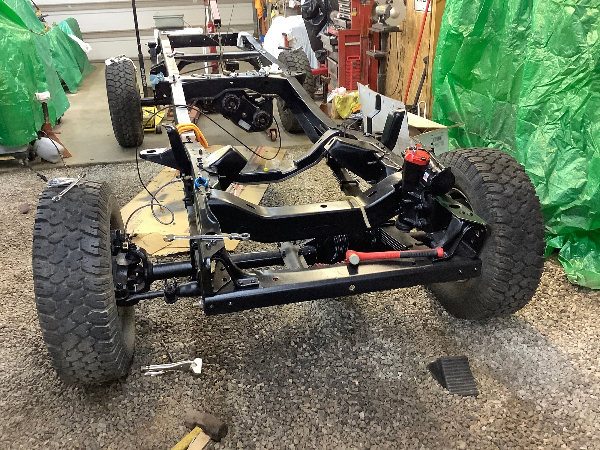

Thank you for sharing your pictures; you are doing an impressive job. Please know that I am not well familiar with the processes, that’s why I may be asking selling questions. What is the reason for cutting on the frame so that the box can line up with the steering wheel? As you mentioned, I also want to enjoy the ride as you said how much difference made.
Old Feb 14, 2023 | 01:02 PM
73 hi-boy 428 fe's Avatar
73 hi-boy 428 fe
Joined: Jan 2005
Posts: 1,011
Likes: 232
You have to cut the frame cross member so the box fits without hitting the radiator support. Like I said it is a tight fit.
