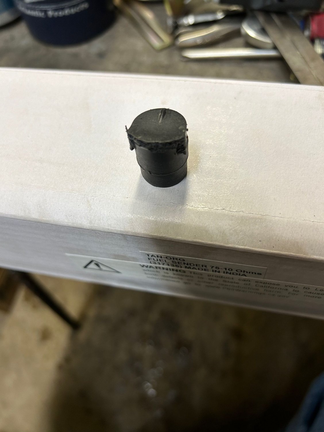

2013 F150...The HVAC fan had something rattling around when running,Took it apart and found this.Heat and AC seem to work fine.Any ideas?

That's the broken part of the fresh air intake door that connects to the actuator.
