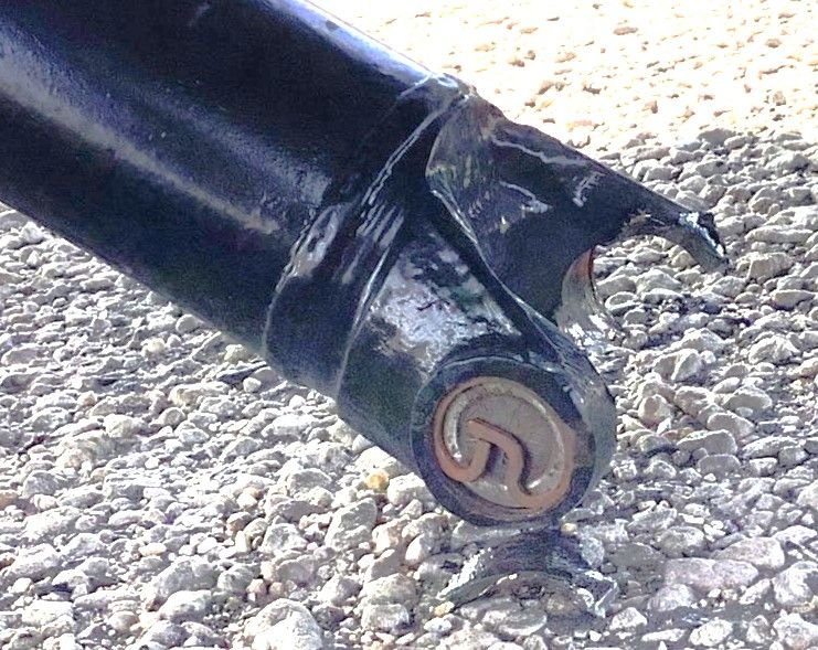

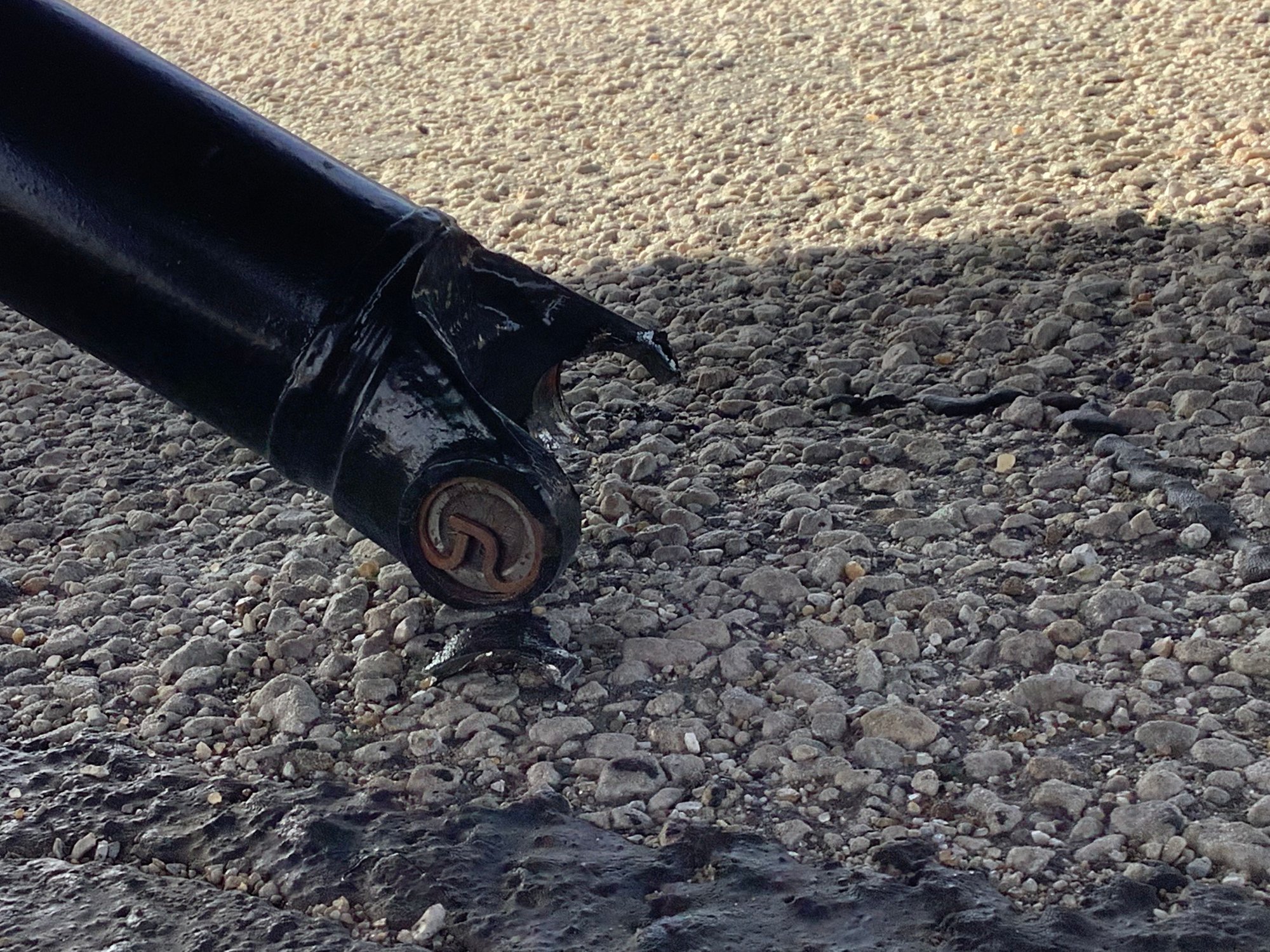

First time I open her up on the HWY and this happens! I was afraid this would from a dead stop but not already moving. Any ideas on a good driveline replacement with some meat so I don’t end up along side the road again? Would like to upgrade all the drive lines, yokes and u-joints before this happens again! Haven’t even started to have fun with it yet.

Ouch!!!!! That does suck. I suspect your engine must be making ever so slightly more torque than the original stock engine... : )
I would visit your local driveline specialty shop. They can easily install stronger drive shaft yokes and maybe even go up a size on u-joints although then you might need to go with a conversion U-joint for the very rear.

It does at that! I think it likely that the that yoke was already cracked on the driveshaft itself. The U-joint did not fail, the yoke did.

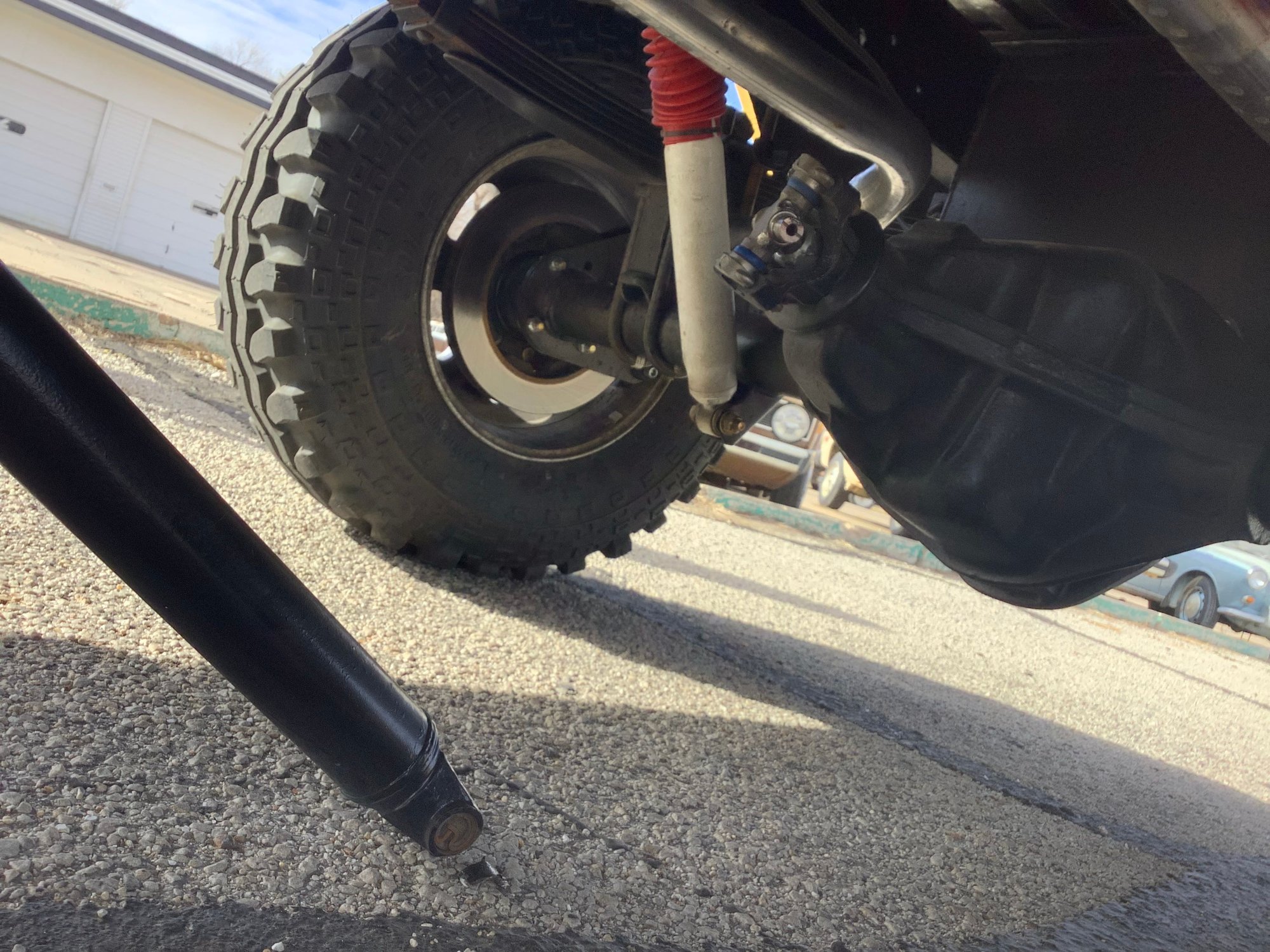

That does suck...for sure. Better a d/s than a yoke on the pinion....there has to be a weak link in there somewhere, and u joints are usually it. I would of taken the rest of the d/s out (slip yoke on other end at xfer case), locked in the hubs and drove home in 4 H and NOT put my foot in it. That u joint looks awful suspicious and I see no grease in there anywhere. But yea looks like the d/s ear failed when you punched the gas on that hot rod.

Almost looks like the clip that holds the cap in came out first, then the cap, then that happened.

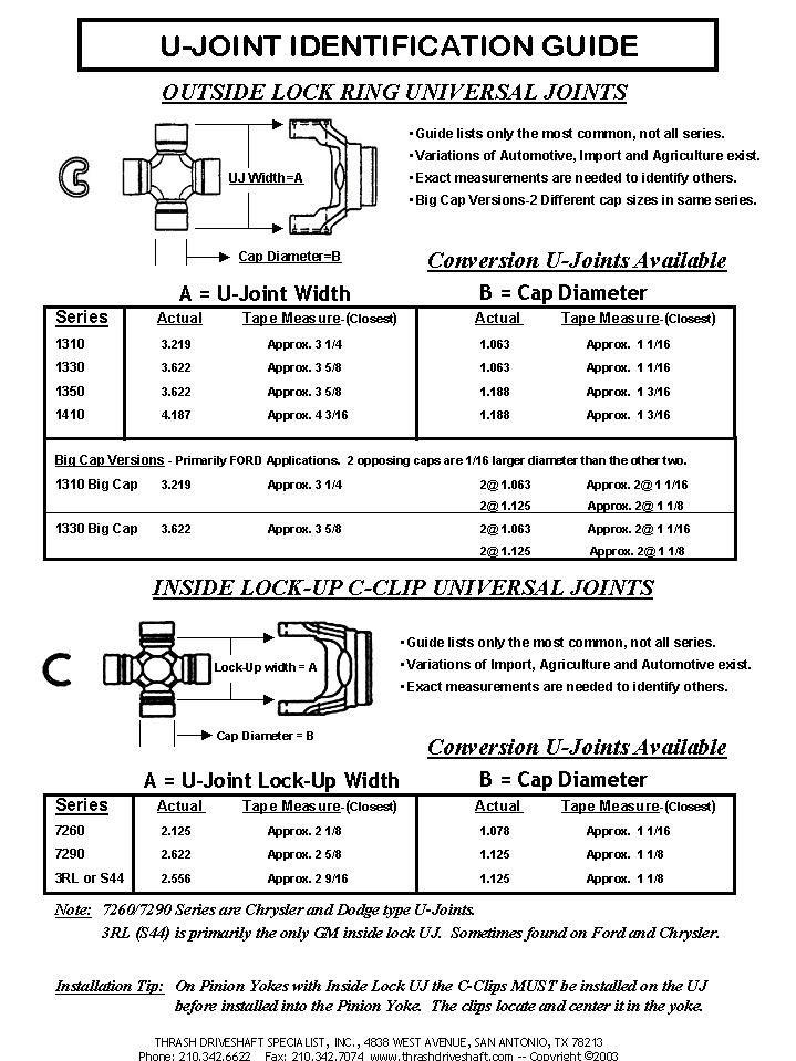

Are there 1410 yokes available to fit the differentials and transfer case?

I am at a total loss for any knowledge on what I have or would need. Hopefully they can hook a dummy up like me up! All these spline counts ect.
X2 the DS was cracked to start with.
The other thing to check out as it looks like you have a lift, that the U joints are not bottoming out on flexing
as that could also be how it cracked.

No lift all stock.

I would chock it up to 40 year old drive shaft just giving up the ghost. A good driveshaft shop should be able to get you the upgraded flanges.
