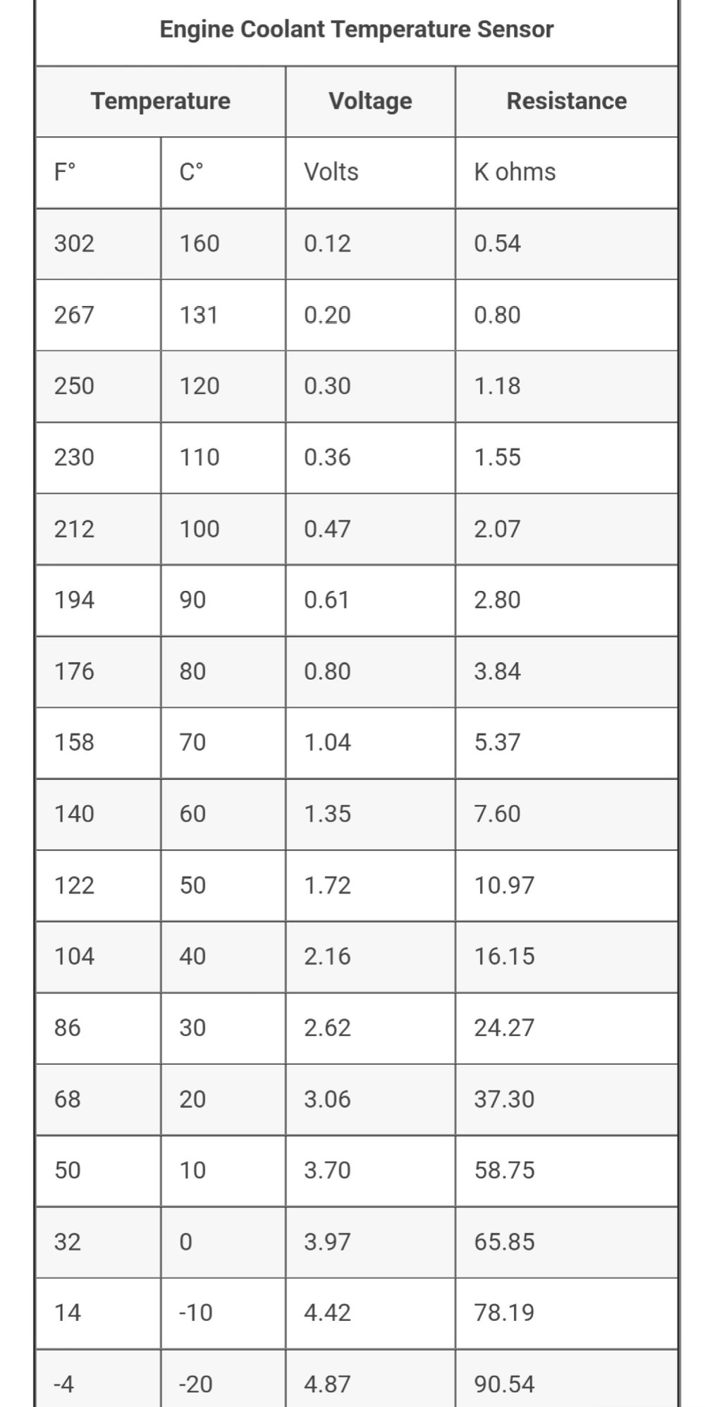

Great job doing some trouble shooting! Black smoke out of the exhaust is a positive sign you're running rich.
Next step is to bring your truck up to running temperature and do an code check with the KOEO and KOER. It's important that it's at running temperature.
I suspect it's going to give you a ECT trouble code. Your dash temp gauge and your ECU temp input uses two different sensors. Both sensors are on the intake manifold, but the dash gauge sensor has 1 wire going to it. The ECU temp sensor has 2 wires to it. You obviously know you way around a multimeter so it shouldn't take you too long to disconnect the ECU temp sensor and get the resistance of it. Here's a handy chart. While you're in there, you should check your IAT sensor too. It's also on the intake manifold, in one of the intake runners, and it uses two wires.
I have pulled codes many times hot and cold and its always the same #21 and #85. #11 will only show up if I clear the EEC. Will a faulty ECU temp sensor cause the rich mix ? Where can I find test procedures for this and the IAT sensor ? I would like to do some KOER tests too but don`t know how to proceed there either. Would the #85... purg circuit failure cause any issues ? I see where many remove all that, air pump and all. Mines all there in pretty good shape. Isn`t that controlled by the tab or tad sensors which I haven`t checked yet ?

I'm surprised you have 2 digit trouble codes. I was lead to believe that 2 digit trouble codes were changed to 3 digit trouble codes in ~1991. Are you sure you're counting correctly?
Yes, a malfunctioning ECU engine coolant temp sensor will cause over fueling or under fueling.. Same with the intake charge temp sensor.
Testing them are easy, thou. Just unplug them and touch the multimeter to the terminal inside the sensor. Use the chart I supplied above to correlate the resistance to the temperature If it's more than ~10 degrees off, it should be changed.
Tested the ECU sensor today and it is indeed about 12 deg. off so I will replace it. Also tested the IAT sensor and found it to be about right. To me they both appear to be the same sensors ?? I`ll report back the results tomorrow.

Proto... I have fixed my problem and have you to thank for it. When I tested the ECU the engine was hot and what I thought was 12 deg. off was really dead shorted. I checked it again this morning and had very low resistance. After removing it I checked it on the bench by heating the end with my heat gun. It seems to go from low resistance to shorted with little in between, I would have never found that as I did not know there were 2 temp. sensors and even had a code pointing right at it. Runs great now ! You must have been very valuable to our boys flying around !
That's great! I love testing out components and finding the smoking gun vs randomly swapping out parts. When you said "12° off", I had my doubts that swapping it would fix it because that shouldn't be enough to cause the severe running problems your experiencing... But a dead short sure would.
