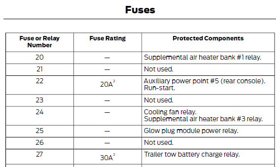

I have 2016 F250 with upgraded 200 amp alternator vs standard 160 amp alternator (part of the snow plow package). I was thinking of installing a 40 amp DC-DC charger but some of what I am reading makes me think I should scale back to 30 or 20 amp because the current is higher from the alternator. Any recommendations?
My 5er currently has 200 amp hour lithium - no solar - but I could see myself going to more batteries in the future.
Pros & cons of connecting a DC-DC charger to the 7 pin at 18 or 20 amps vs 30+ amp charger from the engine bay?

If I was going to use the 7-pin circuit, I would go with a DC-DC charger that outputs 18 amps or less.

Does the manual state the max current rating for the seven pin connector? Personally I would run a dedicated circuit from under the hood to a DC to DC charger to handle the fifth wheel but I tend to over engineer everything
It's a 30 amp fuse. I wouldn't push it that far.

As an electrician I would max out that circuit at 24 amps which is 80% of capacity

Even though our Super Duty had dual alternators, I limited the DC 2 DC charging to 30 AMPS. I had no trouble running our 12' AC/Propane refrigerator on AC and keeping two Battle Born 100 AMP batteries charged while towing.
