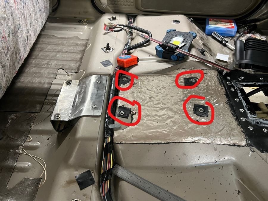

Here is how an 08-10 center console mounts.
And here's how a 2005 Excursion center console mounts (again, I'm assuming the trucks are the same). So the 08-10 does mount differently from the 03-07 , but they still may be a direct bolt in, don't know for sure. But if you have the ability to cut and weld a little on the 08-10 center console bracket legs, it'd be worth a shot.
