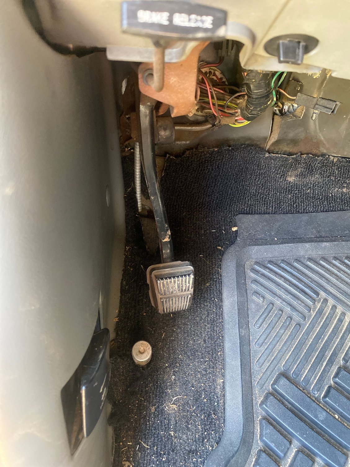

this is where my petal sits

Are your rear brakes adjusted up tight ?

I’m not sure I’ve never taken the wheels off yet, previous owner did rear brakes and he did a lot of funky stuff so I have to look it over

Well, seems "Funky Stuff" is what people do before they sell an old Ford truck. Goes with the territory.
Best to inspect those rear brakes and get them up to snuff before delving any farther into the emergency brake. That will allow you to inspect the emergency brake cables at the rear brake shoes and lube the emergency brake cables.
