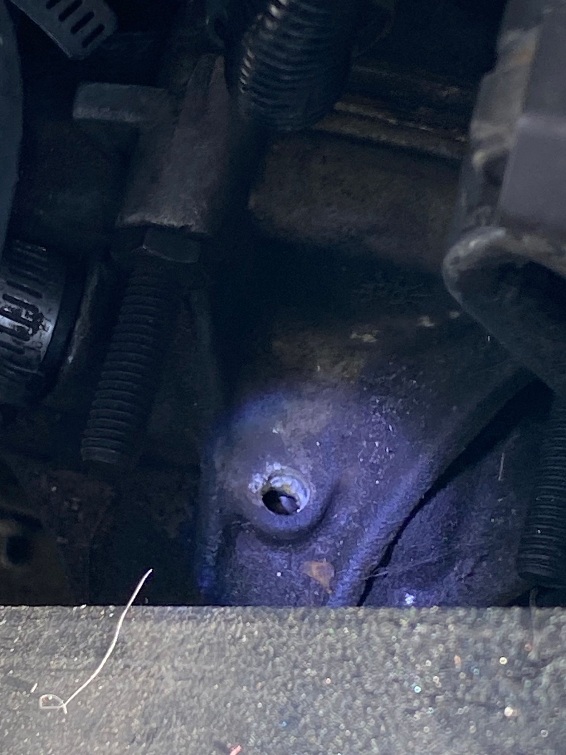

I have an 88 f150 with a 302. I noticed this above the crank pulley under thermostat housing. Is something missing? I see something rotate when I run it

That is the vent hole in your water pump. It's supposed to be there.

I have always heard then called a weep hole. They will leak there when starting to fail and give you a chance to get around to fixing it.
