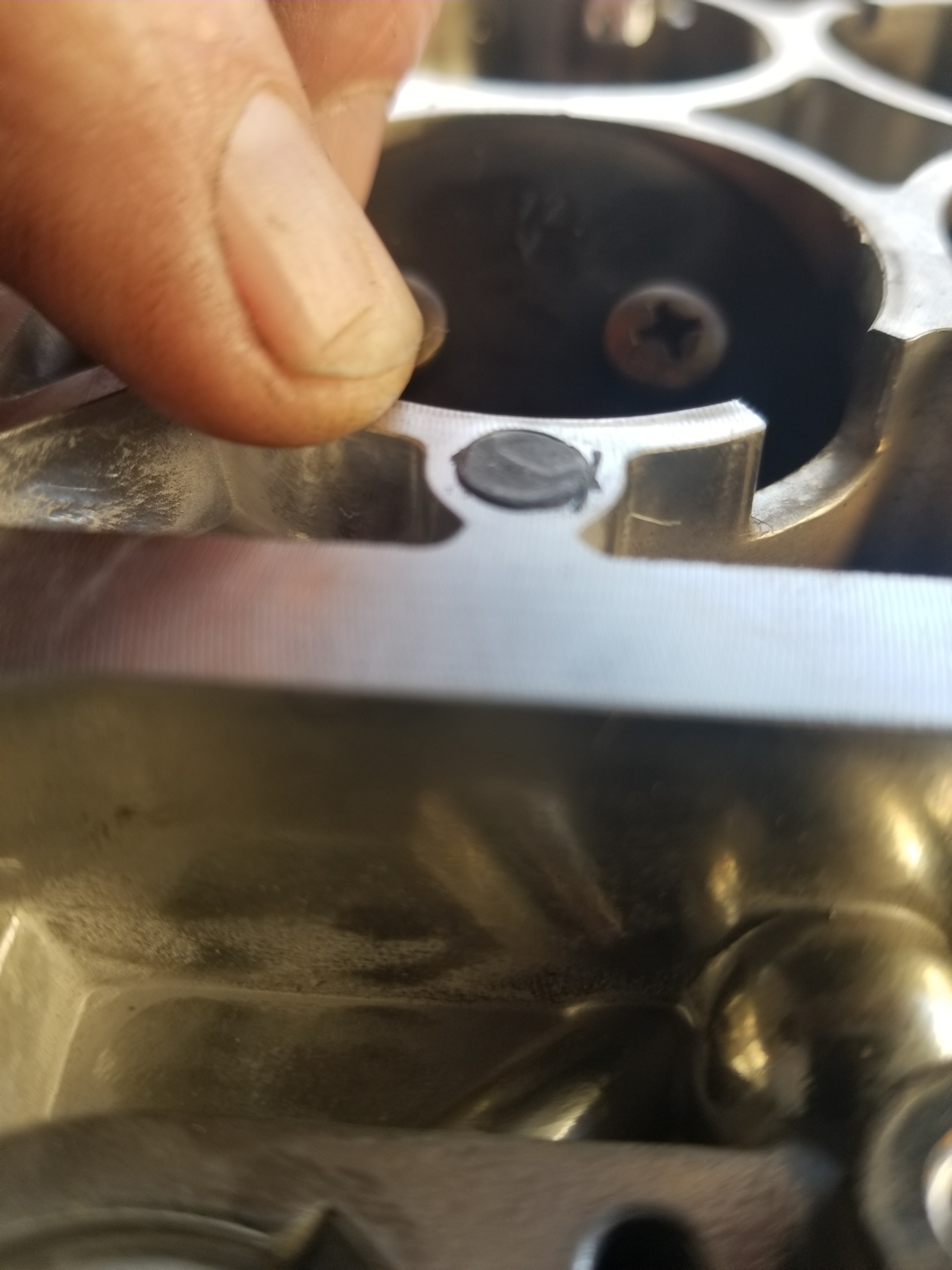

About a year and half ago, I purchased a new Summit 600 carburetor. For me, when I purchased this carburetor, I expected to have it for untold years. I knew that when it got dirty, grit got inside, I would have to take it apart and rebuild it. I accept that. That's what it means to have a carburetor, right?

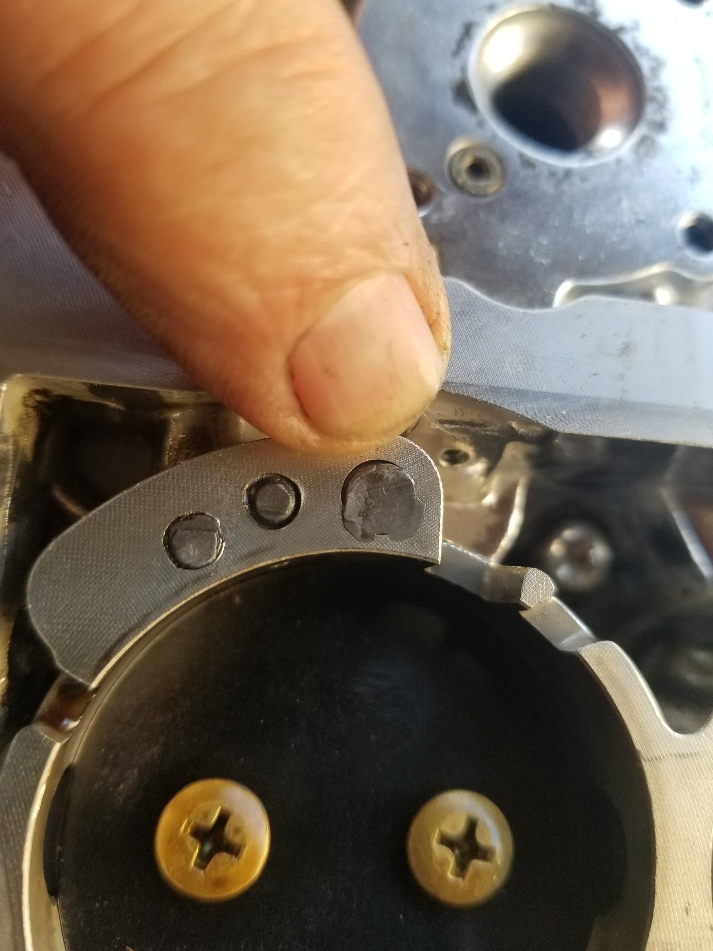

At least I thought so. Imagine how shocked and surprised I was when I took apart my Summit carburetor only to find a semi hard substance had been shoved into several holes in the base plate. I can scratch the substance with my thumb nail. I can see that whatever filler they used had pulled away from the sides of the holes, and that it had not even been milled flat to ensure a good seal at the gasket. Never, NEVER! have I seen such shoddy workmanship, such cheap crap shoved into a hole in a carburetor. NEVER! It is no wonder that my carburetor was suddenly running way lean.
But how could this happen? I had gone out of my way to purchase this carburetor from a company I trusted. I could have gone to one of their competitors, but I went out of my way to choose Summit, because I have done business with them so many times in the past. I thought they were a quality company, not one who would shove semi soft epoxy into holes that were going to see untold heat cycles and be exposed to vacuum and gasoline with ethinol in it.
So now I have a trash carburetor. $400, and all I can do is throw away. Of course the warranty is long expired. Surprise! Who would do that? Do I want to dig out that questionable filler and refill it? Heck no. Quality carburetors are not made like that. This is a case of take the money and run.

An edit .... If mine, I might pull the junk out and using a can of carb spray with tube, find where they go, then if not needed, fill with real JB Weld, the old original stuff, let cure 24 hours (in the warmth of my home), then shave it flush and run it for a trial since I already have it and the kit? It did OK for awhile. With the original slow cure 24 hr version, about 4 -6hours in, you can take a thin razor and skim any excess off even with the tops. A 'sawing" motion as you skim it might help.

Summit, Jegs, et. al. are primarily resellers. The house branded stuff is simply a re-labeled item from nondescript firms who compete primarily or exclusively on price. Typically the product is the same as its more expensive competitors but the materials and the labor to assemble them are much cheaper. Quality control is not done due to cost. Your example is particularly egregious. They didn't even bother to machine the parts that would have made cleaning and repair possible.

I know I should not take this personally, but I can't help it. I trusted summit. I went out of my way to buy their product b/c I knew (ha!) that I could trust them. Only to find that the carb I thought would last for decades had had its channels filled with some sort of goop that softened with age, heat, or exposure to gas, or all of those.
In all of my years of working on carbs, I have only seen epoxy used on Quadrajets around the well plugs.
Come to think of it, Summit tells you that these carbs are made by Holley.
To anyone reading this, the Summit M2008 series carbs are disposable carbs. Use them for uh, maybe two years and throw them away. Very sad.
