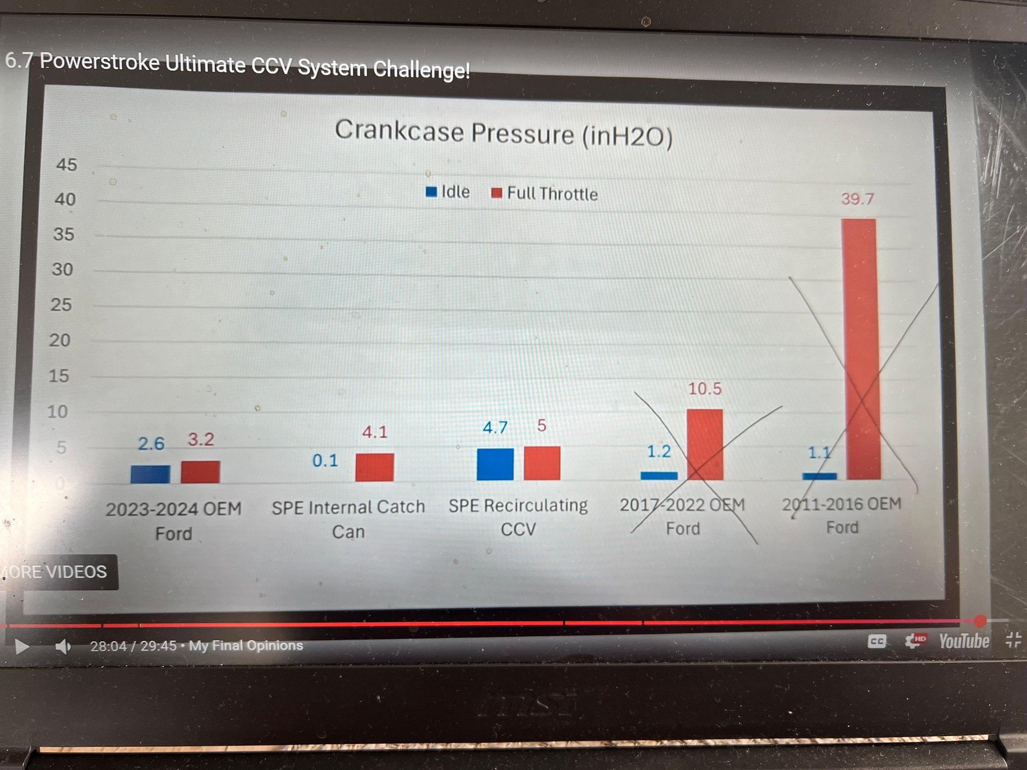

Old May 2, 2025 | 04:22 PM

So what did Ford change to make the 23-24 have the lowest CCP? Now that I see that, not going to touch it on mine. I have been putting off the DPK install for decent weather. Today I took the day off as I am waiting on a delivery of a lathe, but FedEx is playing games, the last update was at 1:29 AM and it was in Tuscon A. How they plan to get it to Rockford to my door today is beyond me, but their app says it will. While I was waiting I considered working on the truck but its only in the mid 50's and damp. If it was sunny and not so damp I would have worked on it, but just being outside a few minutes put a chill through me.

The 23-25 model OE CCV box may have the lowest pressure when new. My question is does it clog up more easily? After I swapped my OE '19 box for the OE '23 box I didn't see any noticeable difference in pressure judging by visible vapor and how the oil cap behaved when flipped over and laid onto the filler neck. But several months after installing it I started noticing oil dripping out of the front of the CCV box where the diaphram is, and then I developed an upper oil pan leak.
My truck is being repaired right now and when I get it back next week the CCV system is going bye bye. I'm not going to put up with these fears anymore.
