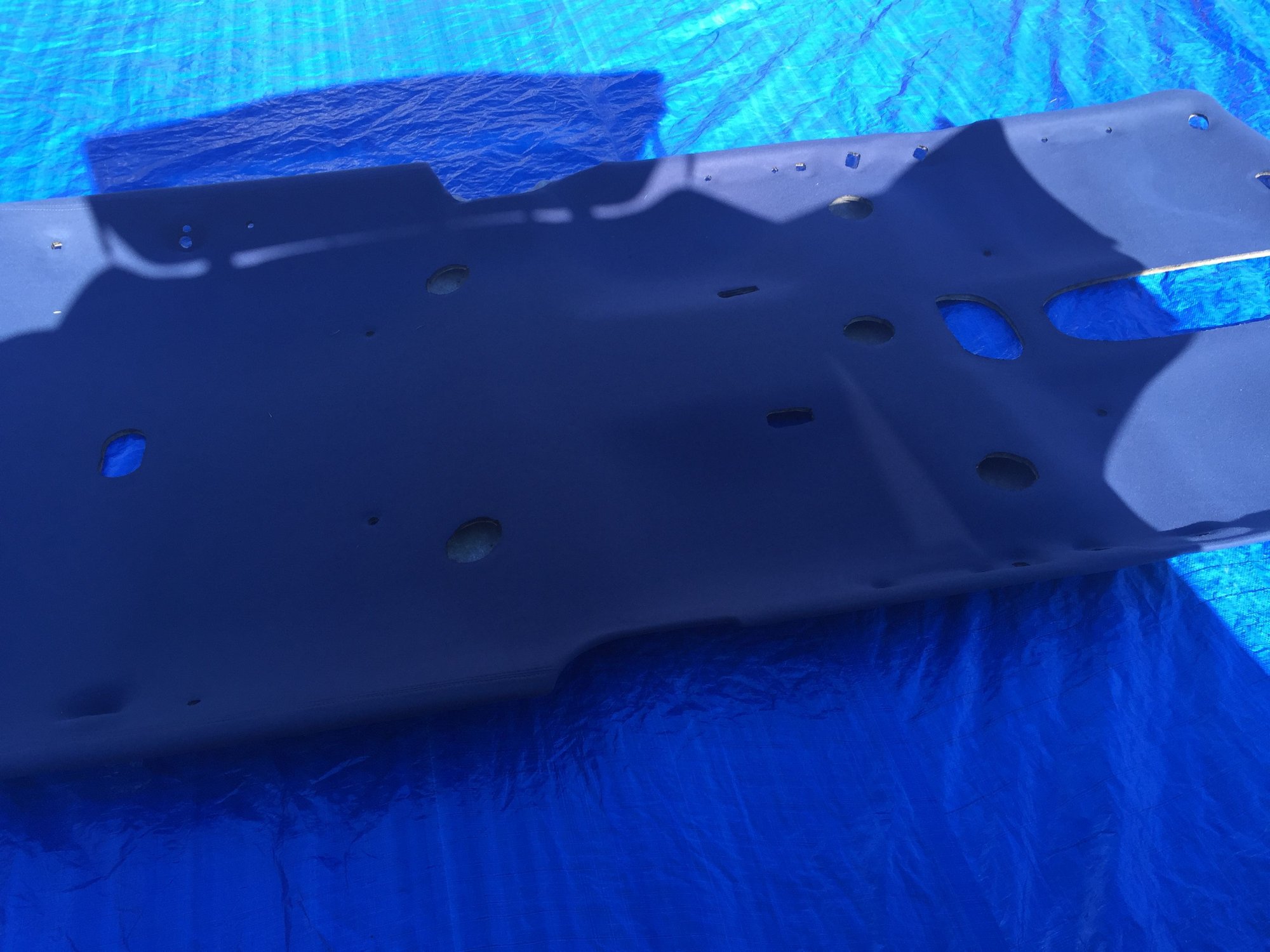

You are correct, I ran into the same thing when I redid my headliner in blue. Some colors are avail in larger widths, others are not. The headliner shop did a french seam on mine, (front to back) where the quarter windows are. If I had to do it again, I would've had the seam left to right where the headliner widens. Either way you just don't notice it. Hard to see in the first pic as there was shade.

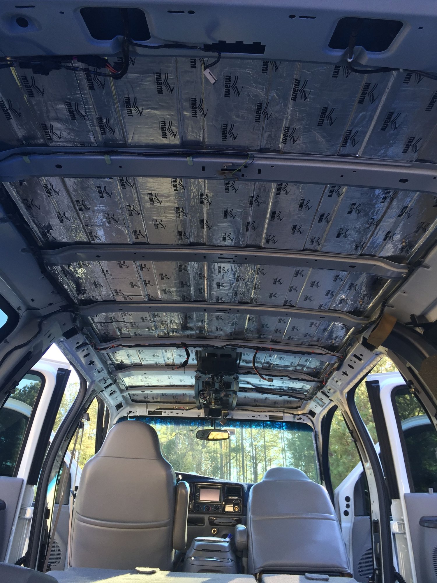

I ended up just taking it to the upholstery shop I deal with on my boats. 300$ and I don’t have to worry about ***** lol. On a side note, I’m into car audio heavy and was wondering if it’s worth it to put sound deadening material in the roof while I have the headliner out
I did just that when mine was out.

i would install sound deadened. That’s a lot of sheet metal. Every bit helps
