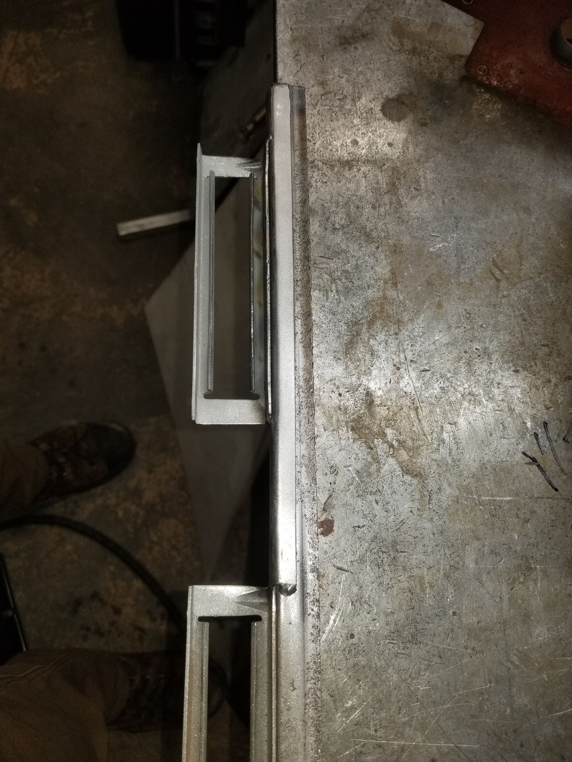

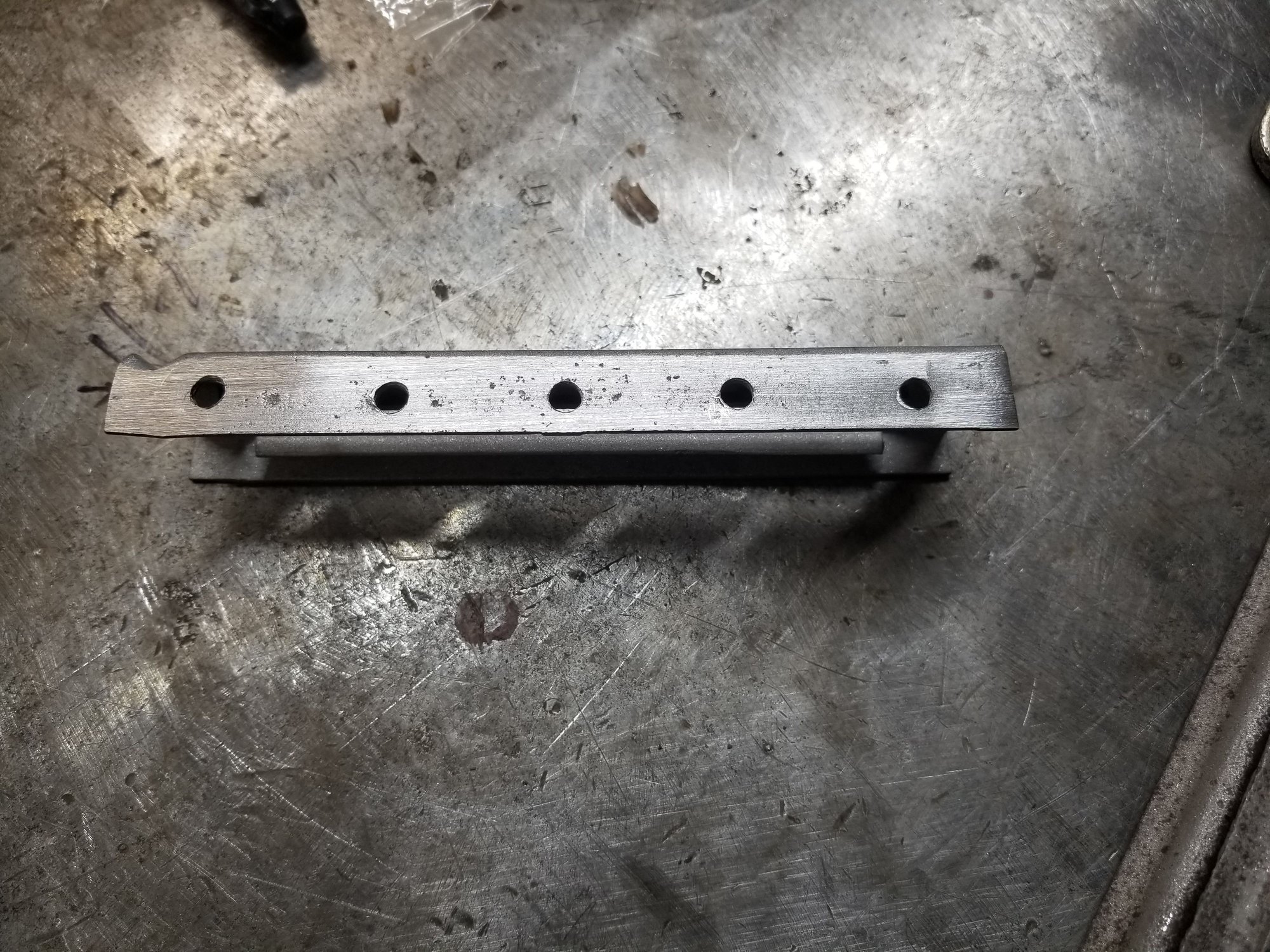

Well Joe sent me his broken window track. After getting it, I cleaned the parts in my blast cabinet. Boy that exposed a lot of rust damage. While I contemplated the best course of action for repair it got set aside due to more snow and the required work that entails. I got back to it today and came up with a repair and talked with Joe before doing the repair. Because of all the rust the channel did not have adequate strength to put a good squeeze on the window tape and glass. So I cut of 17 ga sheet metal on the stomp sheer and broke it into a U channel on the brake. This was a interference fit onto the original channel. It was clamped and tig welded together along with the roller guide that had broke free. The new channel spaced down the roller guide approximately .055 thousands which should not effect operation. It is packaged back up and gets taken to the post office tomorrow for return to Joe.

The roller guide with the original spot welds drilled out for rosette welding.

The complete assembly showing the new channel welded to the original.
Thank for allowing me to do this for you Joe.

That is awesome Dave! Thanks so much for doing this. I wondered what blasting would turn up. You provided a great solution.
