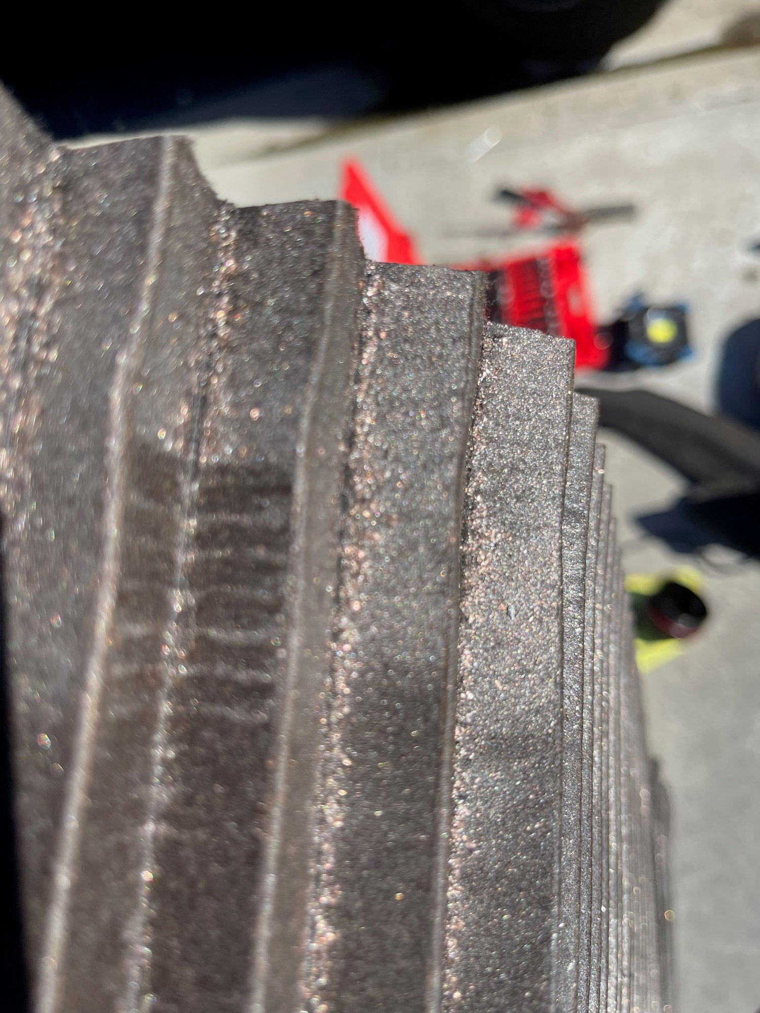

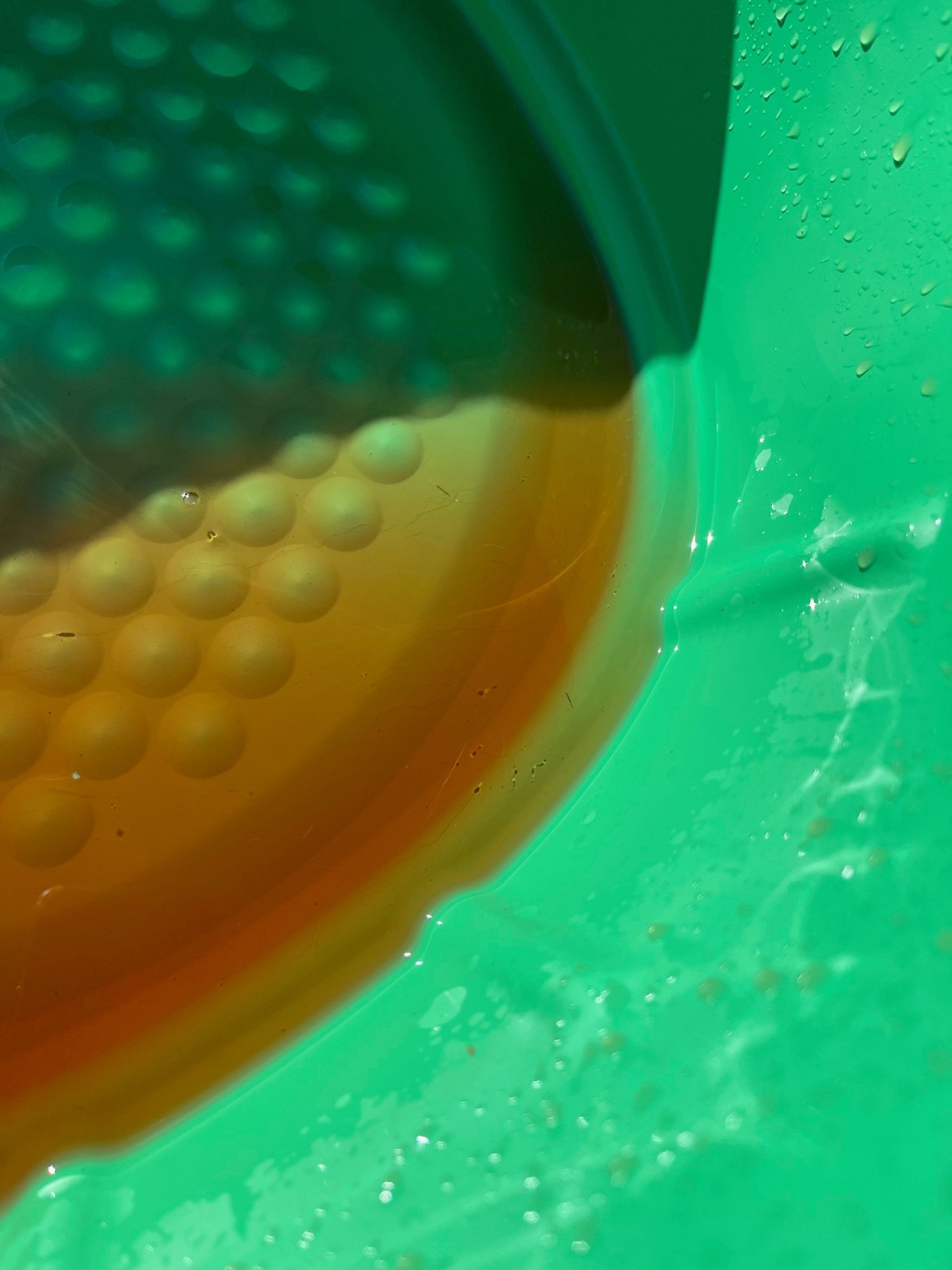

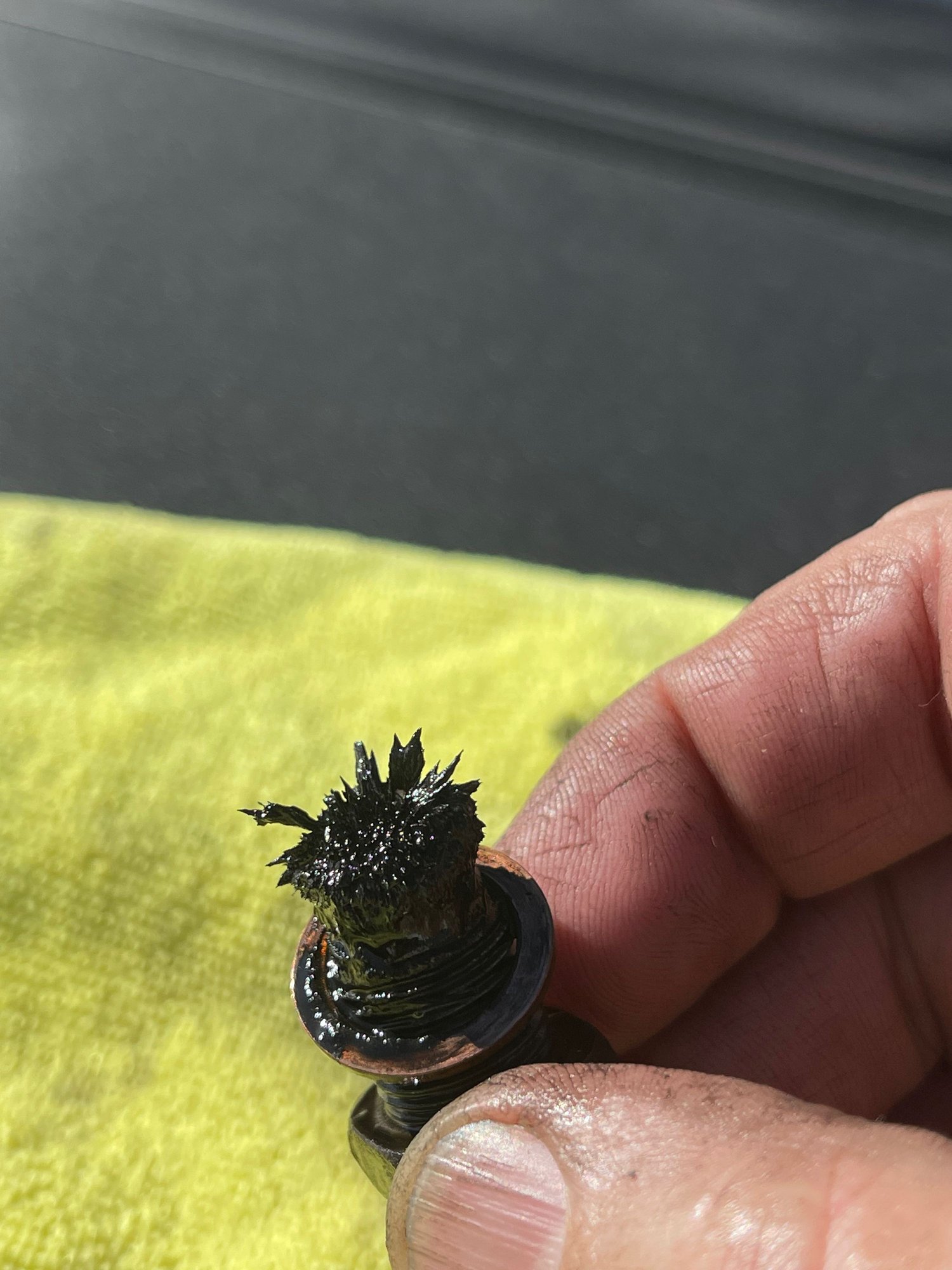

Crap load of iron, a crap load of copper/brass, and dry in the oil canister. It's either eaten the turbo shaft and bearings, or deep into the main and connecting rod bearings. If it's taken out the LPOP gears, it's probably a lifter that came apart, although I had marks on my LPOP gears from debris left in the engine during rebuild. That scratched a few bearings, but nothing like the quantity of metal you have in the filter and on the magnetic drain plug.
Judging by the description of events along with looking at the debris on the drain plug in the pictures provided above, my vote is the portion of the quote highlighted above. I agree with the others above, advising to attempt to spin the engine over by hand on the crank pulley with the belt removed to confirm the engine is in fact locked up. The question now becomes how much money and labor is the OP willing to invest in bringing this ride back to life, or simply cut his losses and move on with life and find another replacement vehicle?
After some additional internet digging I agree a dropped lifter would explain how the LPOP would be taken out. I am expecting the worst since the engine died while struggling to run and wasn't able to turn over after that event. It's hard to imagine that the battery could die in that moment too and that's why it won't turn over, but I do need to rule that out to be certain. The lesson for my son is a good one. Not knowing any background on a 6.0 truck before buying comes with risk. The thing that really sucks is not having any paperwork on the engine swap. I would guess it would be under warranty given that it must be less than 2 years old. I couldn't find the serial number on the engine either. I checked the oil out a bit yesterday and it doesn't look bad - I might run it through a mesh screen to see if there is anything in there. If I get the energy today I'll try and turn this thing over manually. But I'm weighing the value of investing all that time and energy if this is a worst case situation. But if I do take it all apart and find out that it is locked up I guess I won't need to spend the time putting it all back together.

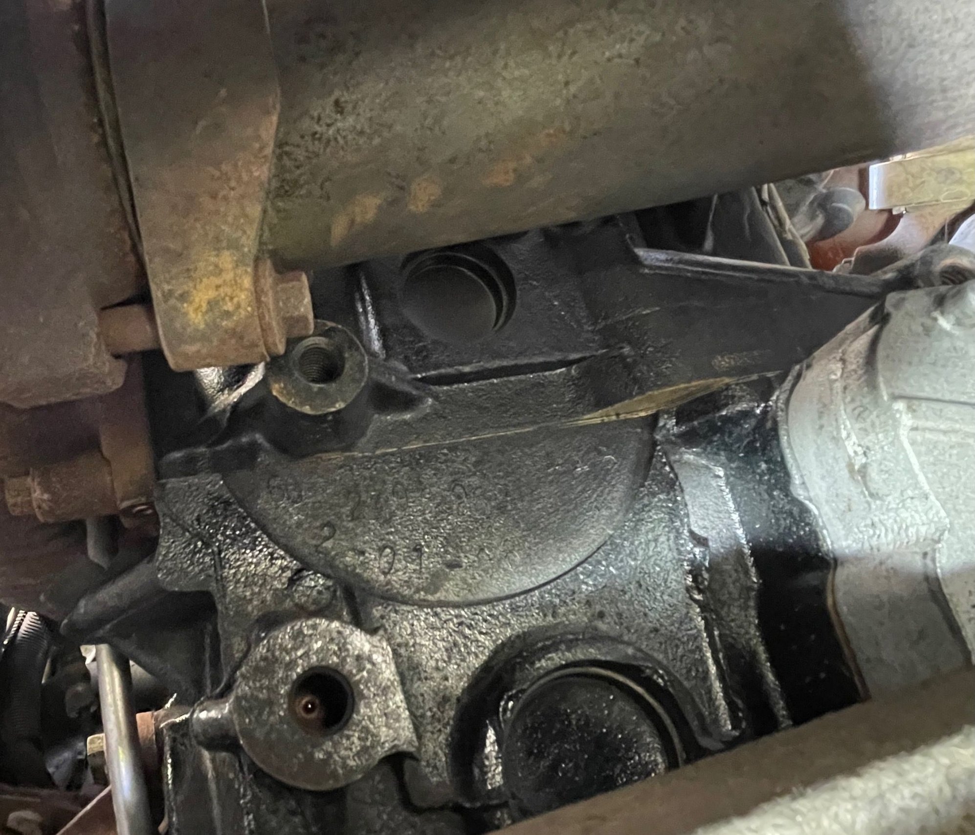

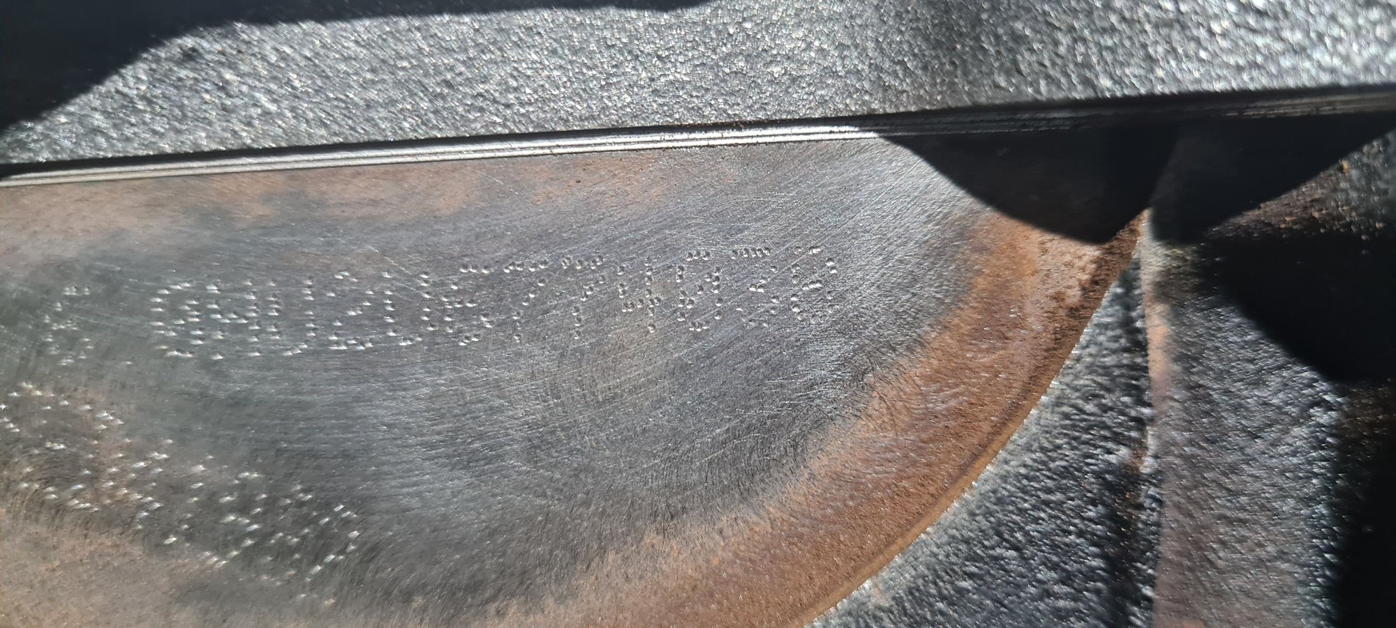

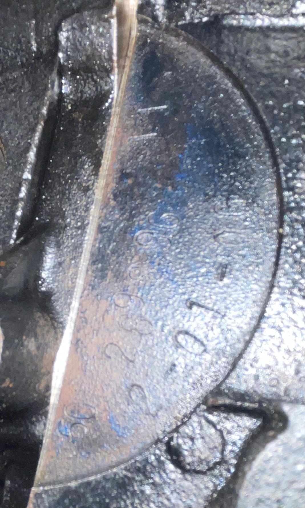

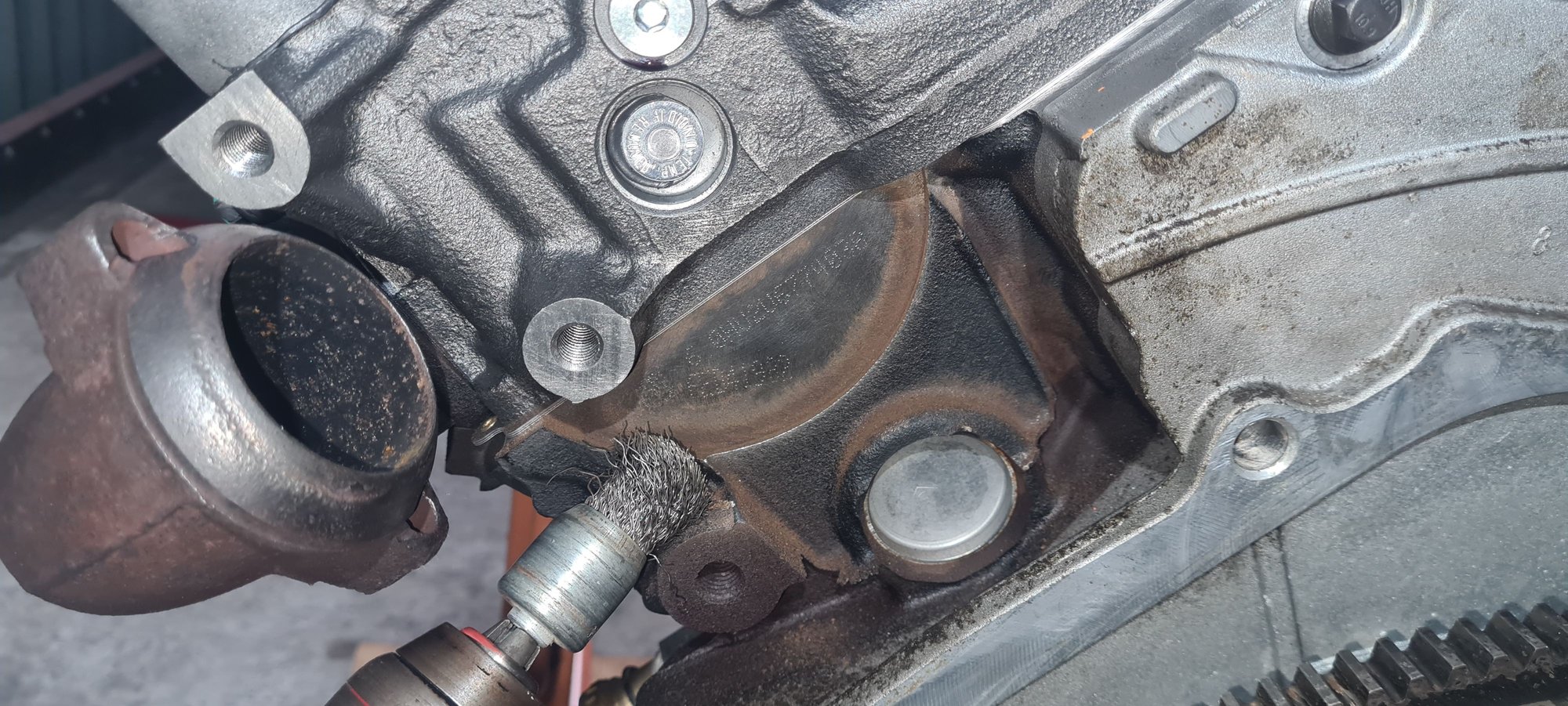

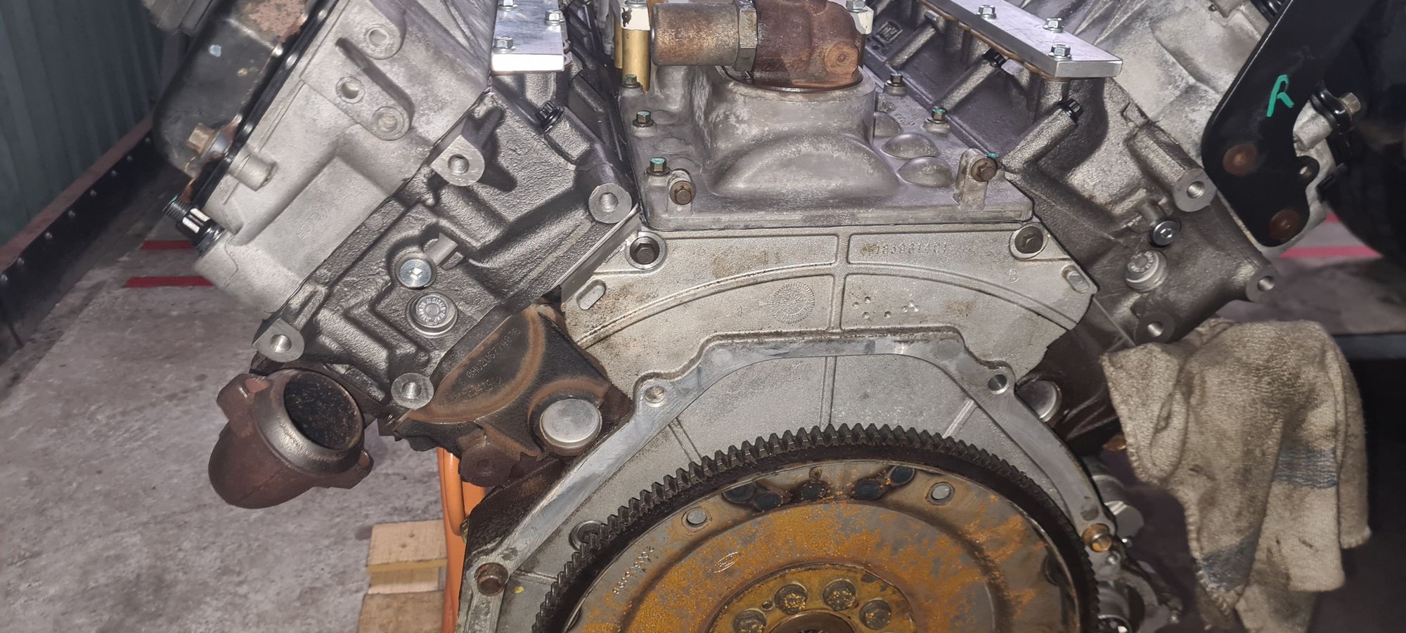

Serial no. location.
Probably the designers were drunk when they decided on this place for the ser.no.

Thanks for that serial number location. I took a few photos yesterday while hunting for it. Looks like I was in the right spot, just can't see the whole number. I'll try and get a wire brush on it.
I don't enjoy raining on anybody's parade at all. But based on the way you've described the events in excellent detail, I suspect the worst as well. And I'm sorry this has turned into a seemingly very expensive lesson for your son. As far as the batteries go, attempting to turn over any non running 6.0 or 7.3 diesel with even brand new fully charged batteries will deplete the charge very quickly. Persist in attempting to crank non running engine will burn the starter out along with the batteries. Ask me how I know, even though it's been years since I've gotten my hands dirty working on a 6.0. That said, I'm fairly certain that weak batteries are only a result of your issue, not the cause by what you describe.

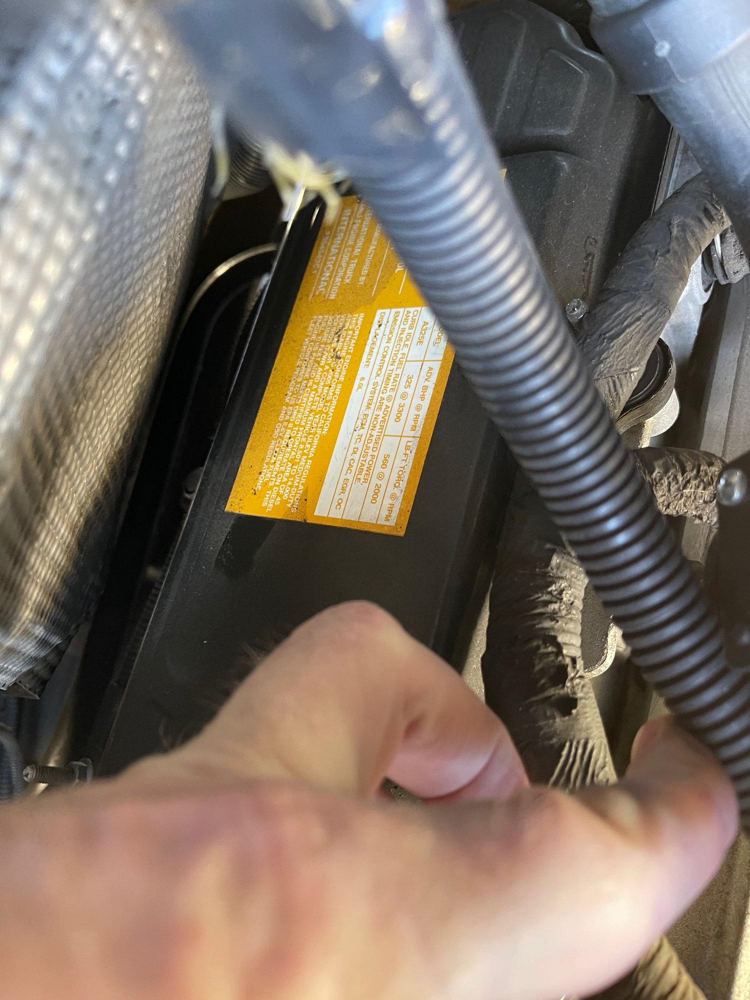

The Asheville guys asked me to confirm the type of HPOP in our Excursion. Evidently Ford ran the 2004 parts into the 2005 Excursion until they used up inventory. I found one post that said the cutover happened in January of 2005, which happens to be the build month of this truck. Given that the engine is not original I couldn't thing of any other way to confirm besides pulling the turbo. This looks like the '05 style pump to me (see attached photo). Would you guys agree?
I'm also curious about the origins of this engine. I spent some time trying to get a good shot of the serial number. Best I can tell it reads 2-01-06 on the lower part, 289896 across the middle, and 60 in the upper left corner and 11 in the upper right corner. I think this means it is not a Ford Remanufactured engine. The International sticker on the valve cover says 2005 model A325E.
