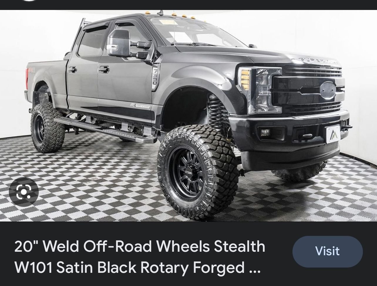

I want to know if “flow formed” made in the USA wheels are better?
im interested in a set from Weld Racing that are flow formed
here’s a quick article on how they test their wheels and some pics of the set I like.
ARTICLE:
https://www.streetmusclemag.com/tech...ormance-wheel/
