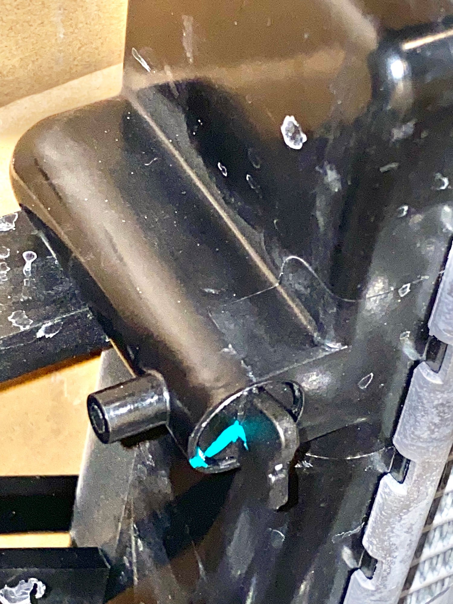

I got a new radiator for my 1988 F-150. It lets me blow air into the drain closed and open. Is this normal?

No. That's not normal. The valve should close and prevent air from blowing in or out. Unscrew the valve completely and look closely at the valve. There should be a rubber seal at the end of the valve to keep coolant in the radiator.

Am I able to get it out? It only turns a quarter turn both ways before it stops. It’s not like the stock one that unscrews all the way.

Ohhh. After market parts. Yah. I am not sure then. I would expect the valve to be removable, but anything is possible with Chinese parts. If you got it from a local auto parts store, take it back and get one with a good valve.
