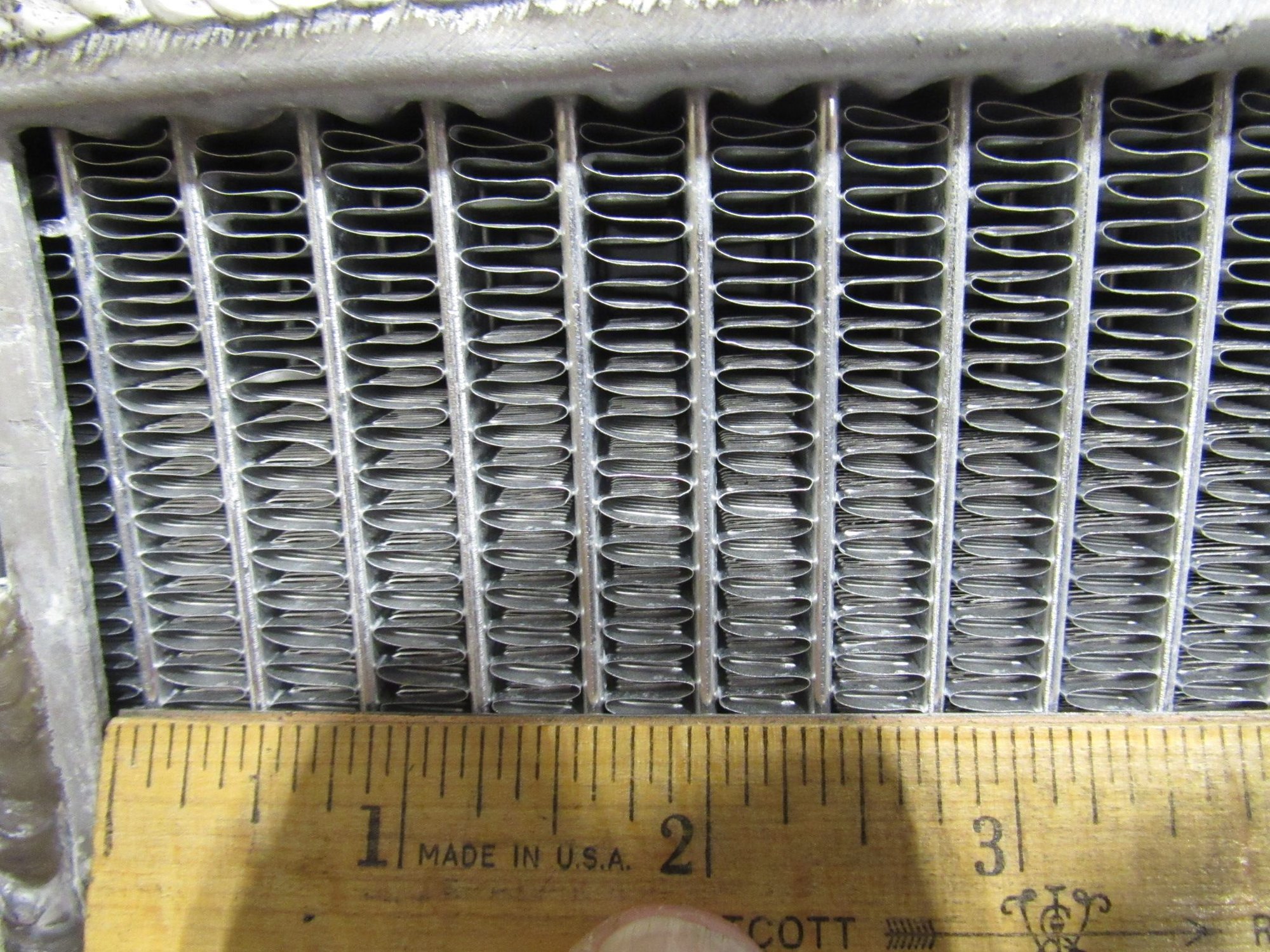

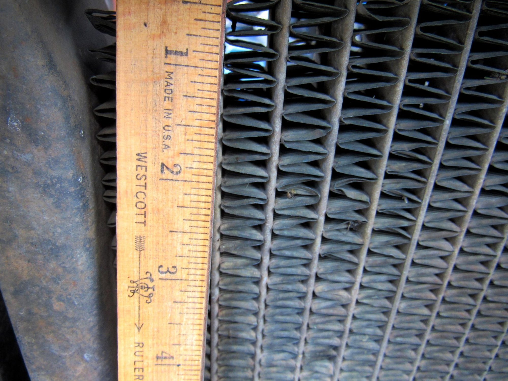

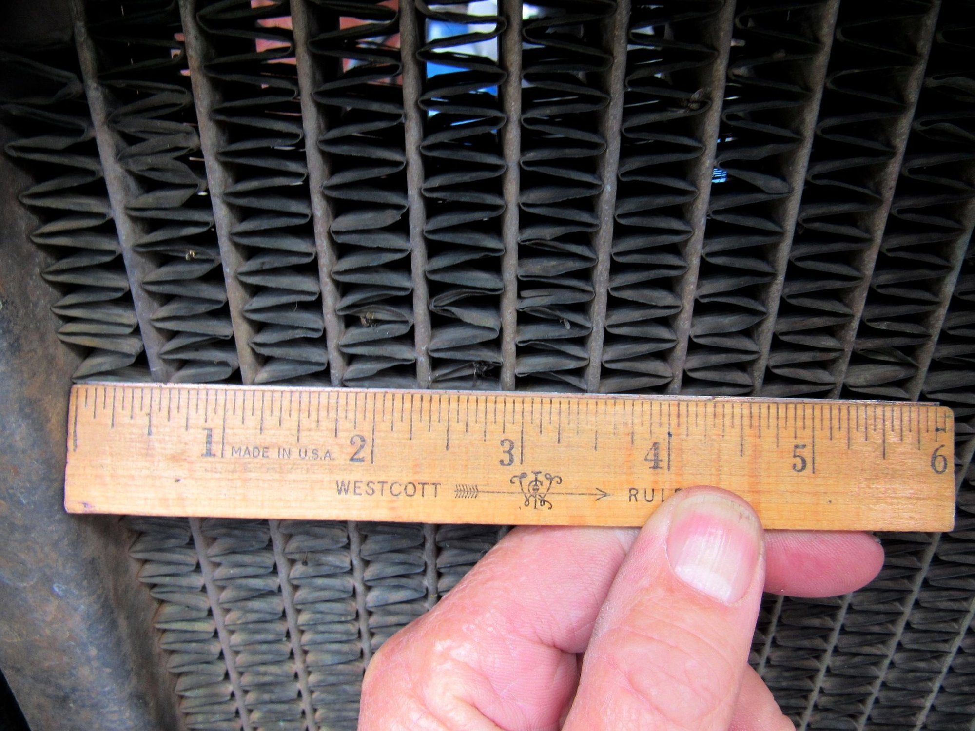

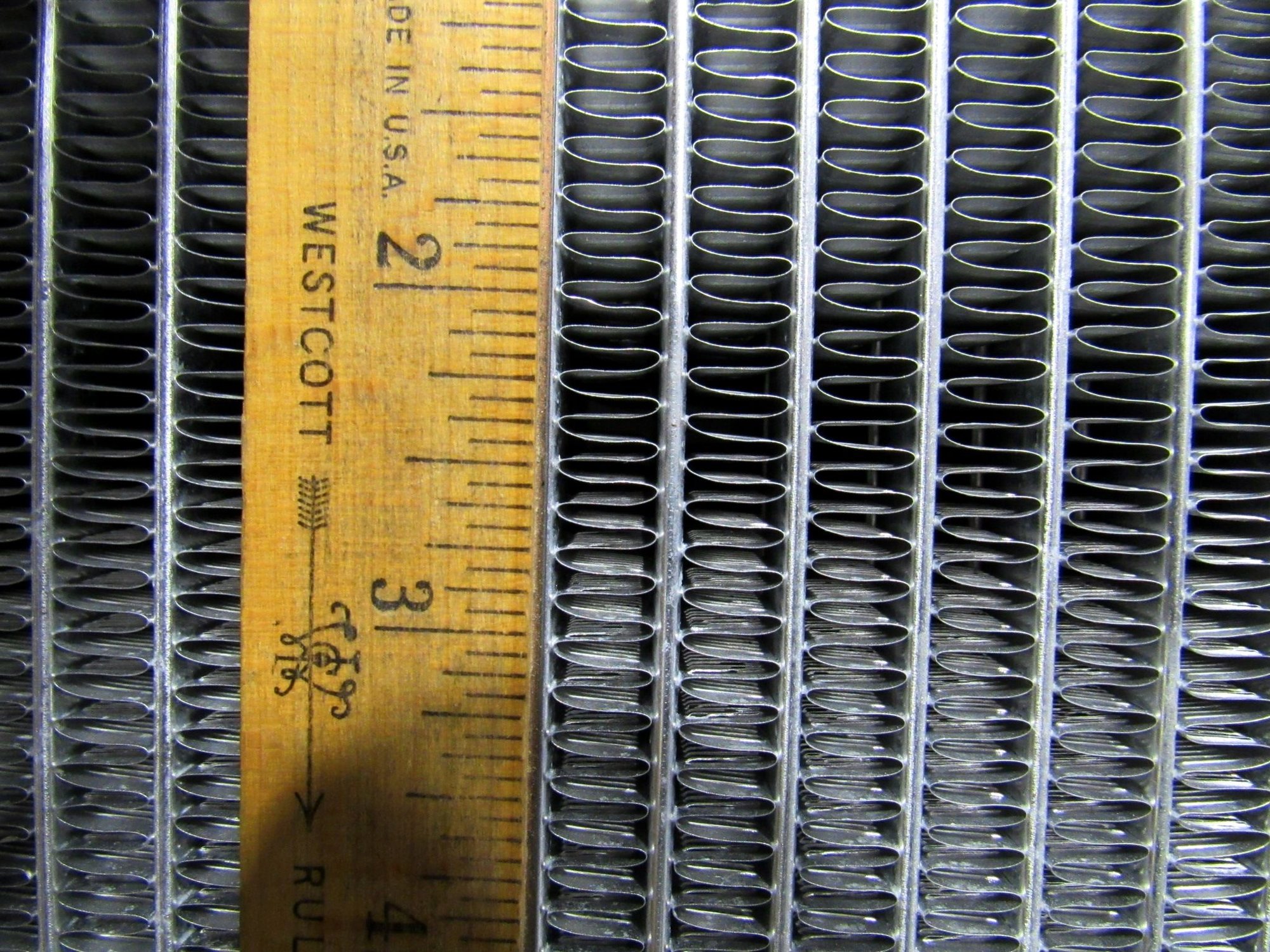

Size doesn't always matter.
Here's the current radiator in my 1976 F-250 4-wd. The truck has a 390 but came from the factory with a 360.
This factory radiator has 43 rows of tubes and 10 cooling fins per inch.
Here's my new aluminum radiator. It has 65 rows of tubes, 50% more than the factory radiator.
It also has 16 cooling fins per inch, 60% more fins than the factory radiator.
Even though the outside dimensions are smaller than the factory radiator I have no doubt that it
will cool equal to if not even better than the OE radiator.
