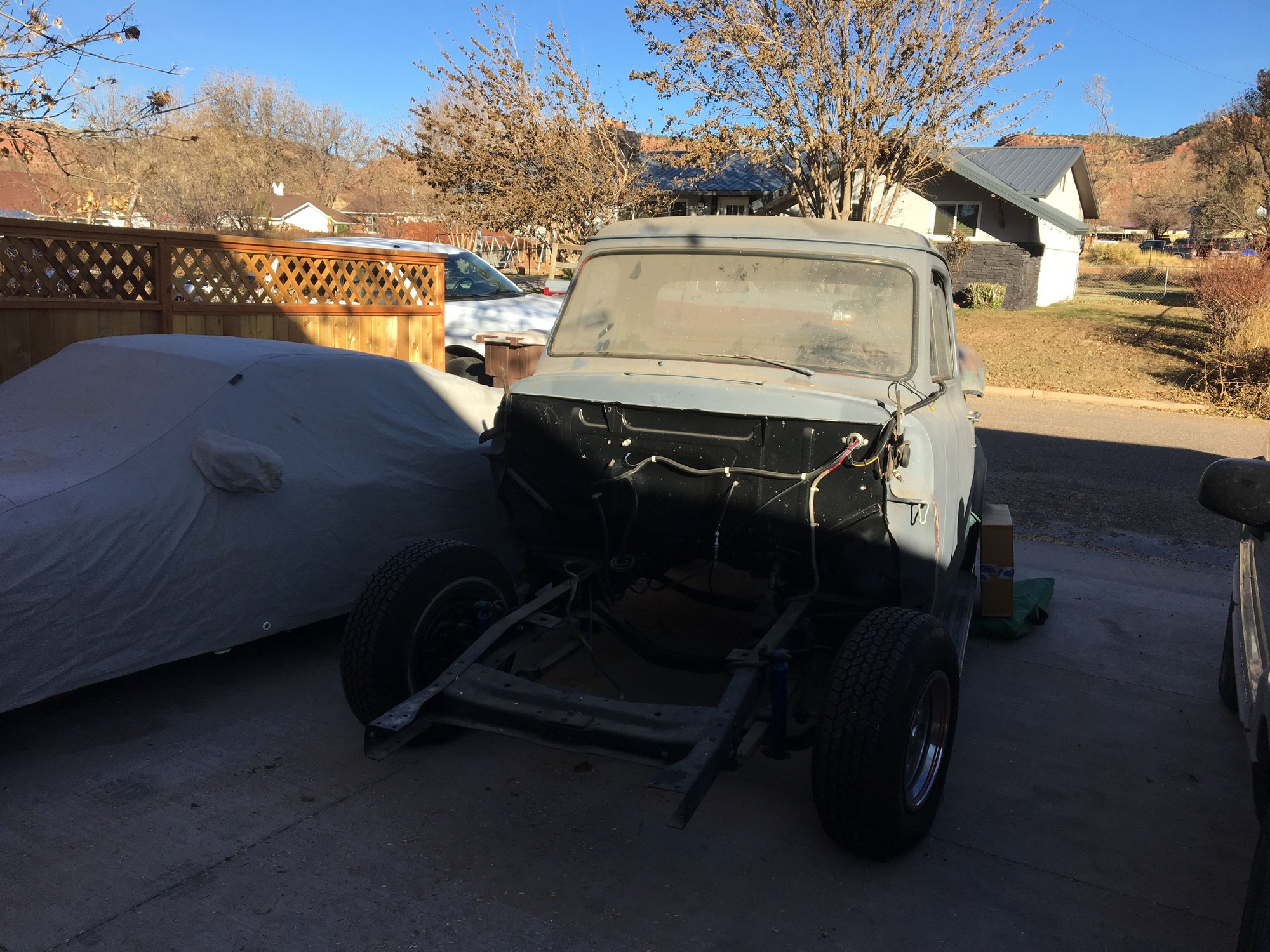

Being a relative new member to this group I'm not sure how to do the right thing here. I have a 54/55 F100 that I am doing a frame off rebuild to make a driving and usable farm truck with a little more zip than original. I'm confused with the albums vs build threads and wonder if I should even bother will a build thread as there is some talent on the forum that far exceeds anything I can do. I do weld a bit and have built and rebuilt a number of hot rods and old cars in my life. This time I plan to do the whole dang thing in house, literally. I never done body work, nor have I painted anything past primer and never have done upholstery and this will be the first time for everything. I have done considerable wrenching and mechanical work but I have always left the paint and upholstery to the professionals.
The only reason I consider moving ahead is that my pictures and solutions may help others in the future as others have helped me throughout my life. Here are the only two pictures I have of when I brought the truck home in the fall of 2020. By spring Covid broke out and we decided to move to Colorado so everything F100 wise was put on hold. The post Christmas snow a couple of weeks ago brought me back into the warm shop and work commenced on the F100. I will make some posts as I move ahead with pictures as I go. If I'm doing something wrong I assume the moderators will set me straight. Here we go.
Front view September 2020
Rear view with all the parts September 2020

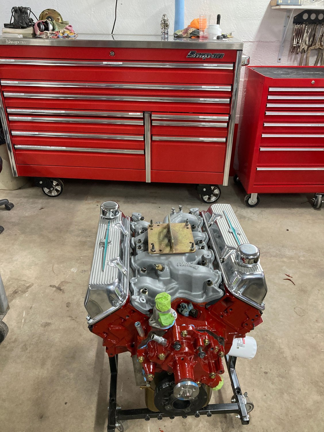

Here are some updates and pictures. Forgive me if I repeat myself in this thread. I'm past 80 and should be watching daytime TV instead of building another truck but it keeps me doing something constructive. I lose track of whats here and whats on the HAMB. I have decided to just finish up the build thread here as there are some things that are not HAMB friendly and I'm kind of tired of hearing about it.
Last fall I pulled the truck into the basement/shop. When the cold weather and wind started just before Christmas I finally started back to work on the project. I bought the truck in the fall of 2020 and was rebuilding a 9" rear end, a T5 trans and going through the Cleveland engine in the spring of 2021. I pulled the engine down, platigauged the rods and mains and pulled the heads. This engine was barely broke in and it all looked good. Pistons were .030 over and the hone marks were still in the bores and there was zero carbon build up. I sent the heads of for new valve springs and a 3 seat valve job. The machine shop said the heads were perfect and it was probably a waste of money to touch them up but we did it anyway. I bought a hydraulic flat tappet street cam from Comp, which is the only thing I have reservations about with all the talk of cams going bad. I almost decided to pull it back out and go with a roller but money is tight so I'm going to run it till it proves to be bad. I had the engine almost back together and was in the process of degreeing the cam when we packed everything up and moved to Colorado. Its hard to remember where everything went but I have finished it all up and its waiting for a couple of bolts and an alternator and its ready to go in the frame for a test fit. I originally wanted a Y block but the Cleveland came up first.
I think T Bird valve covers are the best ever so I got a pair of plain Ansen v covers and put a pair of TBird trim pieces on them. I painted the block with Eastwood Buick red engine paint. I used Eastwood aluminum over the aluminum Performer manifold. A polished intake isn't an off the shelf item so this looks ok and will be easier to keep clean than the bare aluminum. The pan had seen better days so I put a Mildon pan on it and it looked nice enough that I just put a clear coat on it and left the yellow zinc showing. When I get all the correct bolts in the front of the engine I will pain all the yellow grade 8 red as it looks a little to gaudy for my taste as it sits.
The engine has been sitting on an engine stand for two years so its good to have it down where I can get the clutch/bellhousing on it. Finally some progress
351 Cleveland
351 Cleveland

That 351C will look great in that truck. It certainly will move it along real well.
