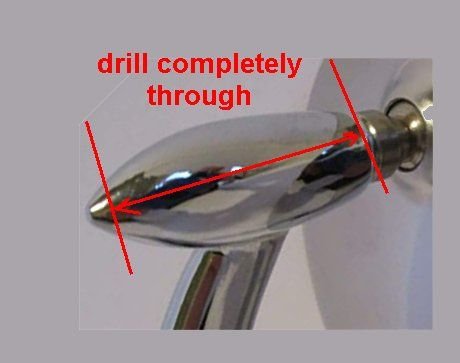

I have a mirror mount on my truck door that held a rear view mirror. Unfortunately the mirror decided it didn't want to stay with my truck.
So, I'm looking for a replacement, well actually two since I want the mirrors to match. The mount is drilled and tapped for 1/4"-28 threads. Threads about 3/8" deep and the rest of the mount is hollow. Most of the mirrors I find is 1/4-20. I'm wondering if I can
re-tap the metal over existing threads with a 1/4-20 thread and it will hold...(maybe use some epoxy inside the body of the mount ...........or will I just make a mess of it and make it broke. The drill size for the
two thread sizes are within a 64th or so of being the same and the mount is 7/16" or so wide so I have some meat to play with...
another option... drill completely thru mount and find a mirror with a stud long enough to pass thru completely
and secure with an acorn nut (or something) at the back side of the mount
another caveat... I don't want to remove the mounts from the door... involves removing upholstery and windows and regulators
to get to the internal nuts.
suggestions?

Are you sure it isn't metric? An M6 x 1.0 would be nearly the same size and is 25 threads per inch.

You could drill out the arm and heil-coil to 1/4-20 or cut stud off mirror head and tap and put stud in it.

never installed heli-coils before but understand the principal and it's easy on youtube. The mirror mount is 7/16" wide at the mounting face with a 1/4" hole
a 1/4" helicoil needs a 17/64 hole to tap for the coil.
7/16 = .4375"
17/64 = .2656"
leaving a difference of .1719 or just a fuzz less than 3/16 total
I don't know how to figure the depth of tap thread cut or if it even matters
3/16 = .1875 / 2 = .0937 or 3/32 edge around the hole
I think that will leave enough material to hold the mirror... there's not really a lot of lateral force there.
tell me why I'm wrong
Also the thread depth now is only about 3/16 deep. Do they make a helicoil that short ?? or
feeling around with a piece of tie wire , it doesn't feel like the current inside diameter is much larger than the threaded portion so
the drilling/tapping might give a bite for the coil deeper inside the mount.. keep in mind that I'm doing all this conjecture thru a 1/4"
almost blind hole.
If this is feasible I'll do the drill/tap/insert with red lock tight (after I dry test the hole.
