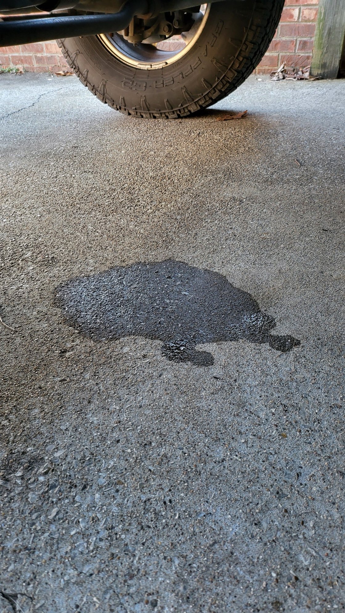

It's dry under and behind the master. Just had the rears calipers, rotors and pads done too. Peddle felt like a very slight sinking at a stop. Good thing I believe in test drives before real adventures.
No leaks at the calipers or stainless lines so it's most likely the main near the drivers feet.
Digging in soon. The fun never ends.

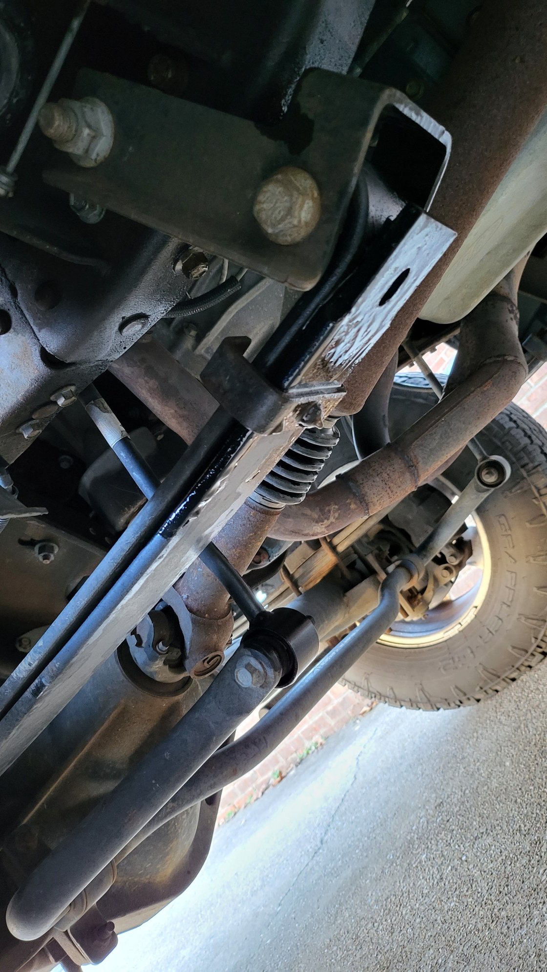

Unfortunately I think I see something else I don't like in one of these pics. Double uggg.

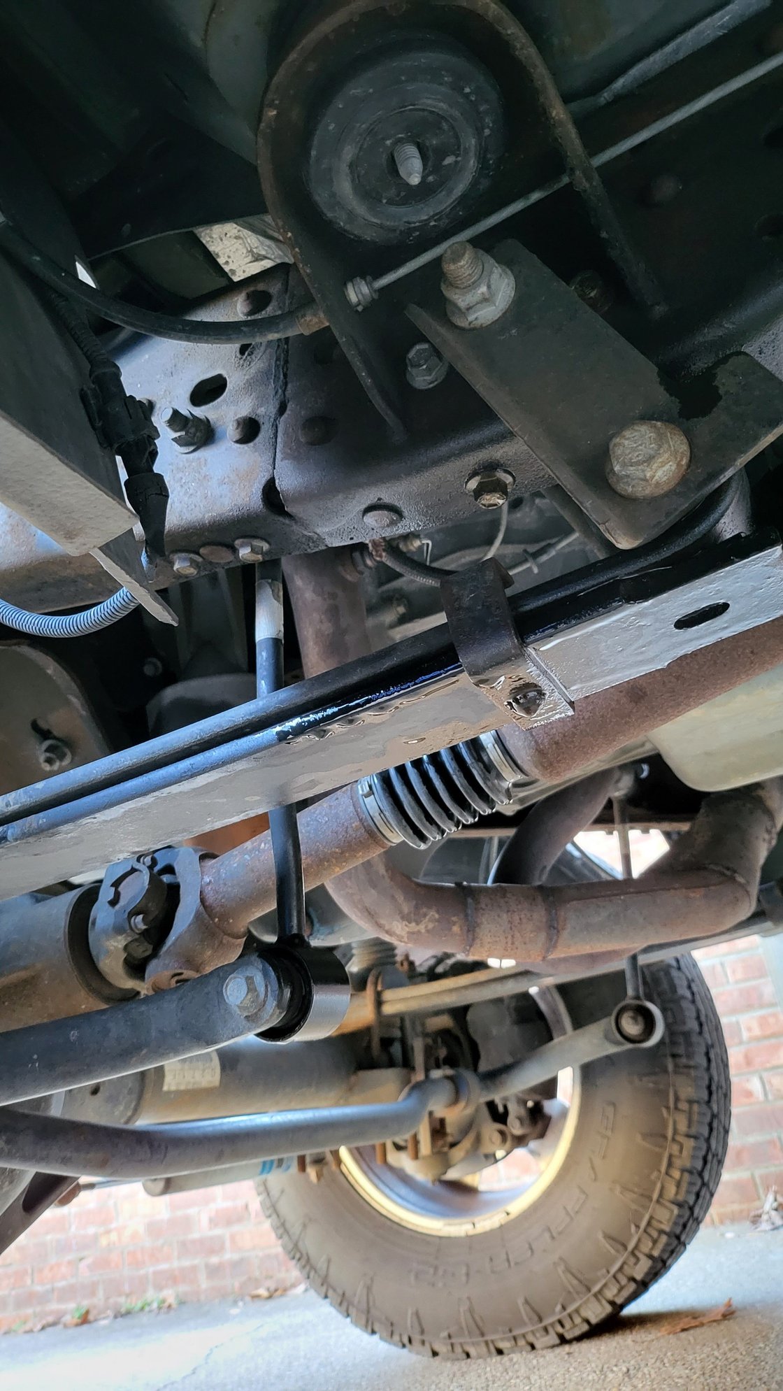

Yup, main line to the new rears...

Lines set is ordered and a new nicopp junction is temporarily added. She stops like a beast once more.
I work from home, so I may wait until the infamous Cummins conversion is in full swing before replacing them with the Dorman stainless kit.
Too bad Dorman didn't make those in nicopp.
