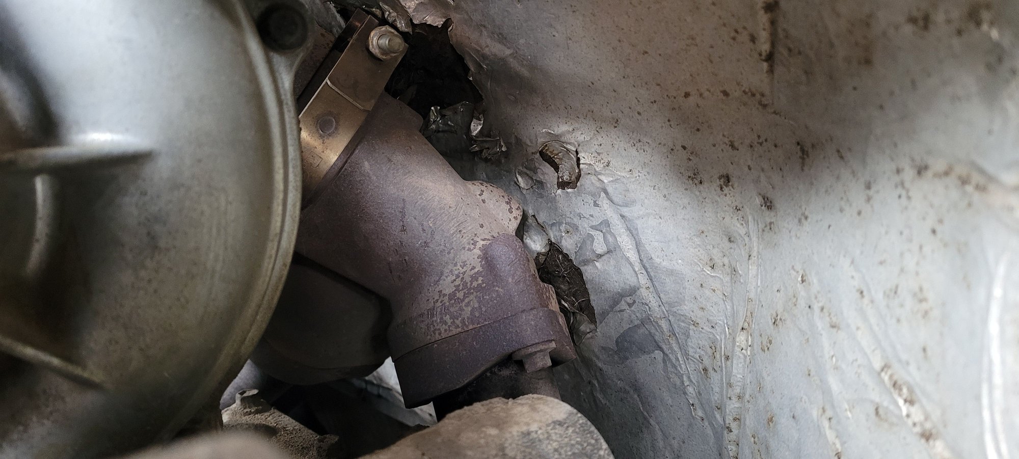

I saw videos of the uppipes thinking that could be an issue. The replacement didn't look quick. Definitely looked like an afternoon of f-bombs. I went searching for soot and surprisingly, didn't see anything that would indicate a leak. Is there an easy way to remove and replace those uppipes?
View rear of uppipe/turbo.
View towards / behind turbo

I also did not spot any soot in what can seen seen in the first photo. The second photo is of the downpipe.
Look well behind the turbo and down where they connect to the manifolds. Maybe you’re a lucky one!

Good idea to check for boost leaks! Anywhere around the boots under the spider or the plenums are typical.
In the pics the truck looks very original. Good find! And with 300k the OEM up pipes are surely leaking. It's a design flaw. One of your pics almost got it; put the phone close to the up pipe. Looking for soot on the up pipe blown down from the cast iron collector above. There is cheap short term fix but I recommend the cure, bellowed up pipes. And yes they can be a biotch to install.

Still can’t see the needed area of the uppipes well enough for a positive determination. Usually leak at the section directly below the clamp. You’ll need to check both sides.
