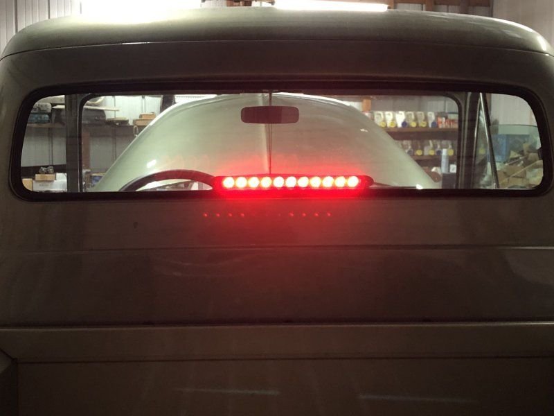

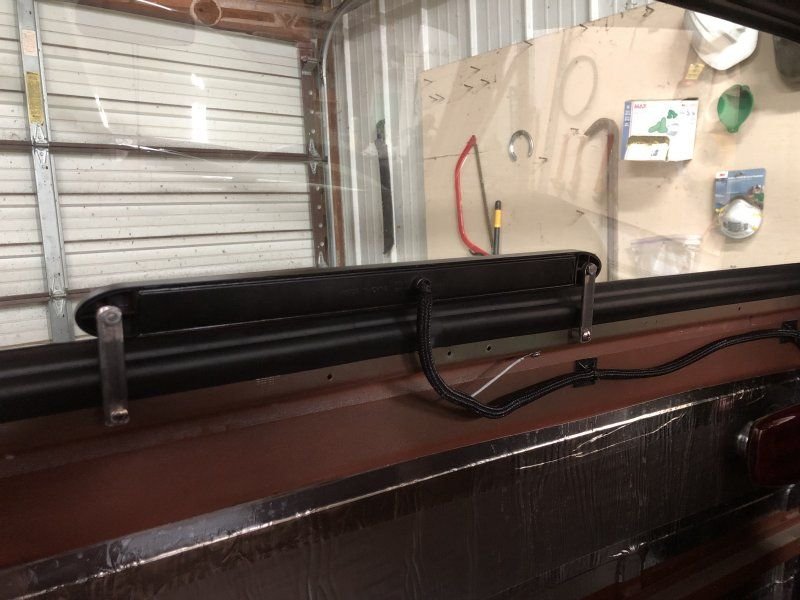

Mine is mounted with a couple of brackets that will require two holes and a slot in the lower back panel.
I'd like to see the tape mounted light Greg used.
Mine could be tail light/turn signal, but I just wanted it for the brakes.
Mounted with metal brackets, yet to be painted.
Hardly noticeable when dark.
Very bright when lit. This picture does not do it justice.

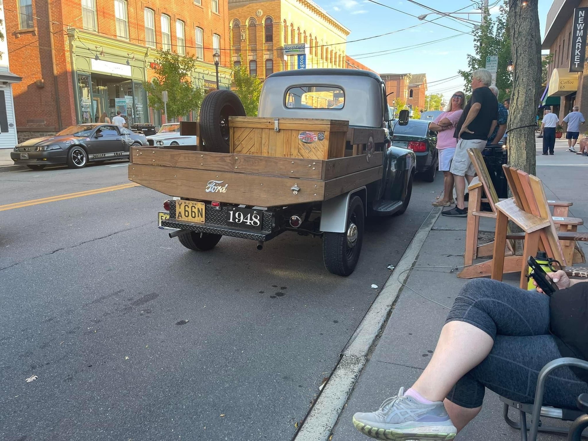

My truck is a flatbed with wood sides. I installed a marker light as 3rd brake light. It’s an LED but works fine on 6v. I wired it to the pressure switch. You can see it directly below the Ford logo. There’s a second LED directly under the brake light, a white one I installed as a backup light. That one is wired to a rocker switch under the dash.
