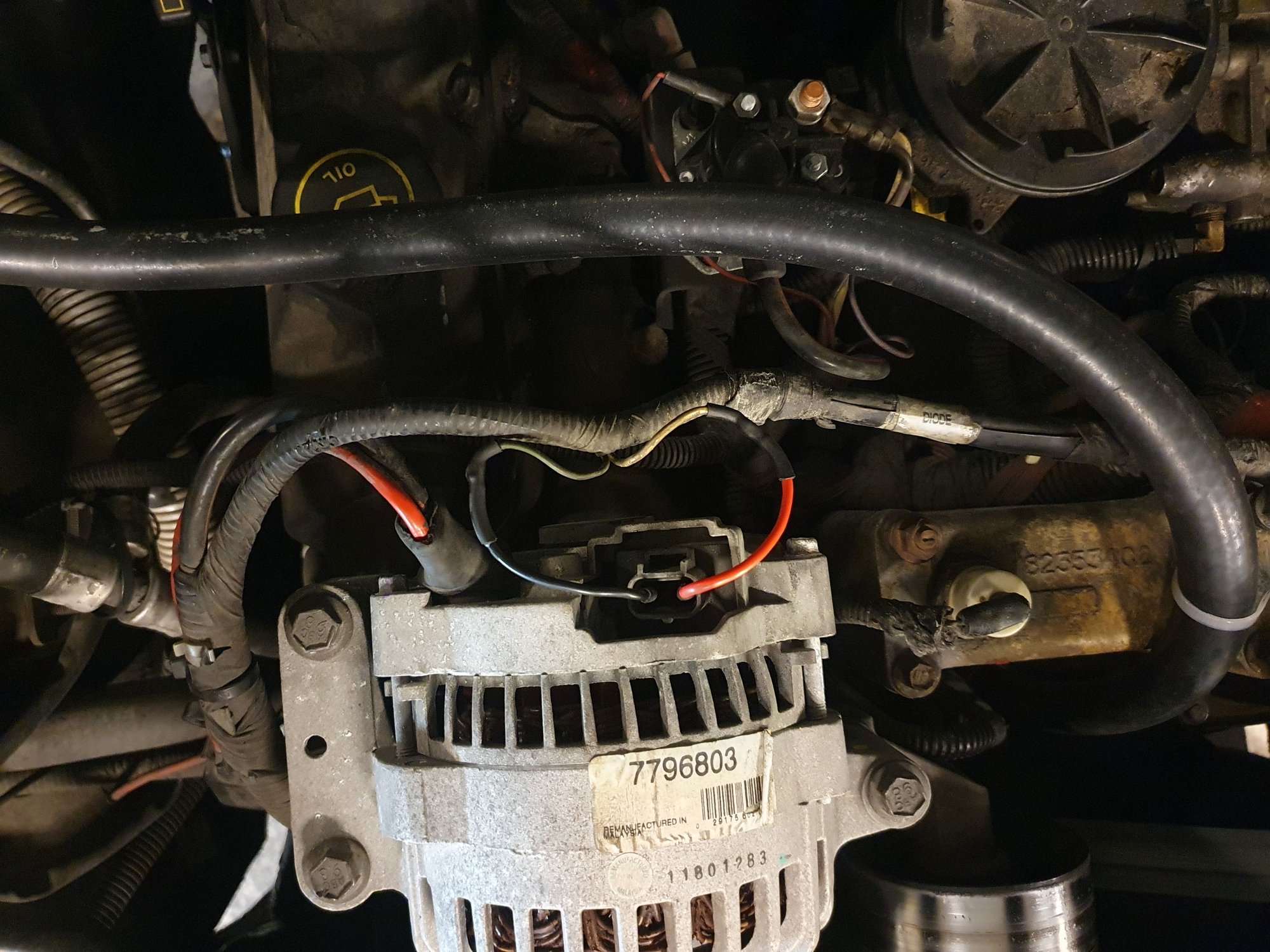

So instead i changed both front door locks, and soldered some new wires with pins to the alternator connector. The original connector kept falling off in big bumps on the road.
I didn't use the middle wire since it was just a lose connection to nowhere. Maybe it's only for dual alternator setup.

I have middle wire and it goes to a post on the Alt
you may have a newer style alt that does not need it

This is what mine looks like.
My connector is the other way round, yellow and green wire is opposite from yours. Don't know if that means anything.
The original connector didn't fit so the previous owner cut some pieces of it and zip tied it on. I just cut the wires and connected the wires in the same position as he had.
