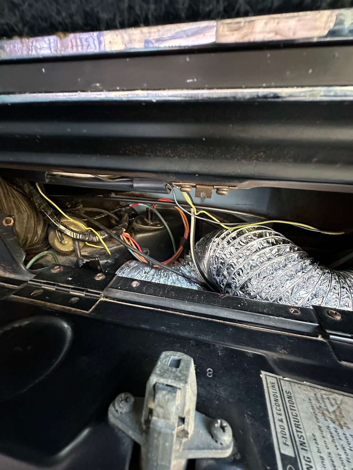

Anything jumps out at you for me to look at?

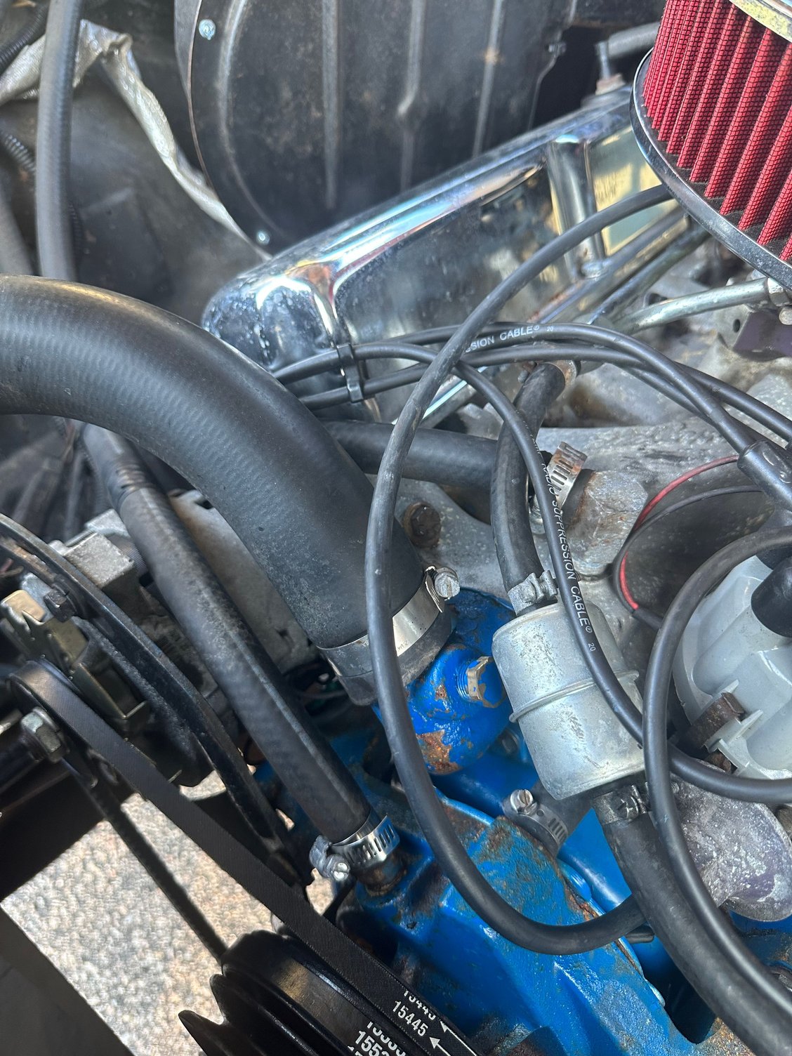

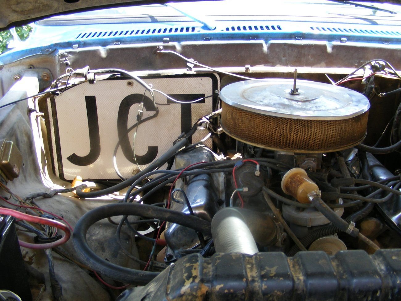

Vacuum lines on drivers side firewall

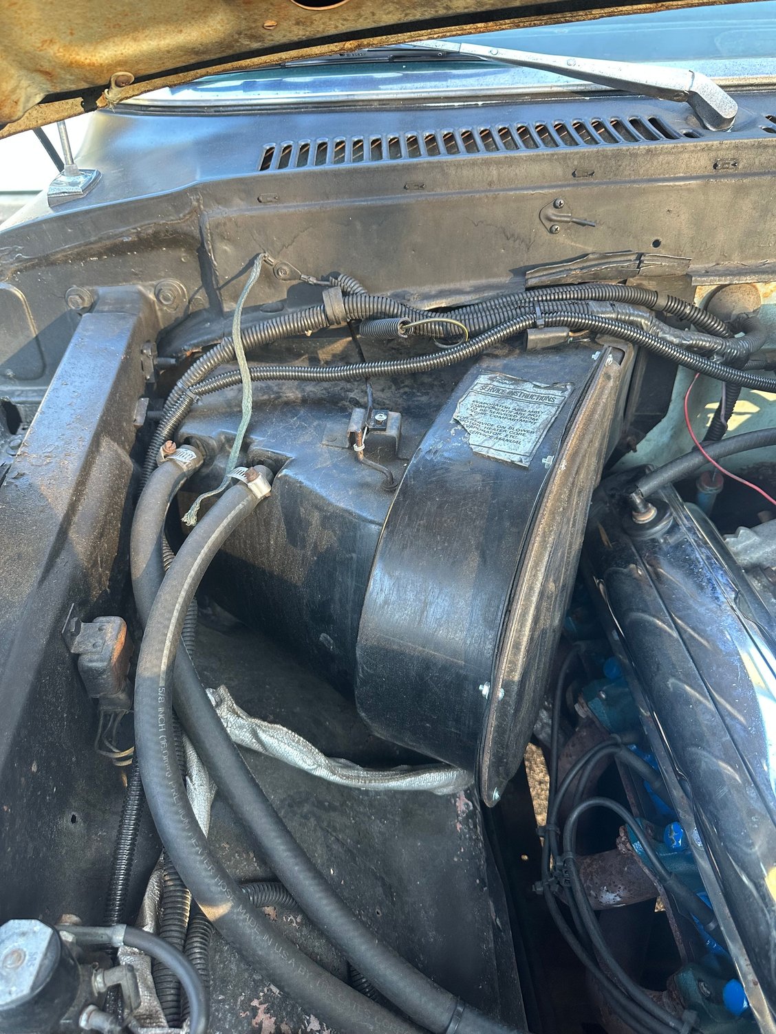

Blower motor/heater core box
Heater hose connections

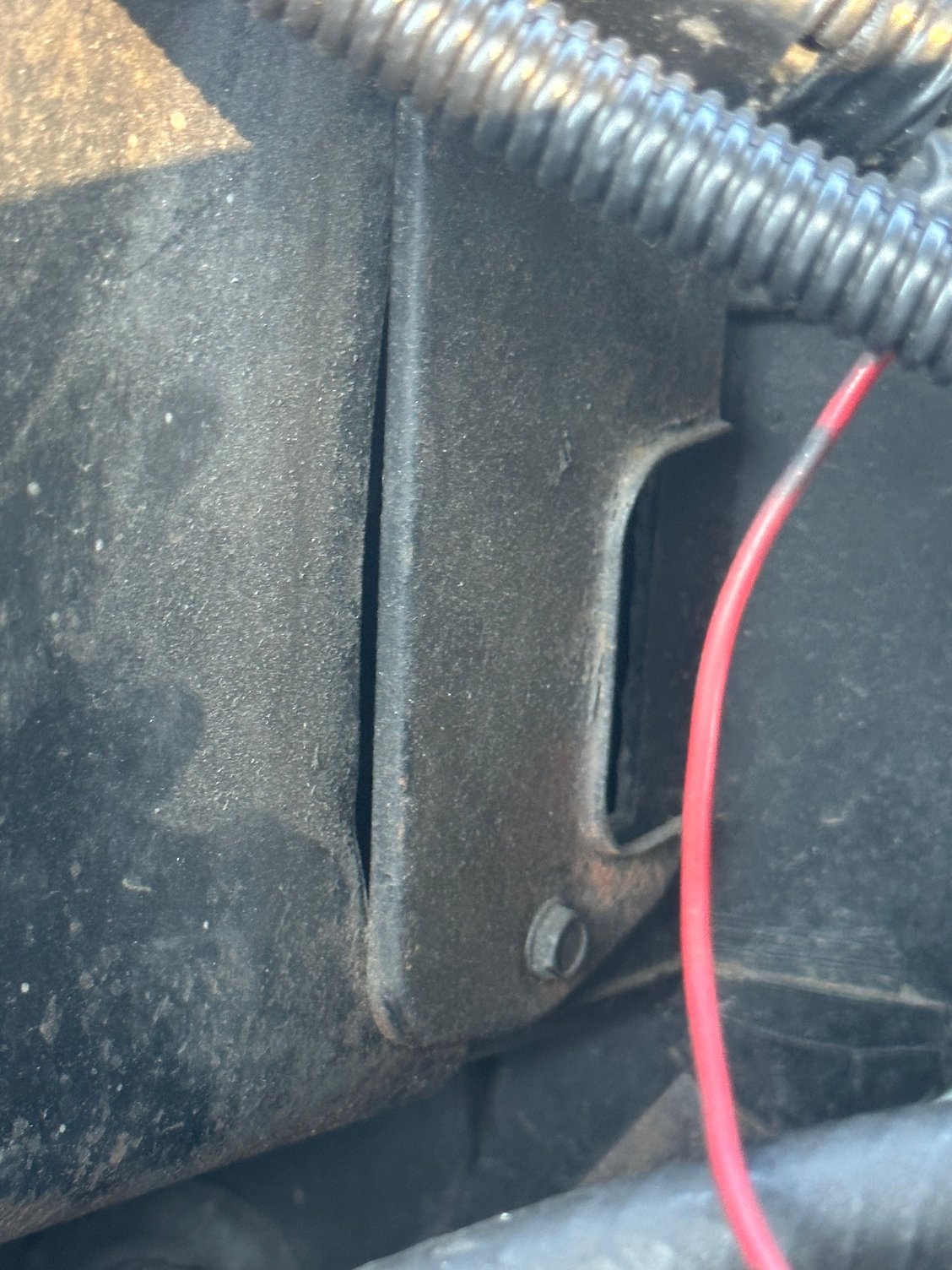

Looks like a hole here (just noticed this for photos)
Looking in glove box

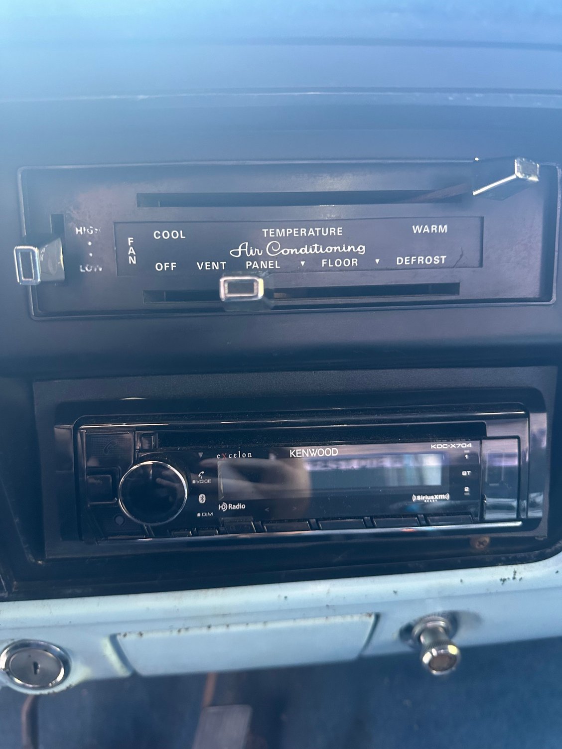

Climate controls
Front Grill/Radiator

Well, not seeing any of your pictures, let me ask ... is the heater valve in the heater hose hooked to a vacuum line from the AC controls in the cab or what? If hooked to the carburetor or intake, vacuum is shutting the valve and cutting off coolant flow to the heater core. If the AC is gone, they may have plugged the hose to the intake to intentionally shut off coolant flow to maybe get cooler vent air through the dash vents in the summer?

It looks like the heater valve has been omitted and I can confirm both hoses are hot when running. I didn't get a chance to test the theory today but I am wondering if the culprit is the hole left by what I think was the AC evap coil

The hole for the a/c evap is what I noticed. Could be part of the problem. Another thought is the fresh air vent on passenger side going through kick panel. Should be a vacuum control behind glove box.

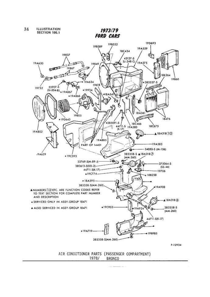

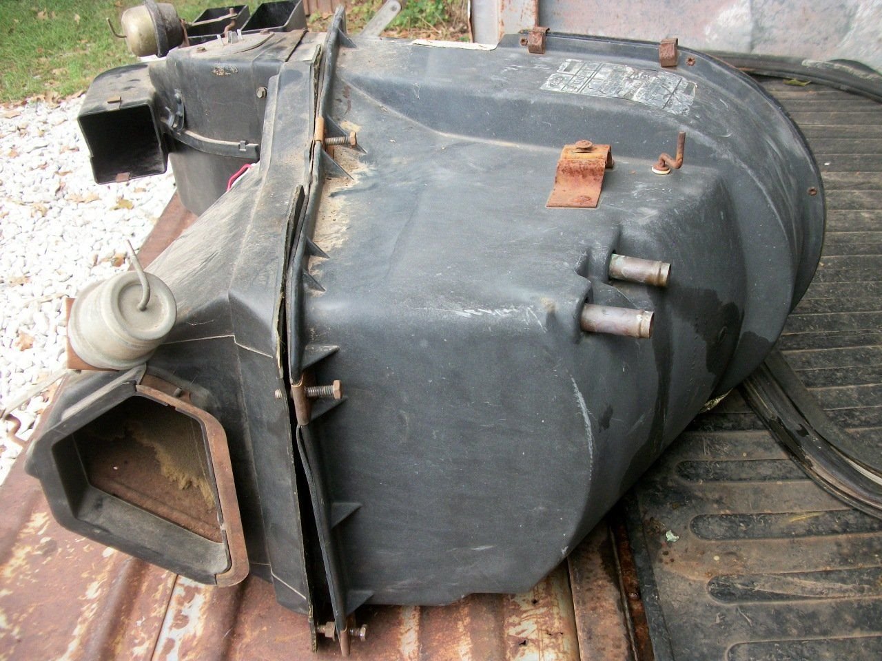

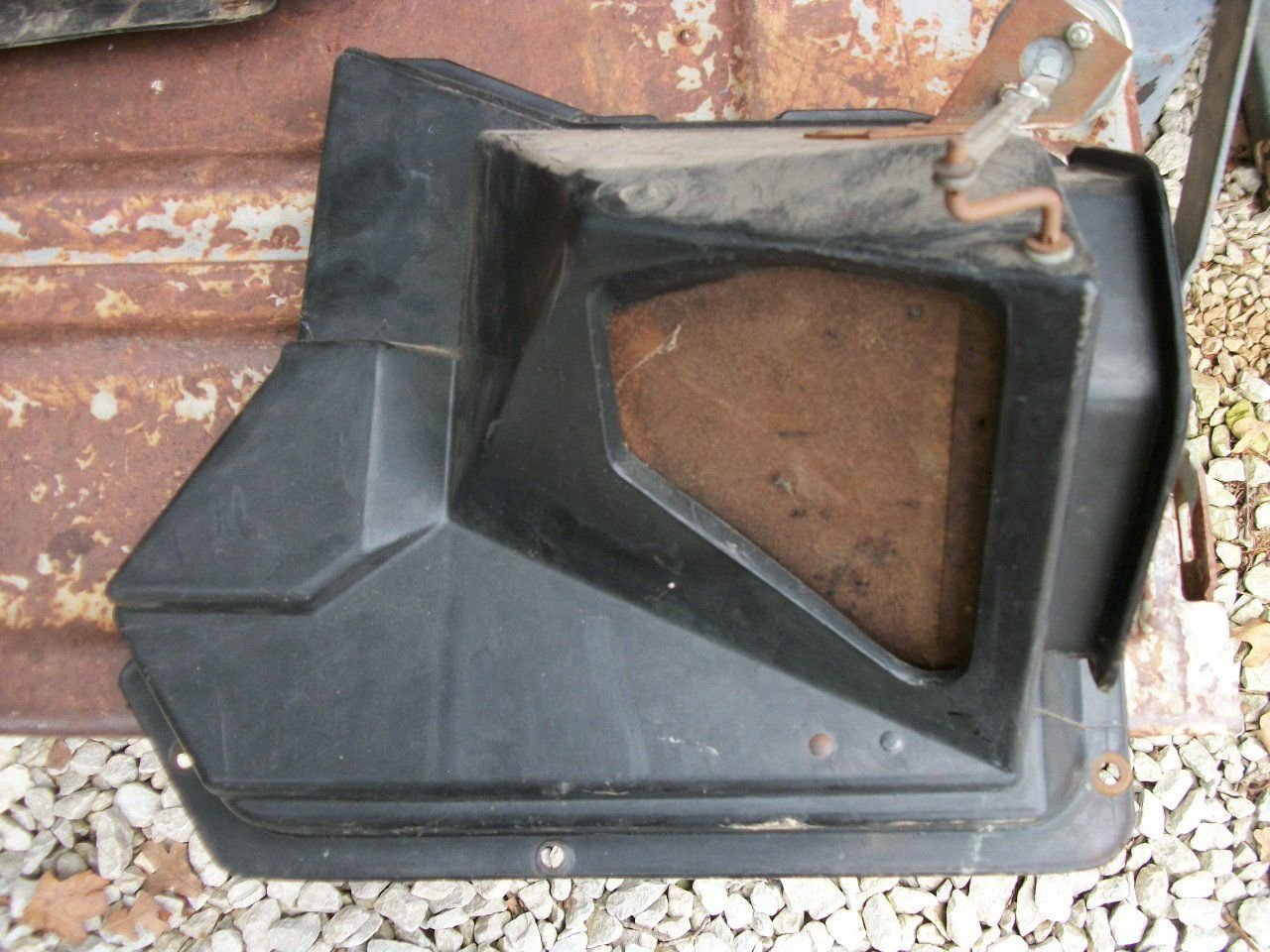

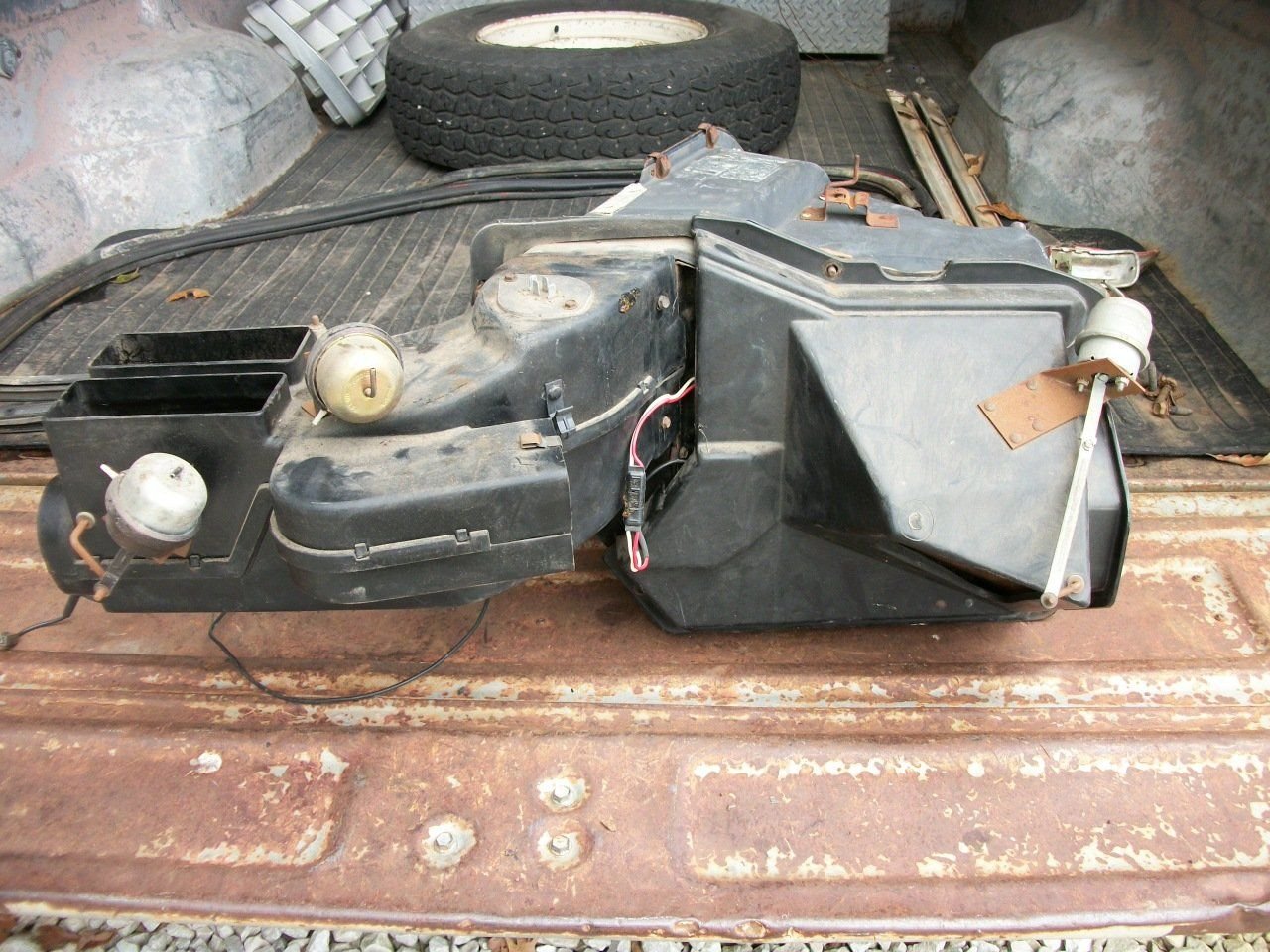

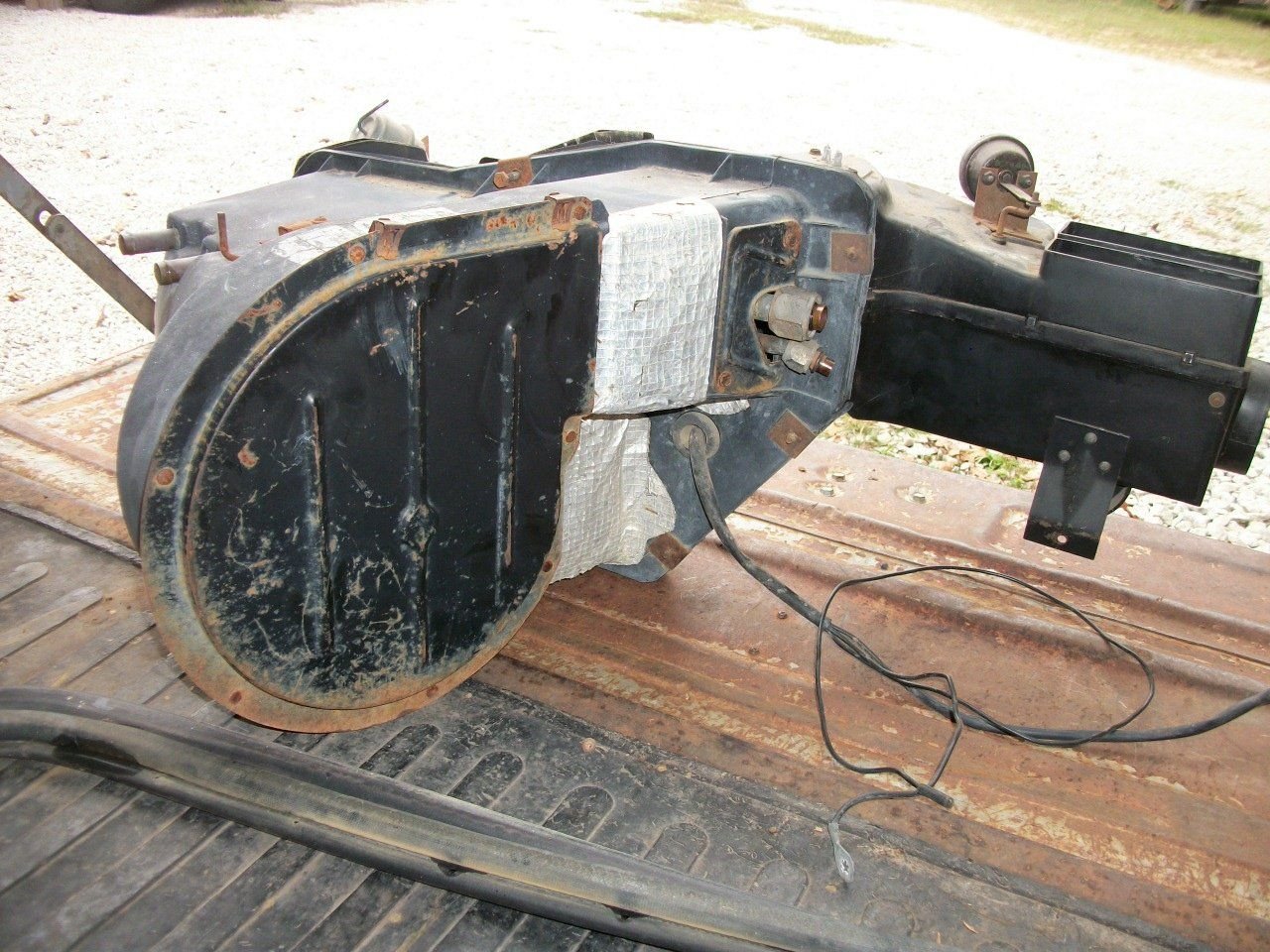

Look in the top left of this picture, the evaporator is in place but the tubes not sealed where they go into engine compartment. That's the hole that's open on your truck if the evaporator is gone. The tubes cross the rectangular tunnel coming from the heater motor to the interior. Below, sans evaporator. See how big of a cold hole you have then.
Here are some more pics, Thank 77&79F250 here, I think almost certain was he whom I robbed them from. I study them from time to time, good set to keep in a file. I put mine in a non AC truck after robbing two carcasses .... but it was in the '80s and I never thought to photograph the big box for future use.
Maybe they'll help you ... or someone else too.
And just some more while I'm here, charts for you.
