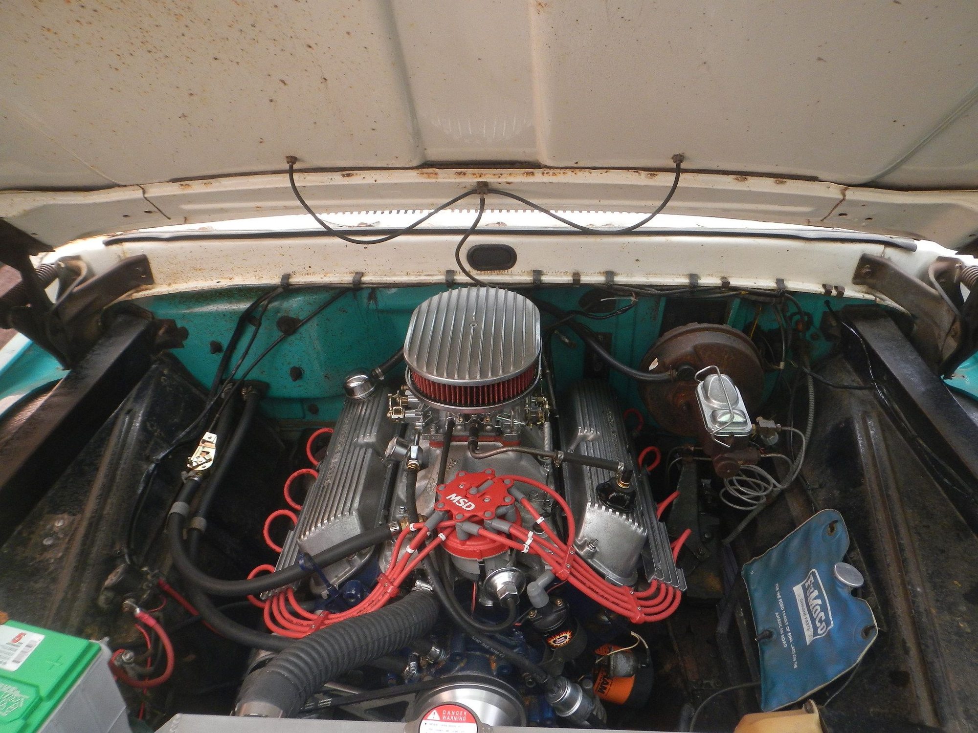

My 66 had a 351W swapped in place of the 352 without issues.
Sold it in 2018 and still miss it.

Very nice that's similar to what I was wanting to do with mine
