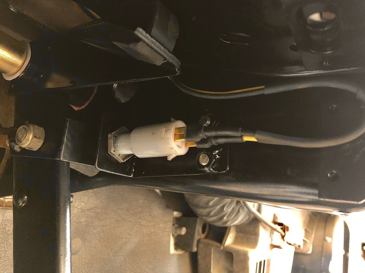

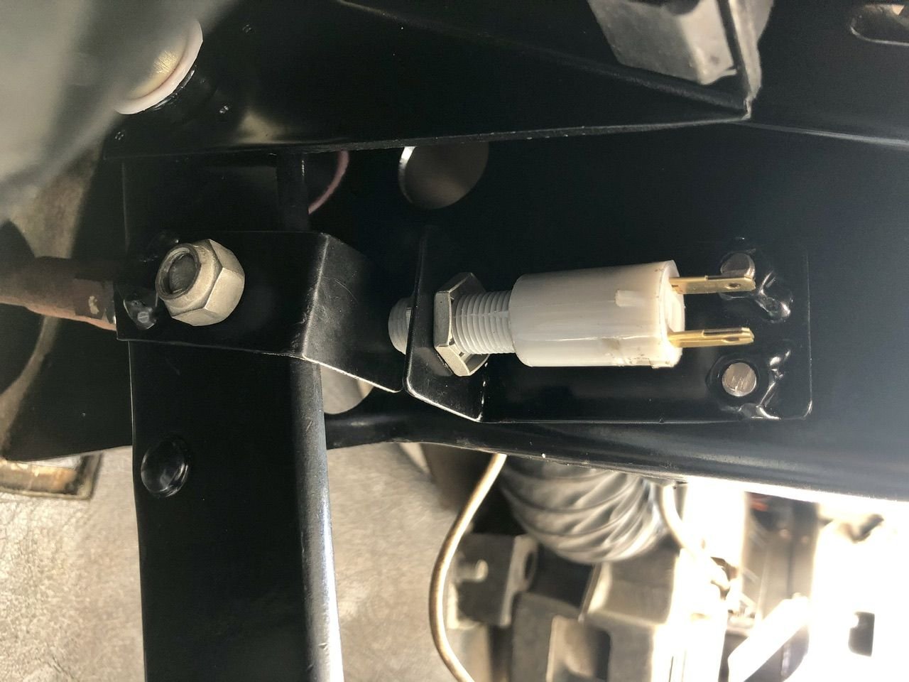

Run the wires thru the firewall and install a pedal activated electric brake light switch.
I added one on my 63 Uni.

@instig8r63, how did you wire that? That is very interesting.

I just ran the brake pressure switch wires through the wall, extended them and hooked them up to an electric brake light switch mounted to the pedal assembly.
