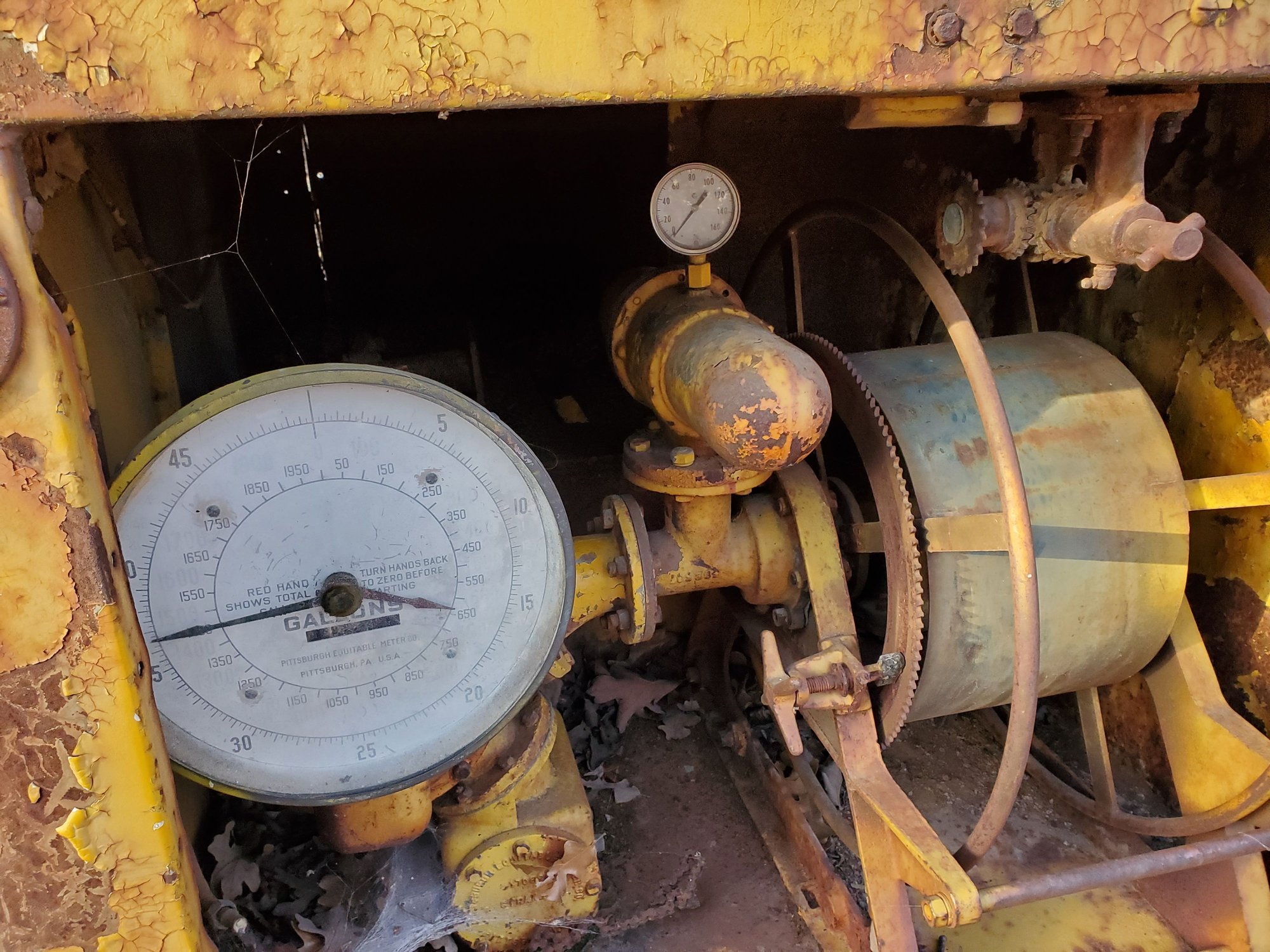

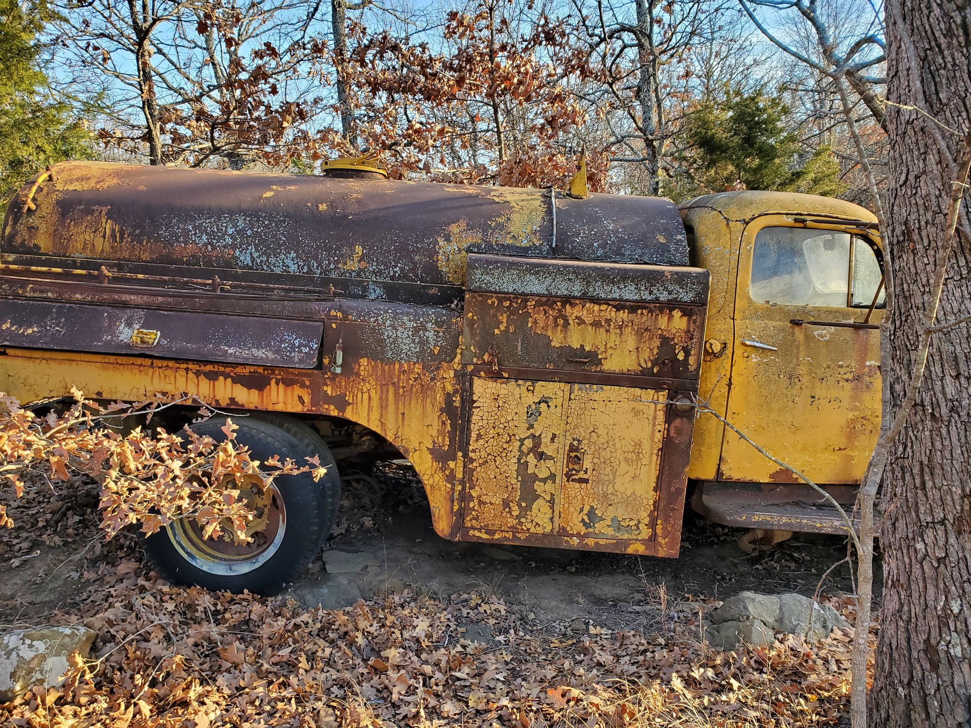

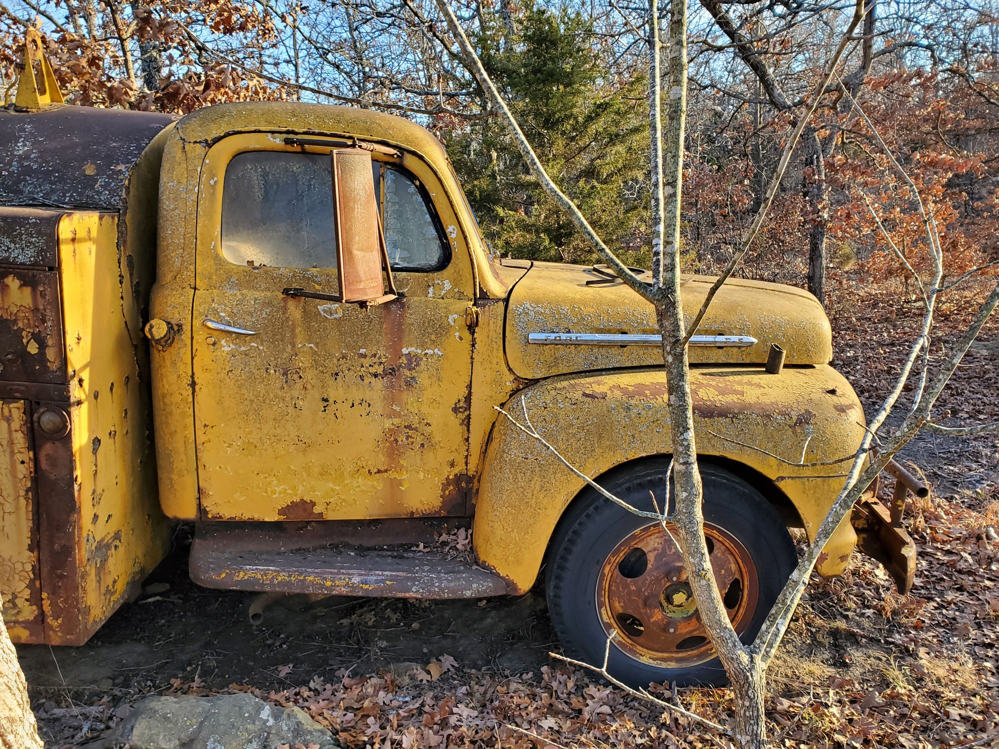

Fueler/oiler tanker
Thanks alot,
Yes it will spin at the fanblade, even has oil in it! I believe I will sell as is. Thanks again for all your input.
More pics for the curious.
Lance.

That's a cool rig, actually. Old tanker...little rough but "different". After looking at it, I would definitely recommend you sell it "as is" if you don't plan on building it for yourself.

Where is Stu? Are those widowmaker wheels or is he good to go there?
